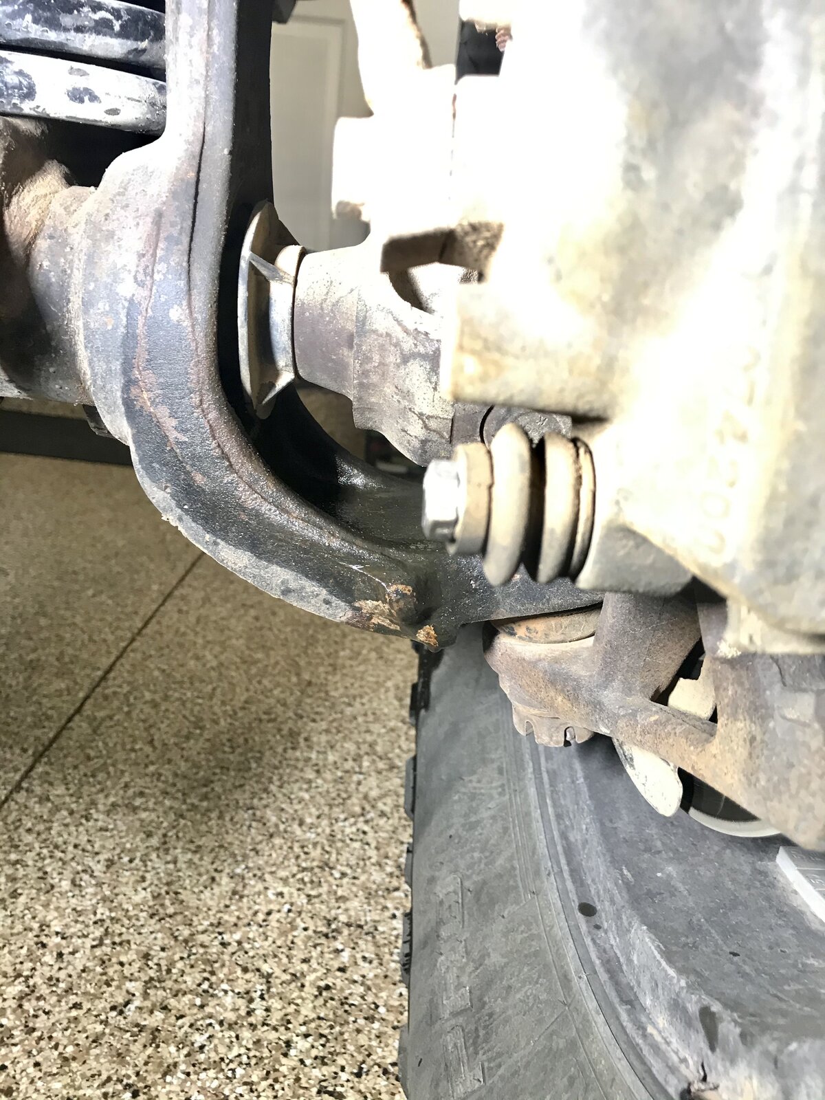

Might lose the diff if you run out of fluid. Top it off before you leave town and check the level every so often. If the leak isn't leaving a puddle, there really isn't much to be concerned about.
It’s leaving a puddle. Got about a silver dollar sized puddle on the driveway in 2 hours, prior to which no leak at all.

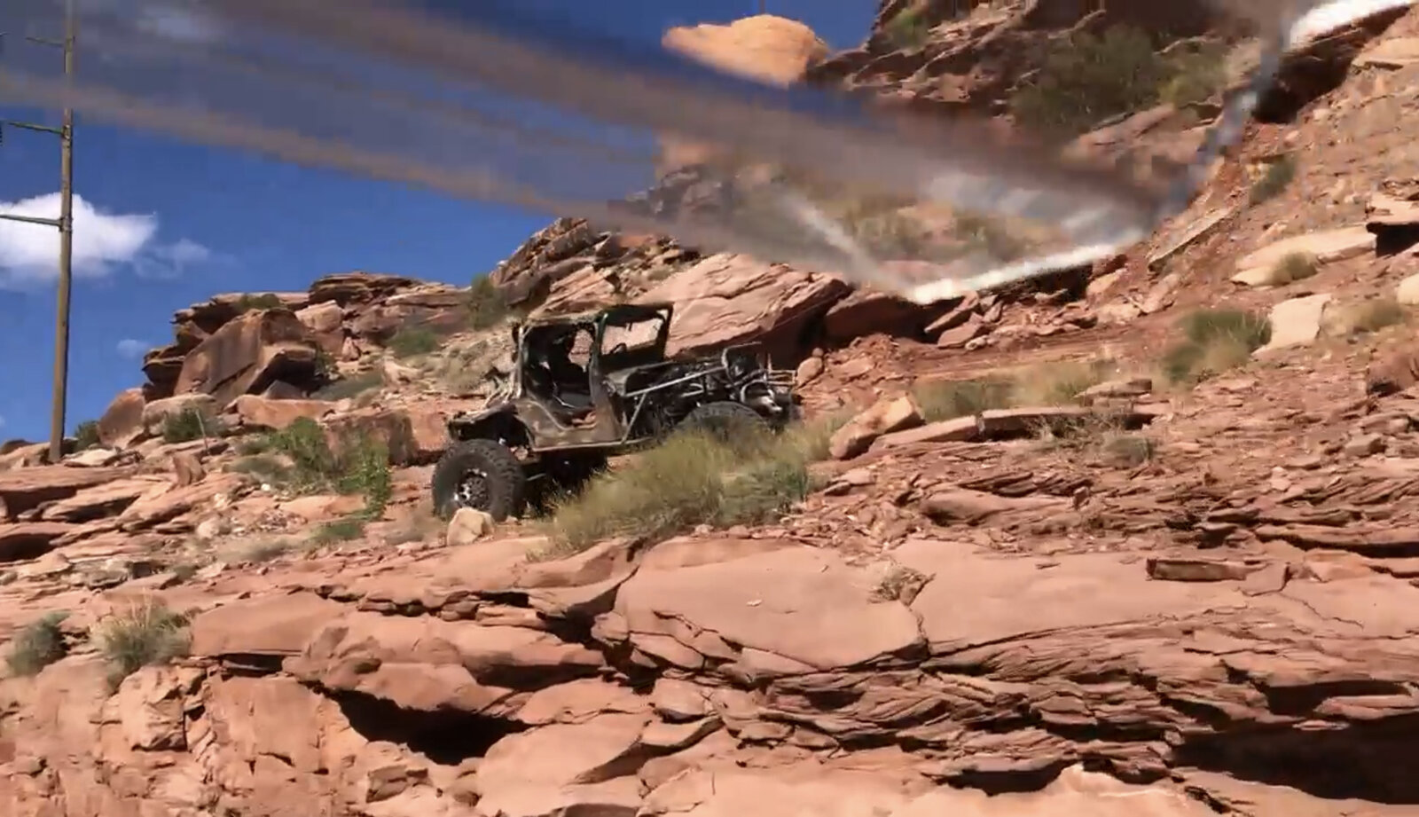

Grabbed from the video. Looks like the Jeep was a ways from were the people were.
Possible mechanical issue.
Failure looks to have occurred just above, or while descending Devil's Crack strangely landing upright. Looks like they were ejected. Another very dangerous area is coming off (descending) the lowest step on the Z turn. Having newly installed ARBs but not knowing about disconnecting, I nearly cashed it in right there in my XJ back in '04 after arriving from Hole in the Rock just past mid day. I approached the step perpendicular which ends up placing the left (down hill) tire first. Right rear rose 5 feet, teeter tottering just about to roll over. Passenger in a new Rubi behind me jumped out to catch me. I locked the axles, backed up, then reapproached the step with the uphill (right tire) stepping off first. (I scoff at those who after spending 50 grand on a Sahara say front and rear lockers are superfluous frills) What's weird is the correct approach to that step tips your passenger outward a little toward the cliff as you then place the left (down hill) tire off the step, keeping front level (right to left) in relation to the downhill route as you're also turning into the down hill camber of the trail. If you do this like I first did it and the roll momentum is enough to go over and off the trail, you won't stop until the ledge 150 feet below catches you just above the telephone poles. The approach to the Z turn is much steeper than it seems when ascending. I've done the Rim 4 times after that, descending once at night. Disconnect when you arrive at Moab; reconnect when you leave. Jks and JLs merely push a button.....hardly any sport in that.
