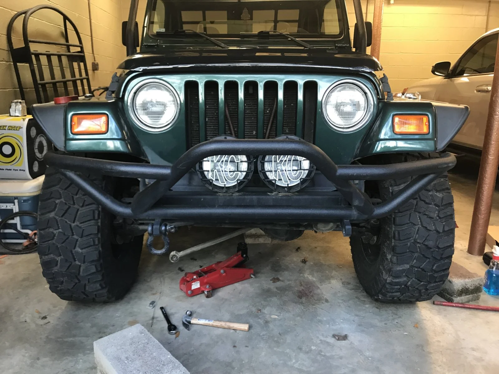

First post here....I have a 2001 Wrangler, it has a 3.25" RC lift kit installed. I just recently noticed that my jeep is leaning towards the passenger side slightly, about .5-.75". I replaced both front coil springs already and the lean is still present. When I measure the spring length (installed), the driver side measures 14.5" and the passenger side measures 14". I have swapped the front shocks to see if that might be playing into the lean and nothing changed. I disconnected the sway bars, and it seemed to exaggerate the issue. I disconnected the front track bar (OEM) to see if could be pulling the passenger side down, but noticed in the process that when the previous owner had the lift kit installed that they just drilled a new bolt hole to shift the track bar over to account for the lift. Disconnecting the front track bar did not have any affect either way.
I have read numerous posts on this issue and I don't want to simply put band-aid on the issue and install a spacer on the passenger side to offset the lean. I can't think of anything else that would be causing this...any help would be appreciated. I can post pictures if needed...

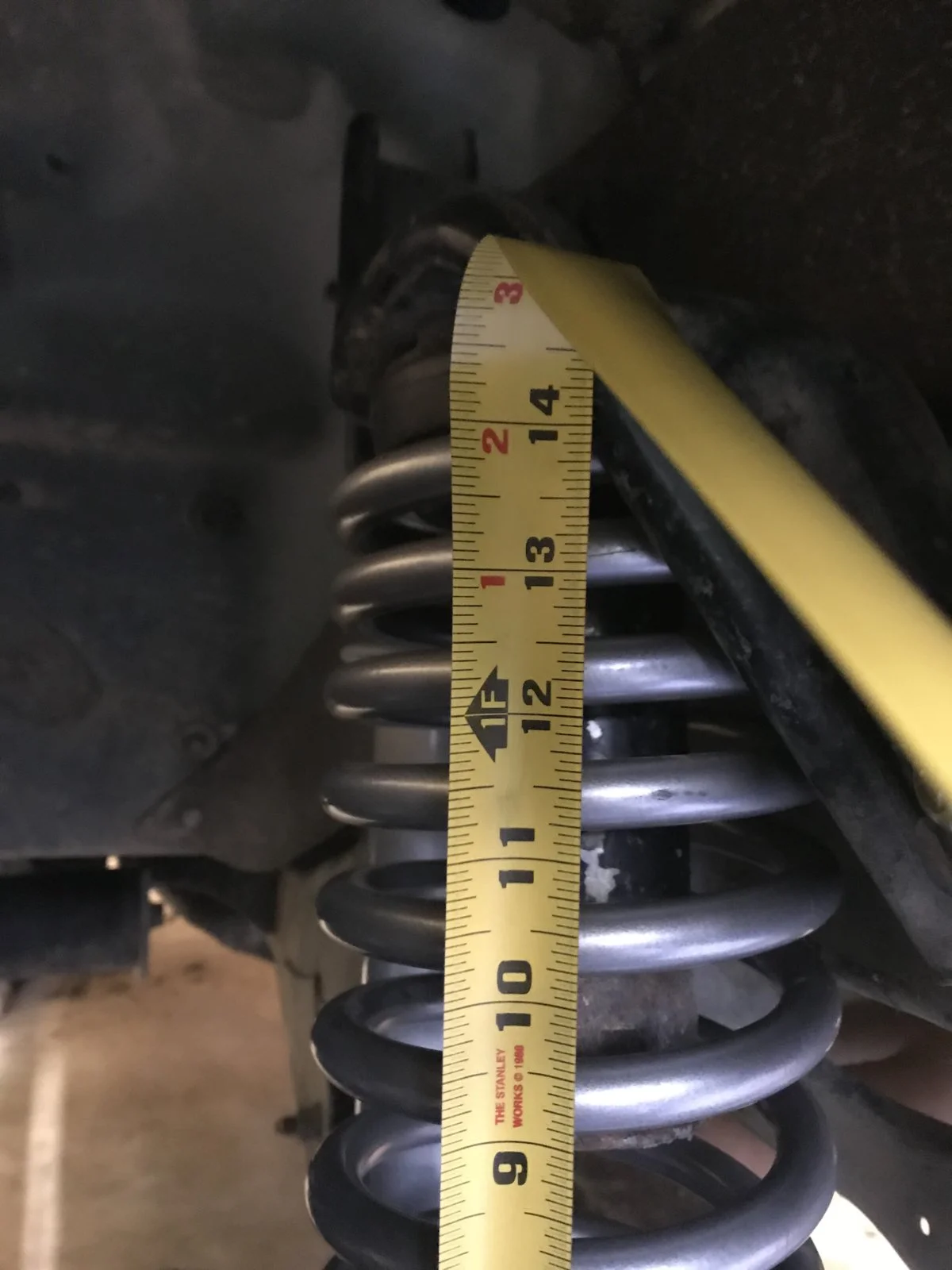

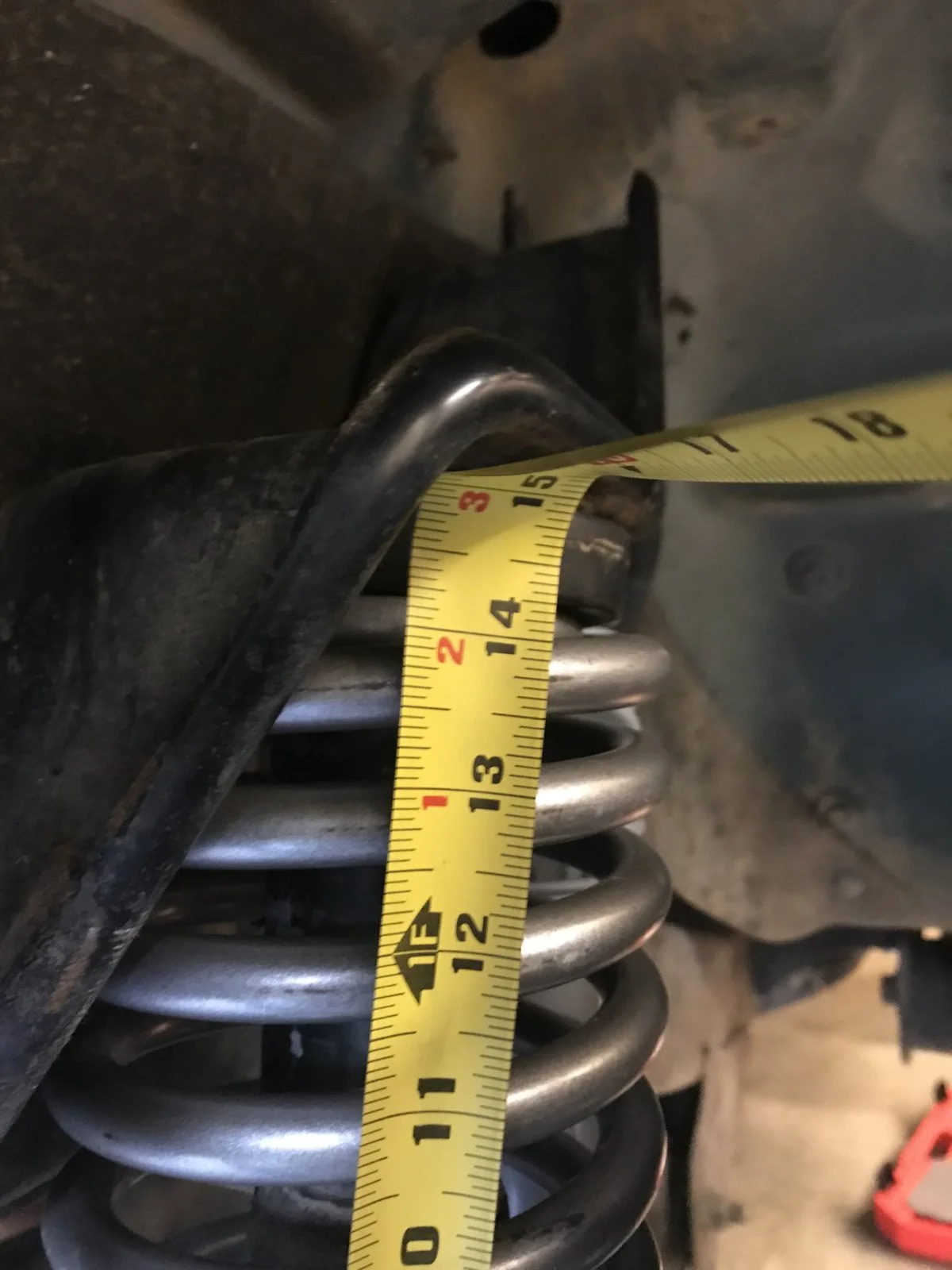

My R-R spring measures approx. 10-1/8" and my R-L spring measures approx. 10-3/8"....so about 1/4" different in the rear which is hardly noticeable. The front is what drives me crazy.
The second picture is the F-R spring and the third picture is the F-L spring.
