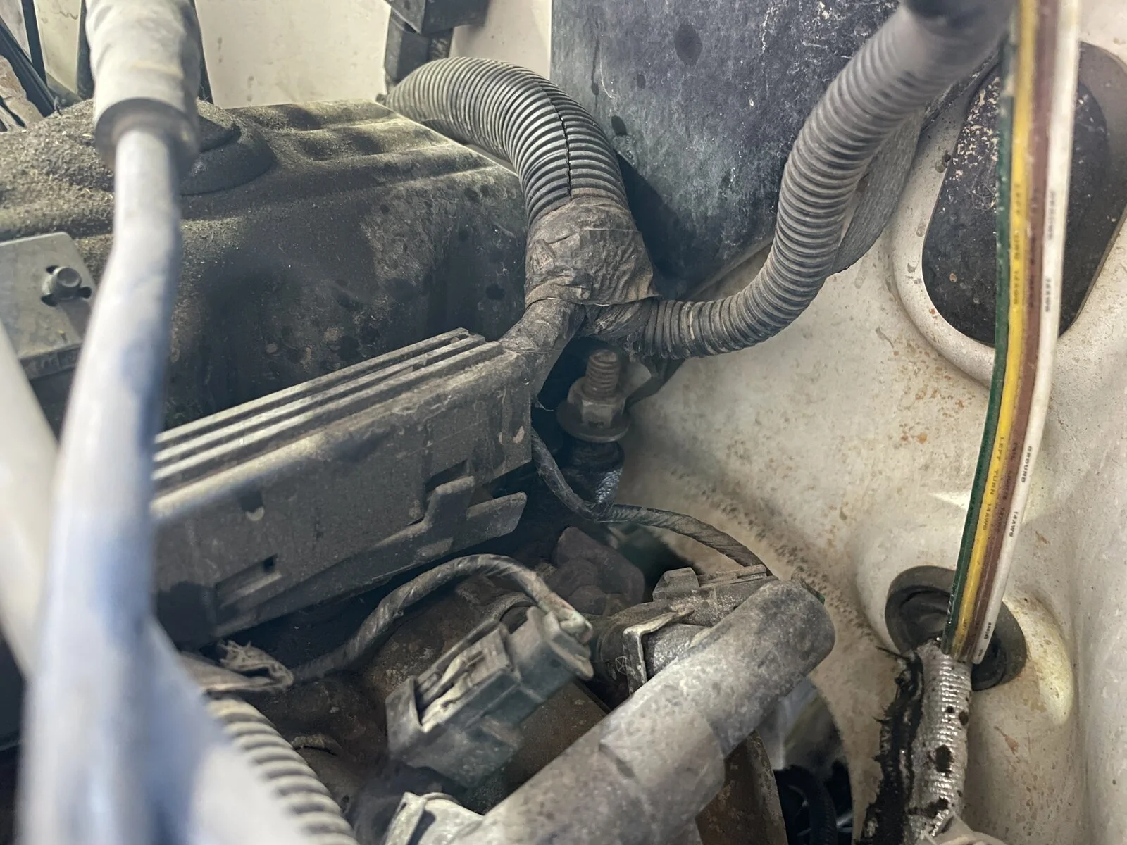

Curiosity got the best of me. Went and did a quick visual and I can't see anything wrong. I will need to wait till to tear into it a bit more when I haven't been up all night working. LOL I took a few pics to share. :D
This one shows the big clump of wires incased in that plastic wire cover. All looks good on it.
This next one is from the other side, I am thinking this is the bolt you mentioned @Jerry Bransford ? It all looks good there too.
This last pic is of the plastic cover that protects all the wires. How do I get that apart?

This next one is from the other side, I am thinking this is the bolt you mentioned @Jerry Bransford ? It all looks good there too. View attachment 292334
Cut the tape that is holding it together. Wrap it back together with black electrical tape once you're done.

Yah, I'm going to cut the tape off the parts that are taped, but I need to figure out how to get the plastic bar looking thing that is in the last pic. Looking at the pic again, it looks like I can put a screwdriver in the hole and push that tab. I will give it a shot once I am more awake. LOL
