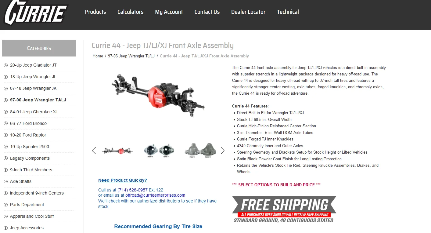

Does anyone know of a company making upgraded knuckles for a TJ? I just installed a Currie HP 44 into my 97 TJ and I am having a hard time finding anything other than OEM. I contacted Reid racing and they do not make a direct bolt in for the TJ, any ideas would be super helpful, thanks in advance!

It is a Currie differential so the inner C’s are already upgraded. I am going to be installing ball joint eliminators to take care of that problem and also upgrading to RCV axle shafts. I want to upgrade the outer knuckles so that my only weak spot will be the drive lines and u-joints and I don’t mind fixing those on the trail. My TJ is off road use only and never see’s the pavement.

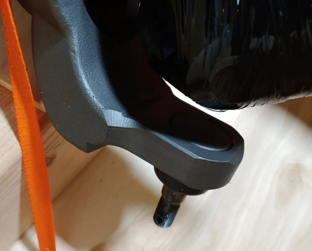

"It is a Currie differential so the inner C’s are already upgraded."
Are they, how so? I've never got a clear answer on that with the Currie 44s. Can you post a pic of the upper ball joint area of the inner C? It's more the ball joint seat itself that becomes an issue with the stock inner Cs
Seems to be....
They are larger but they have to machine so much material away for the lower to work it makes you wonder if it is really that much better. I suspect it is some better, just not as much as we'd like it to be.
