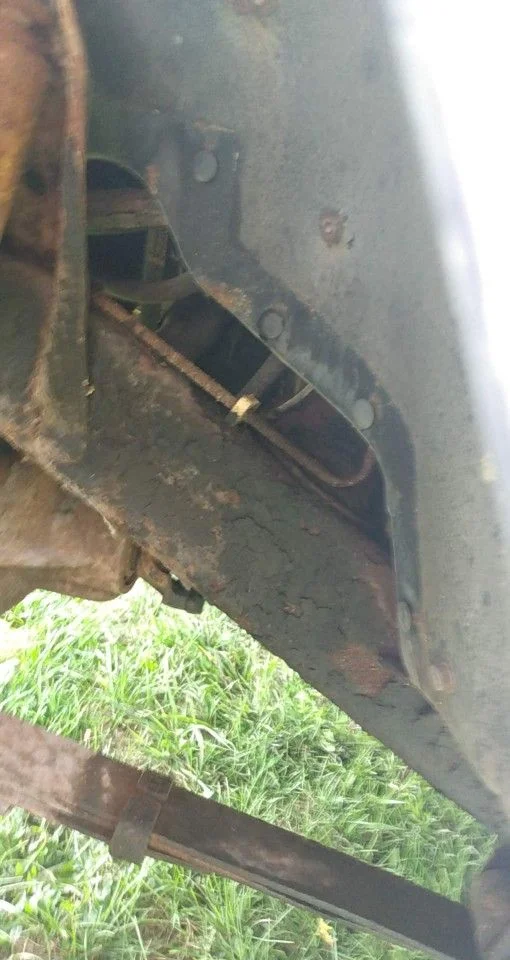

New to the forum, I've never owned a Jeep before so was hoping you guys could give me some insight. I'm looking at a 1993 TJ right now, 150k miles, runs and drives great, body is solid. Has some rust on the frame though. Asking price is $2800 but I'm pretty sure I could talk them down to $2000. Worth it?

That is a YJ. Leaf springs. Just so you know…
TJs are 1997-2006, round headlights and coil springs…

Break the project into parts. 1) tub, 2) frame, 3) suspension. Descale everything at each stage, de-grease, rust converter, topcoat, clear coat actually helps a lot. Don’t cut corners. Get all the scale off. Prep is everything.
Inside the frame will be a PITA. A day for sure. You have to get all the loose rust off. We are using a tool on the end of a drill to bear it all up. It’s 24” long. Eastwoods Rust Converter. Top coat. Suspension last. Done. Lovely. Great project. Lot of work.

We need pics of different areas to make any real determination. If a yj frame is going to be rusty it's above the transmission skid plate or at the very end of the frame. You really need to look inside the frame as well.
