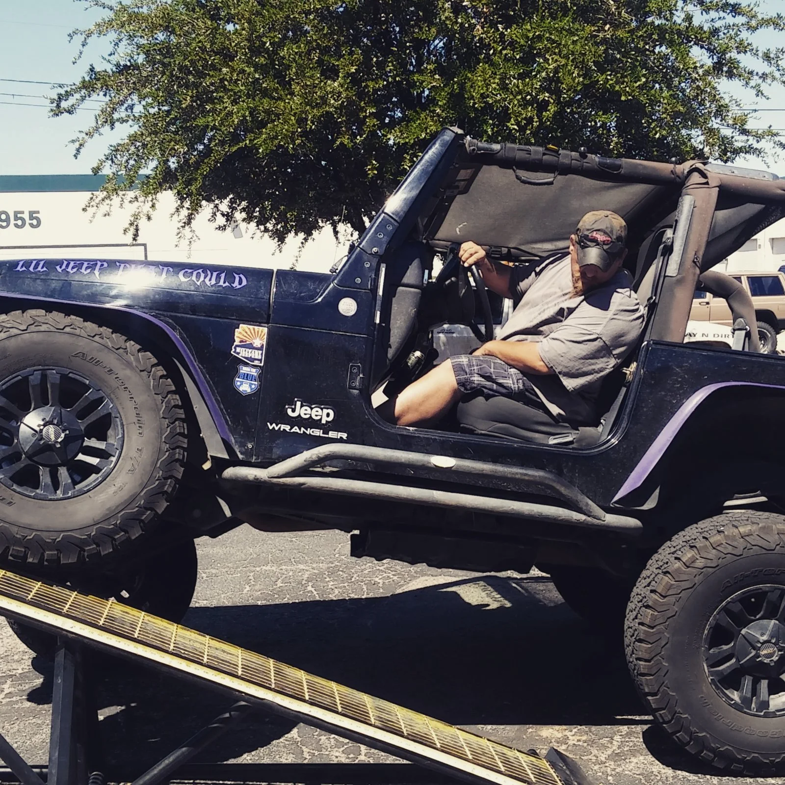

I have a 2.4l se tj love it. It may not pull hills well on highway but it is a beast on the trail. I have the factory 3.73 gears on 33s and a 3 inch lift. Its the little jeep that could.
