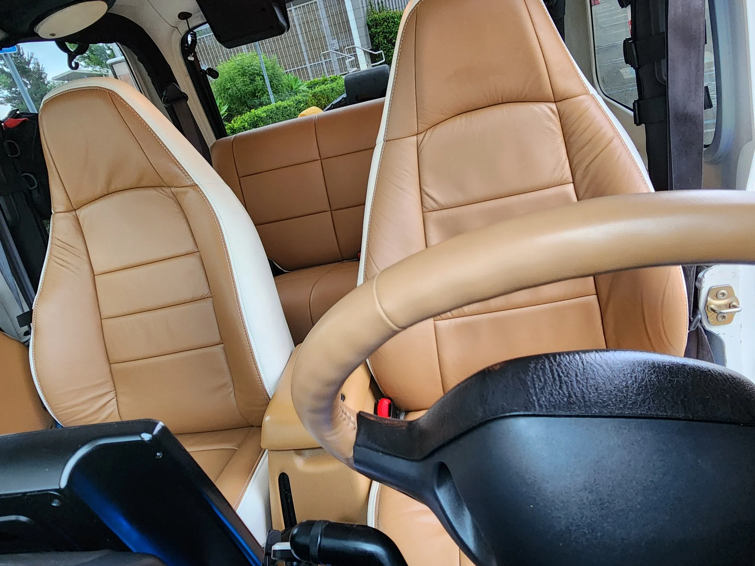

Sorry for the delay. Finally got some time. The front seats go in with just an adapter plate I made out of a 16x18 piece of steel. You do have to cannibalize the fold and tilt so there is no going back when you start but they function just like from the factory using the factory lever on the side of the seat to tumble them. If you wanted to eliminate the fold and tilt and use a fixed base it would take you less than an hour to have them in your jeep.
Like I mentioned the rear seat was a bit more involved but the seat is unmodified and full width from a 2017 jk. All it takes in a 1" body lift which I had anyway for a tummy tuck, and to cut out about 1.5" of wheel well and weld in a filler piece. You can just barely make out the widening nect to the floor brackets. Final piece was taking the stock seat bracken and move the rear pin back 3/8" They also fully fold and tumble as shown with factory lever.
Over all I love the front seats and I feel my girls are much safer in the back seat with a full height seat and head rest. Definitely worth it to me.
Do the JK front seats sit higher than stock? I know that most of the aftermarket seats sit higher and that can be a problem.
I made my adapter brackets as flot and short as possible. IF they raised it at all it is no more that 1/4" I am 6'5" and have no problems at all. Sitting up straight my head is short of the roll bar by about an inch.
