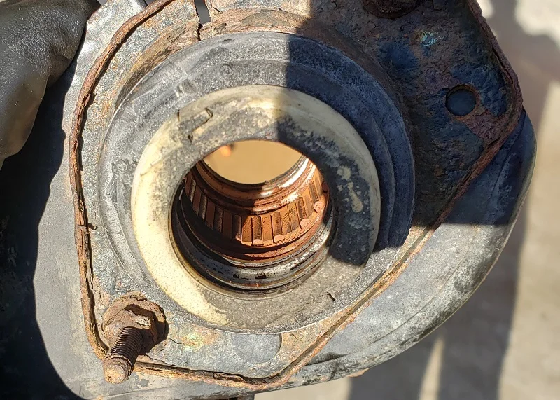

I've pulled two of these apart at 200K+. I put both back into service with a simple cleaning and greasing. No excessive play or noise!

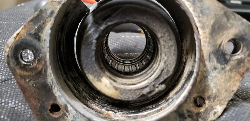

Good job.
I bet you could drill a relief in the plastic and grease these with a needle Zerk grease gun tip.
I hadn't thought about this, but there is real estate to make this happen!
The only thing I wonder about is the thickness of the metal for a zerk fitting.

With a needle zerk end you don't need a fitting , just hole to get the grease to the bearings . Those ends are about 4" long and 1/8" diameter.

Even being able to shoot some spray grease would be better than letting them run dry.
This is a good example of a bearing that doesn't need to see a pressure washer , never gets serviced, and man they will give you grief if they fail.
A high side and low side port in the nylon, even with a plug , could go along way.
Someone may say ,"won't you lose the grease? " Sure, a little, but you eventually do any way. At least you can add some.
On our work trailer tongue Jack's we drill a hole and shoot spray lube in
On my tile shower drains we drill more weep holes.
Many things can be made to perform better with little effort.

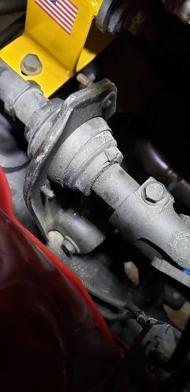

I accidently bought a lower shaft for a 97-02 TJ to replace my lower shaft on my 03, but I was able to make it work. As you said, the lower end section is about 2 inches too short where it meets the gearbox.
The end that goes into the gearbox is held in the shaft by a metal pin with a rubber bushing. I hammered out the pin and worked out the end piece of my old shaft. Did the same with my new shaft and swapped the longer piece into the new shaft. Replaced the pin and bushing as well and worked beautifully. If you have the time and patience, you can use the cheaper 97-02 lower shaft with this modification.

Get the Mopar complete assembly , grease the needle bearing well and be careful with how you reassemble as far as the slip fit joint ..keep the old one as a reference.
It really made mine steer quieter.
Does anyone have a part# for just the needle bearing? Seems like it should be easy to replace - it came out easily enough.
