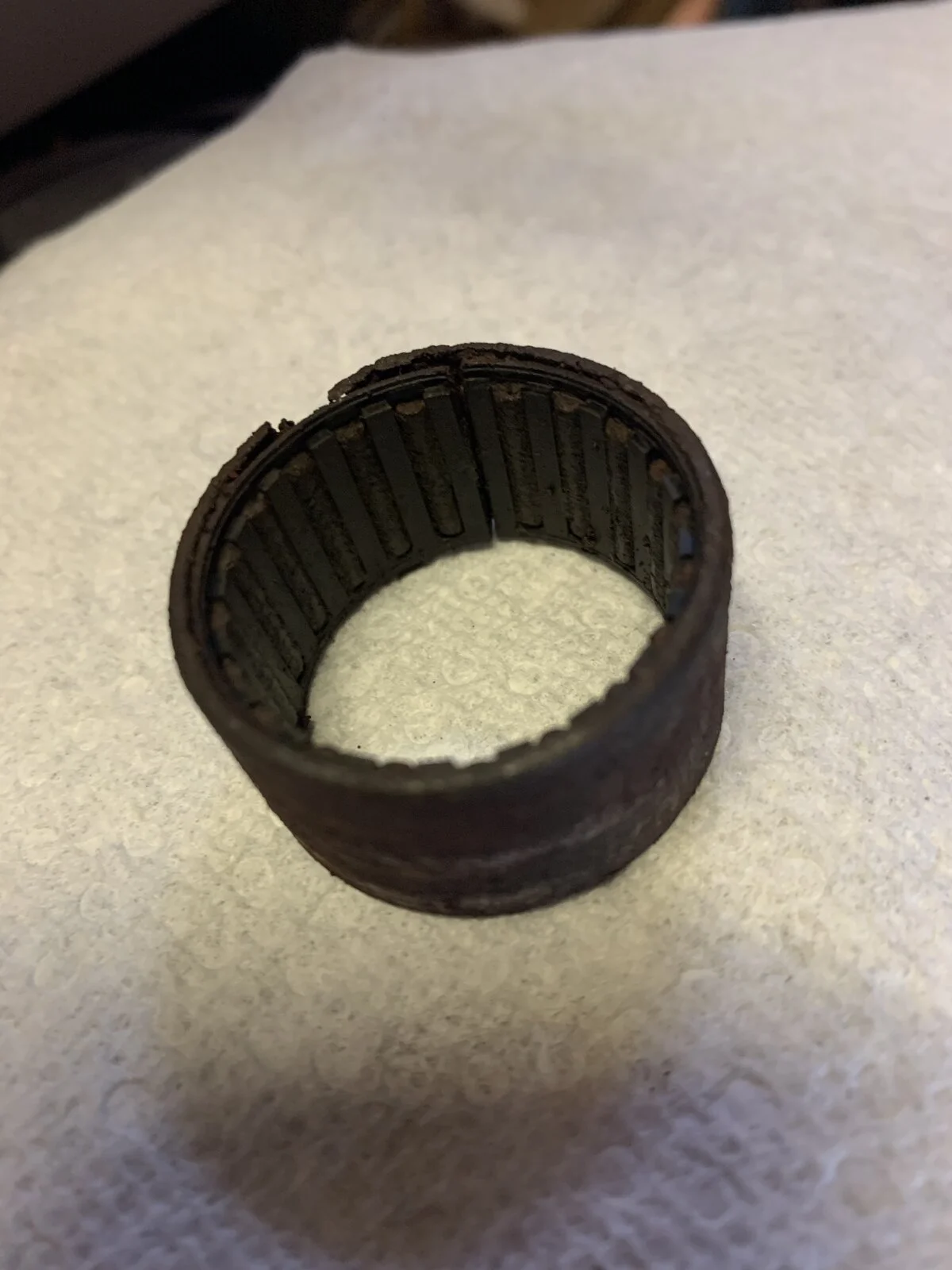

Does anyone have a part# for just the needle bearing? Seems like it should be easy to replace - it came out easily enough.
To my knowledge, the only way to get that is get one from a Liberty- they actually distunguish it in that assembly, but not in the TJ parts diagrams.

Just for clarity, looking for this part

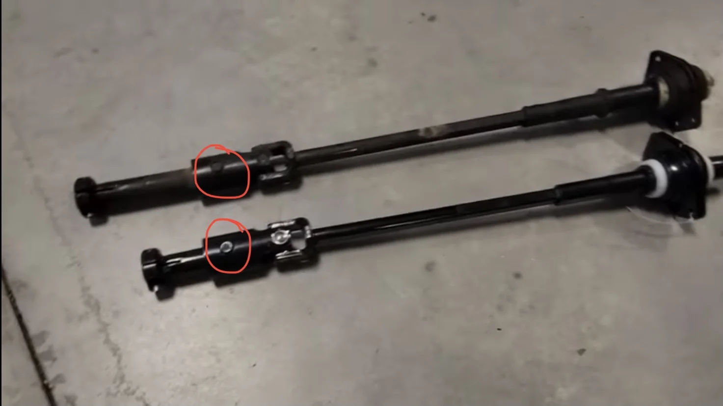

To all future people who stumble across this thread or for anyone else looking to save a little money on the lower shaft, you can buy the pre 02 shaft and knock out the roll pin in the pic and swap the lower portion over. (The top shaft in the pic is the OEM 03-06. The lower is the 97-02.) they are the same on the bearing side despite the bearing/bushing not in the same place in the pic.

2 potential bearings on order from Kaman. If neither of those works I’ll try the one above. Part# upon success. Extreme terrain product back ordered. Kaman order supposedly showing up on Friday.

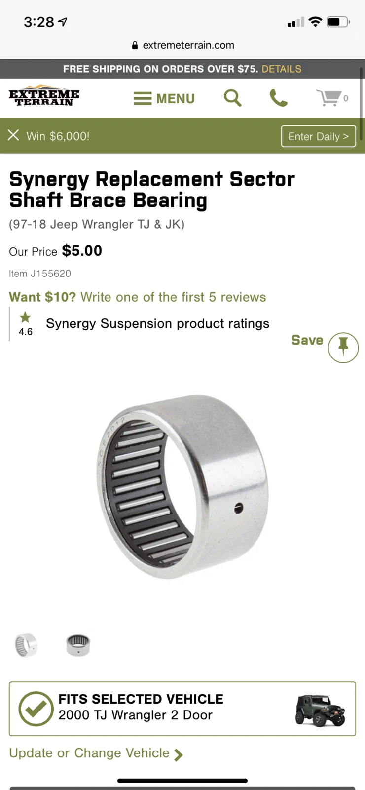

Keep us posted, quadratec shows the ET product being a different fitment
Saw that. Sweet little ole counter lady at Kaman was unhappy she couldn’t find the exact fit, but then again, my sample was badly rusted and cracked. Hopefully of of the 2 will fit. Do we have any real dimensions to work with?

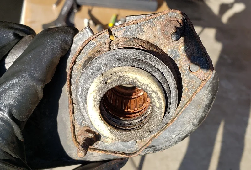

I've made it standard practice to pull the pillow block, clean, and grease it. Everyone I've pulled apart looks like this, or worse.
Can get you a shaft collar Dimension that will tell you if her inside dimension is good-be this pm

The shaft collar , where the bearing rides is about 1.191” on my take off with 20,000 miles- the collar was good, pressure washing blew grease out of the bearing - they wheeled in mud a lot.
