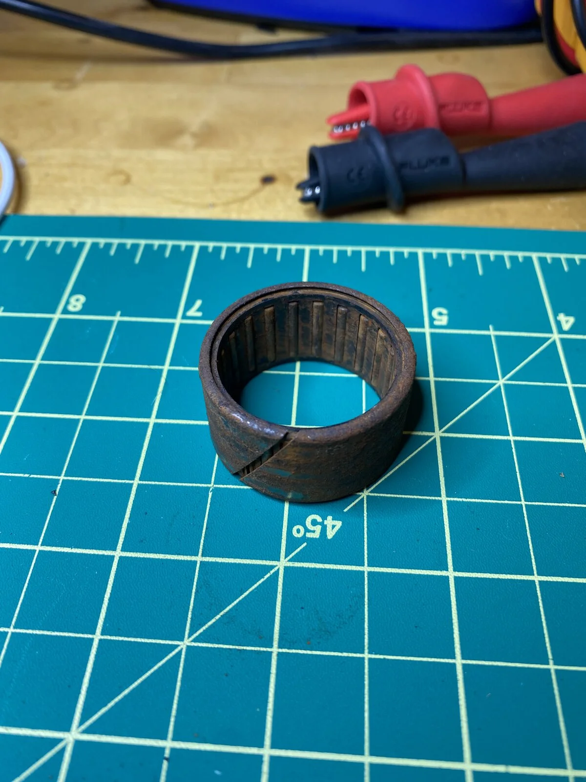

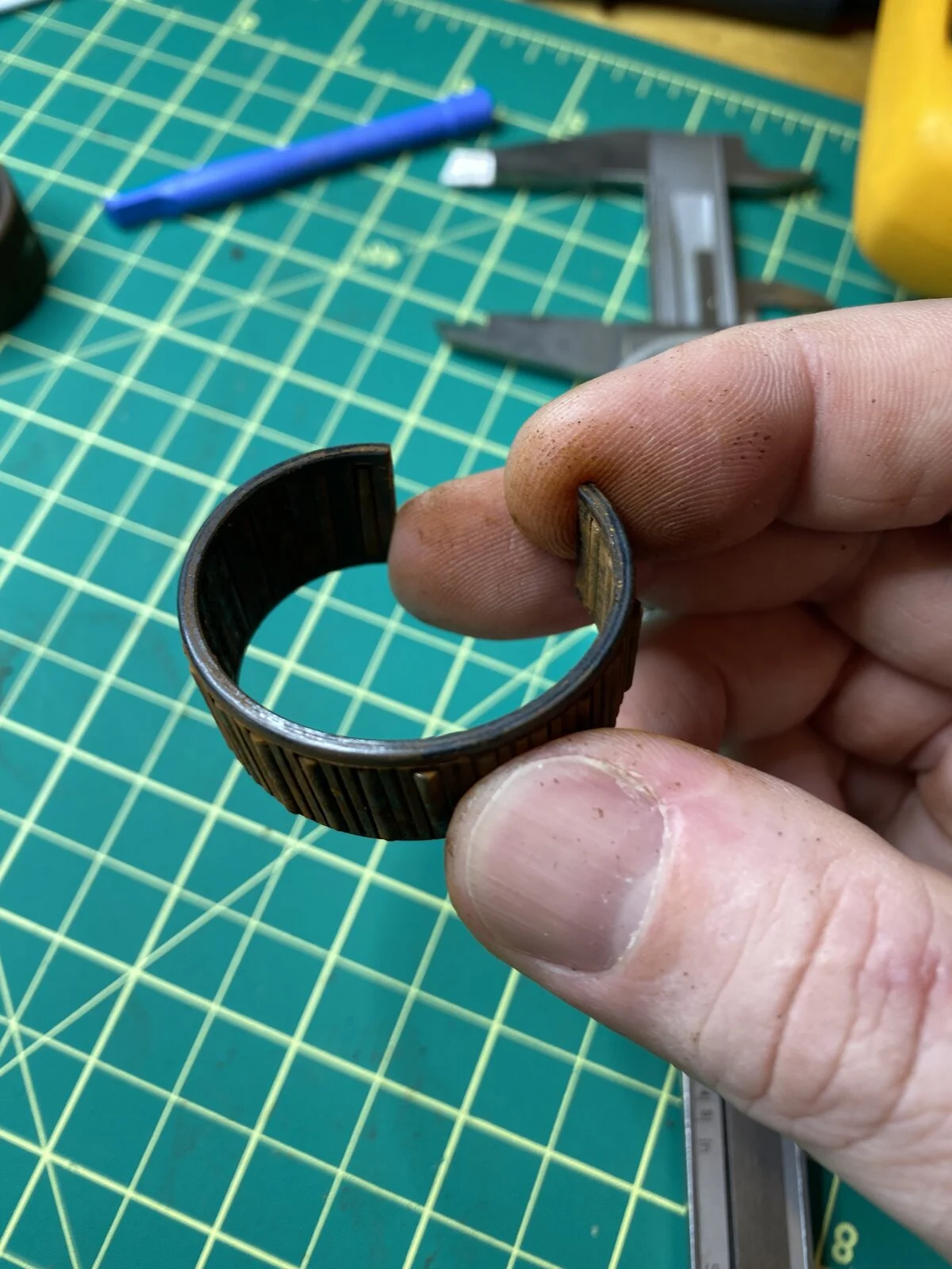

Here are some measurements and what I have learned.

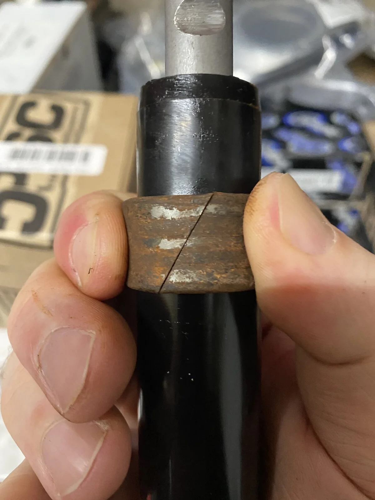

As someone mentioned earlier both the bearing race and cage are split. I don't think this is meant to allow the bearing to wear in, since it is already completely tight fitting on a brand new shaft.
Bearing cage is made of plastic and is easy to pop out of the race.

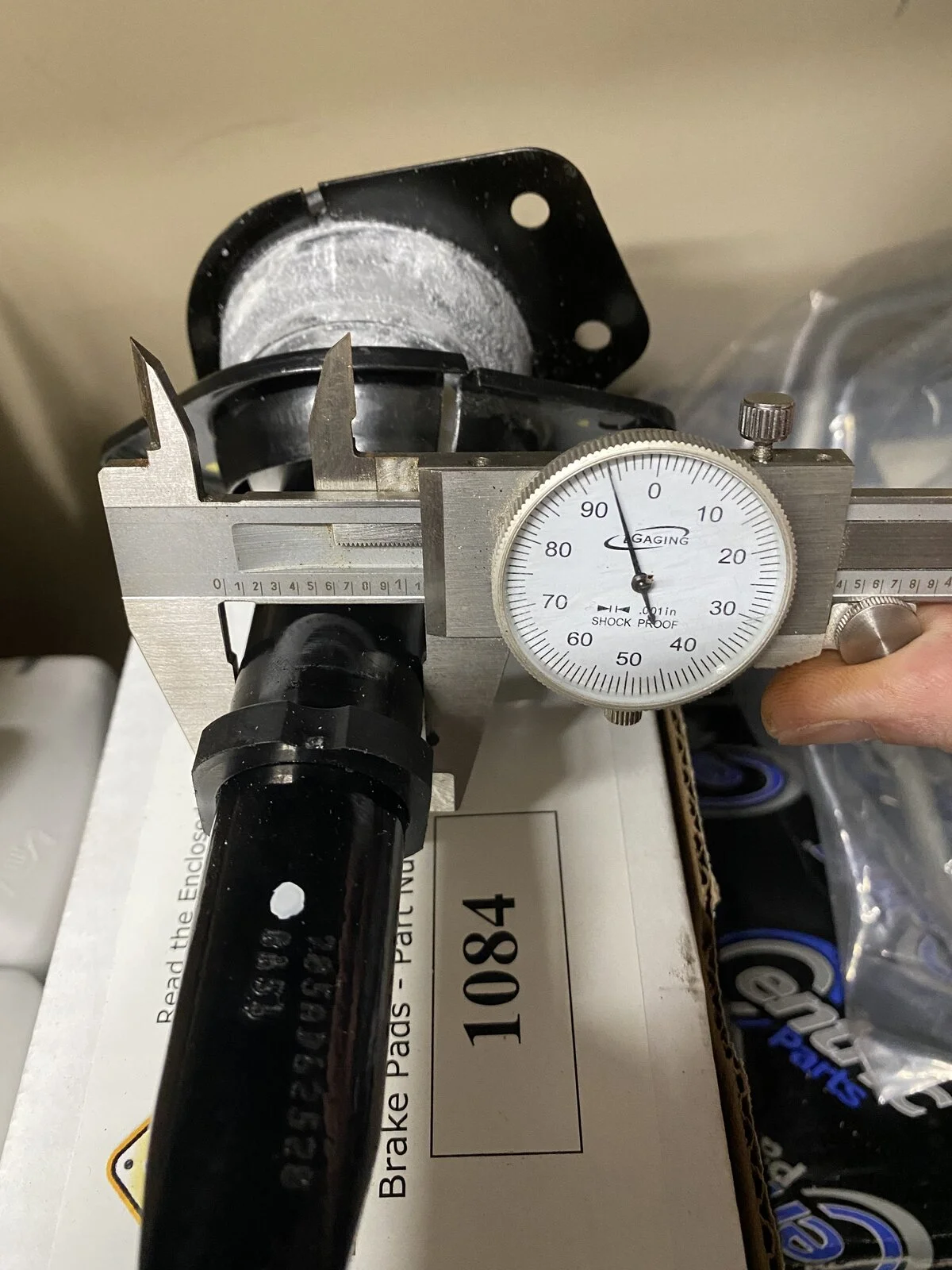

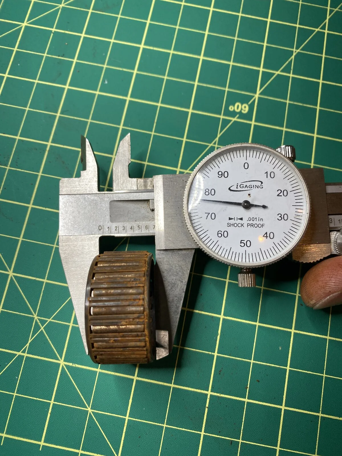

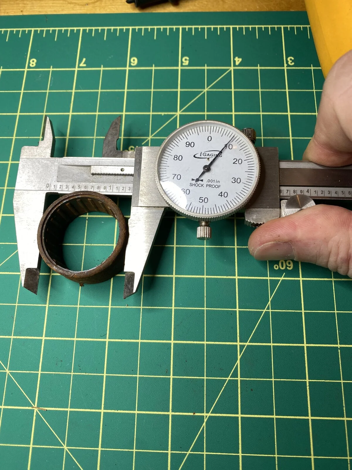

Measurements.
OD of race is 1.309"
Height is 0.675"
OD of a brand new shaft is 1.094"
It should be easy enough to find a similar size bearing with plastic cage and cut it to size. Or source from someone like these guys:

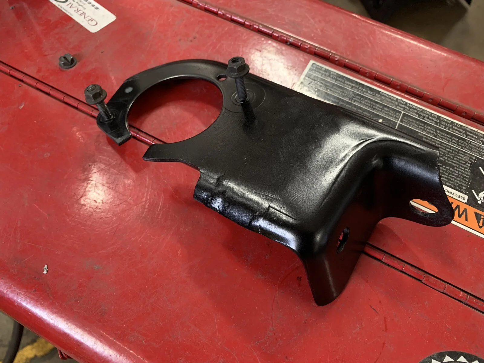

Pulled mine apart and the bearing was good but dry. I also made a 1” rise for the support bracket.
I had some roughness and ratchet like feedback. I assumed that was a combination of dry bearing, lack of riser, and my front auto locker. All of it is gone now. It’s nice when a simple fix ends up working well.
I recently installed a riser bracket. The steering does seem to feel a little tighter now.
Bearing was not dry, but I cleaned and regreased anyway.
