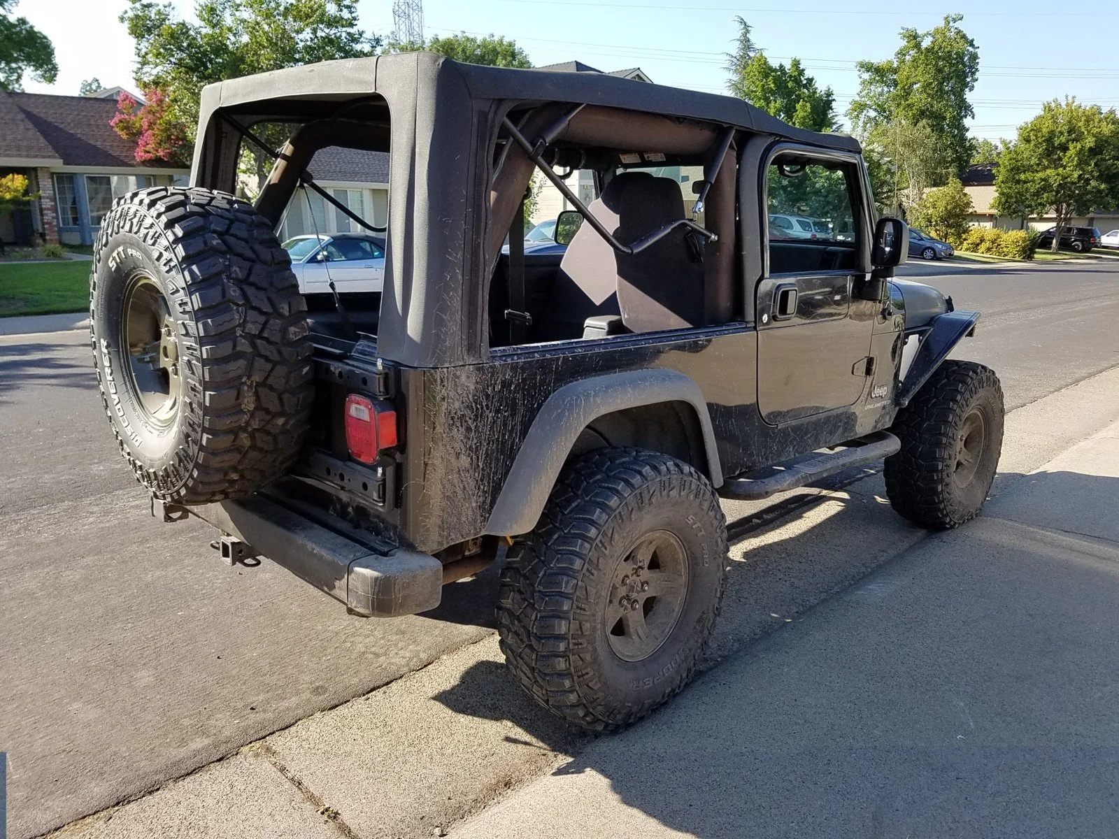

So I've been mounting my 33in spare on the factory tire carrier for the last year. Other then the tire rubbing on the top back bumper it has been fine(thought it might be good, added weight support).
The other day I noticed I had a problem opening and closing the tailgate, had to lift the spare a bit to close. Also I noticed that my tailgate paint was cracking on the top a bit and kind of dented(close to the tailgate handle), assuming this is due to added weight of rim and tire.

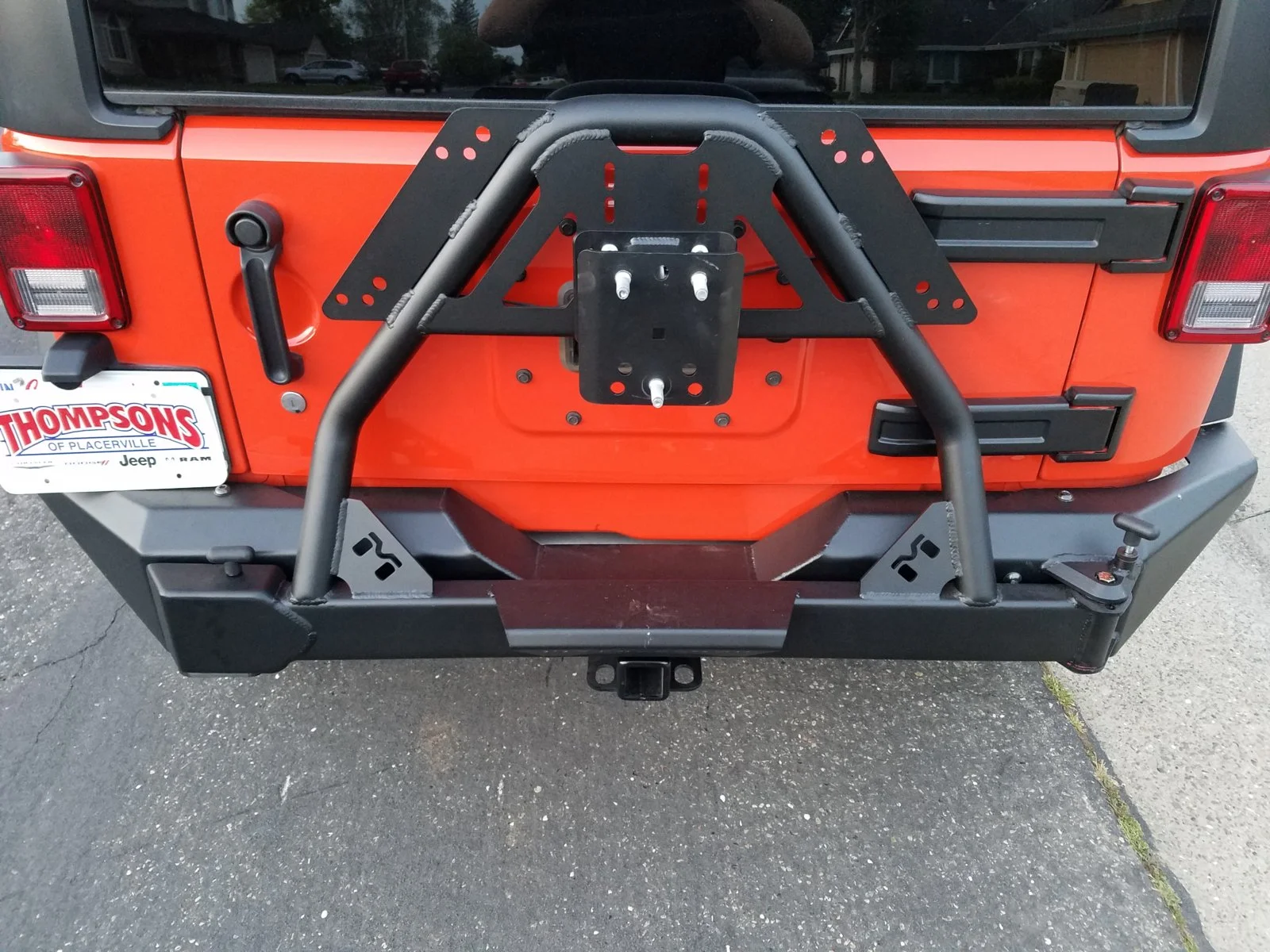

I have the exogate, I like it a lot, nice and easy to operate. I can't say it's better than my metal cloak bumper/tire carrier on my other jeep but I like it. What I didn't like it's the fact that it re uses the factory tire carrier, and is not adjustable for rim back space differences, and I had to custom fab the tire stop bumpers. They make the metal cloak bumper for the tj too, but I didn't feel like paying another 1500 (with powder coating) for it...
Reactions: MIchael C and Chris
Hot damn that Metalcloak tire carrier looks awesome! I didn't know they made one. But man, for that price I think I would have to pass, especially since IMHO it's got to be powder coated to look right.
I really like how low they (metalcloak )got the spare to sit, the double bearing and double latching like a car door. It's crazy solid and rattle free.

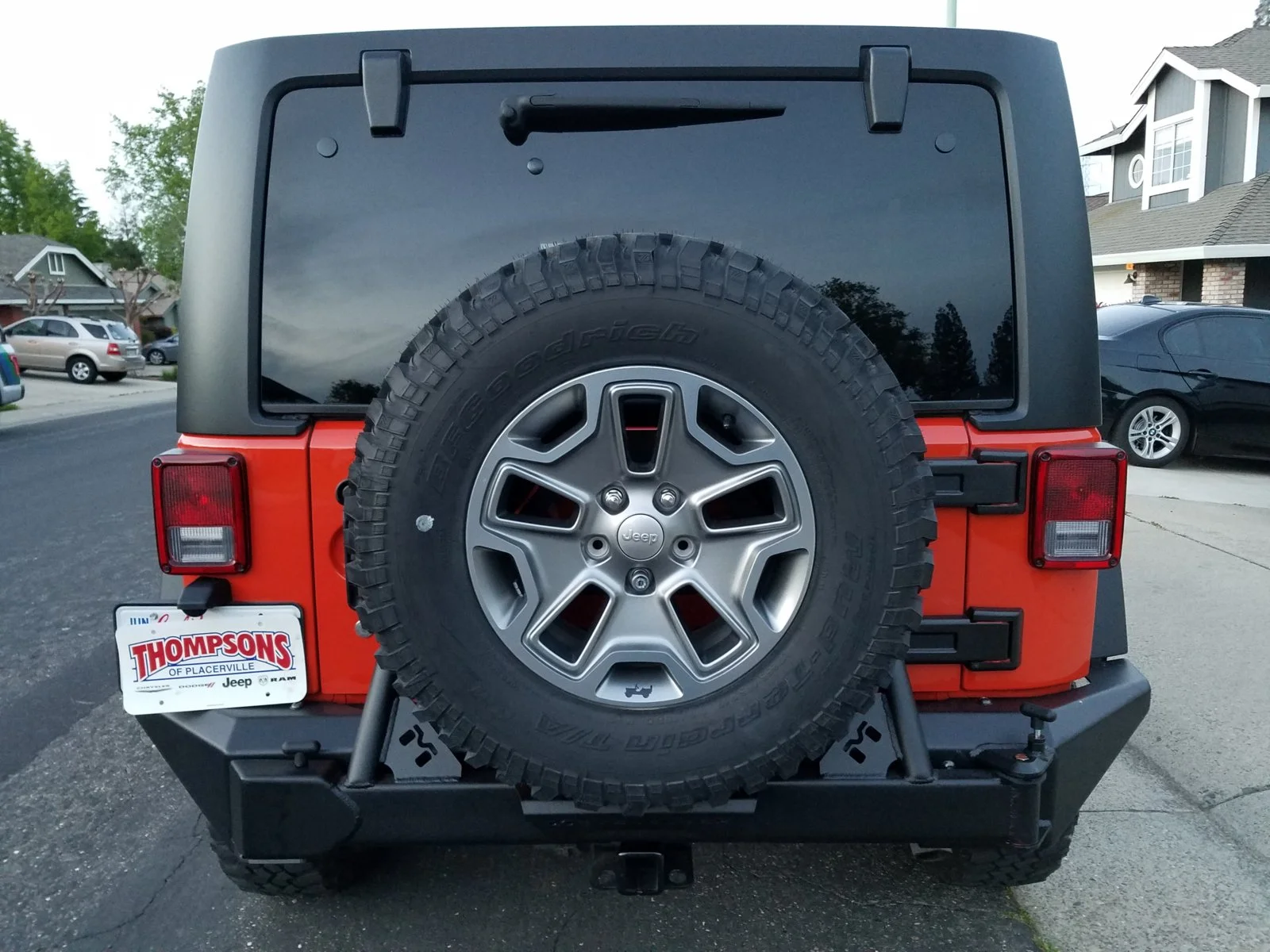

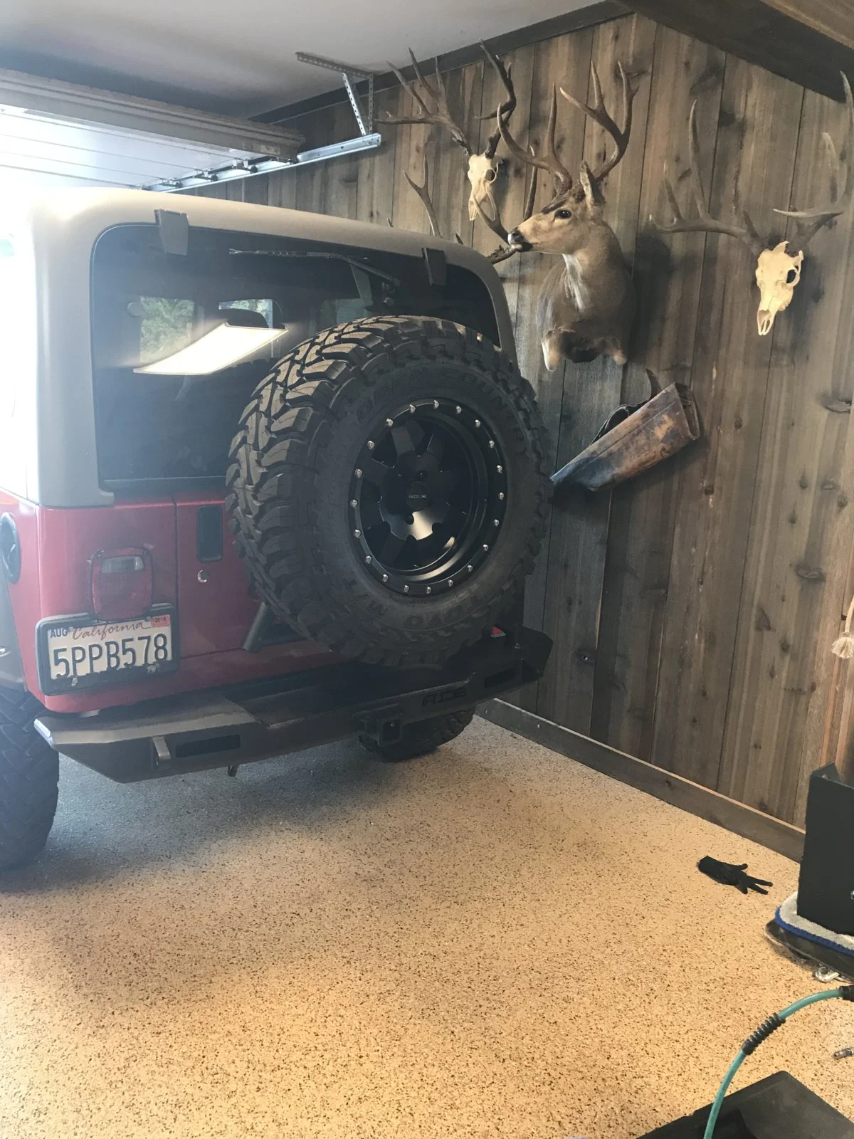

I had just put 33's on and waited 7 weeks for and ACE bumper / carrier. I just got it installed this week and so far I am very happy with it. Very solid and not a rattle I went with it because the lack of an additional latch and had pretty good raitings. Made in the USA And I already made the smittybilt mistake on the front bumper.
Reactions: lowranger
Can you show more pics of bumper and tire mount. I can see the white tail fine, and appreciate that too!
