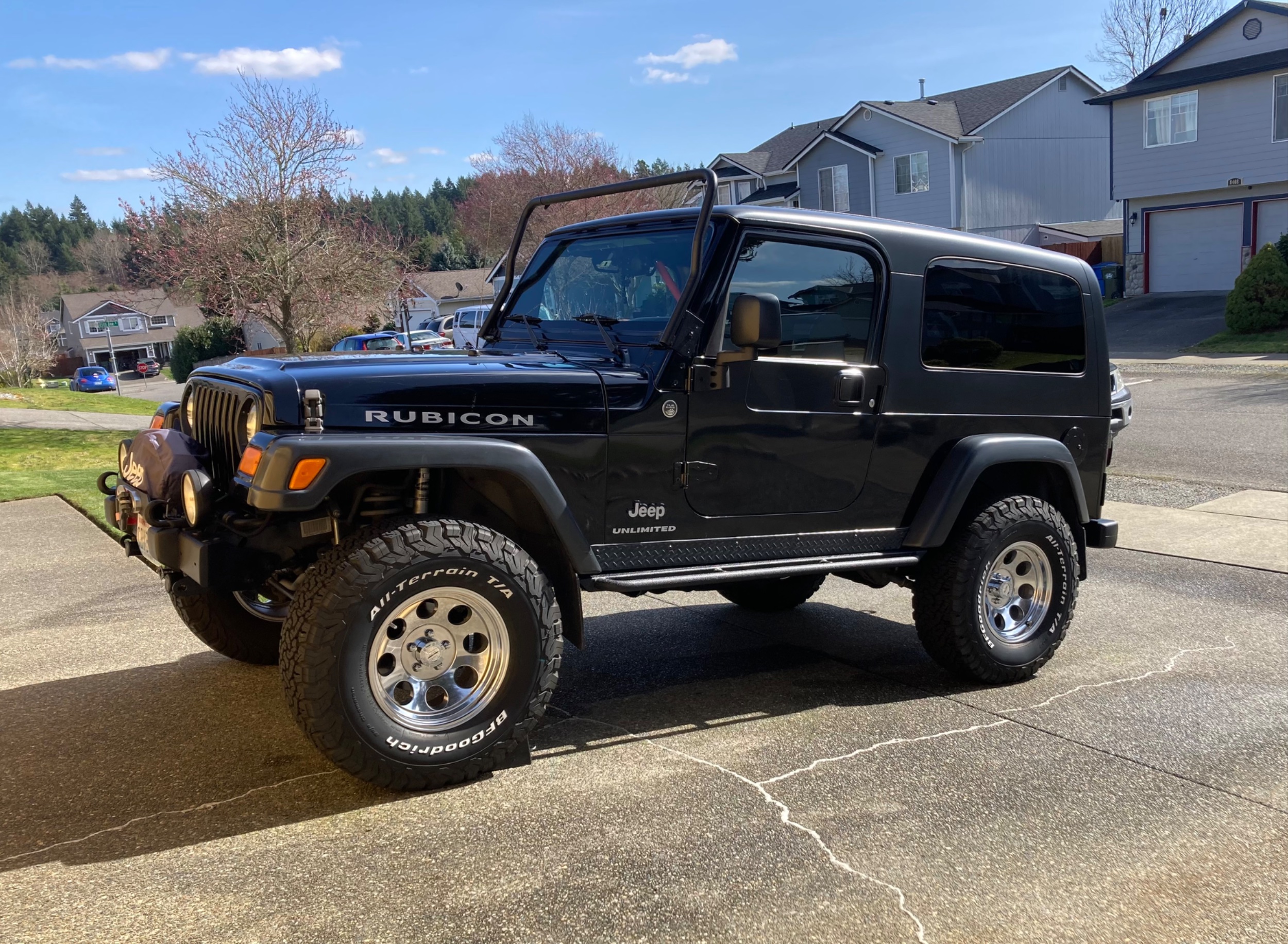

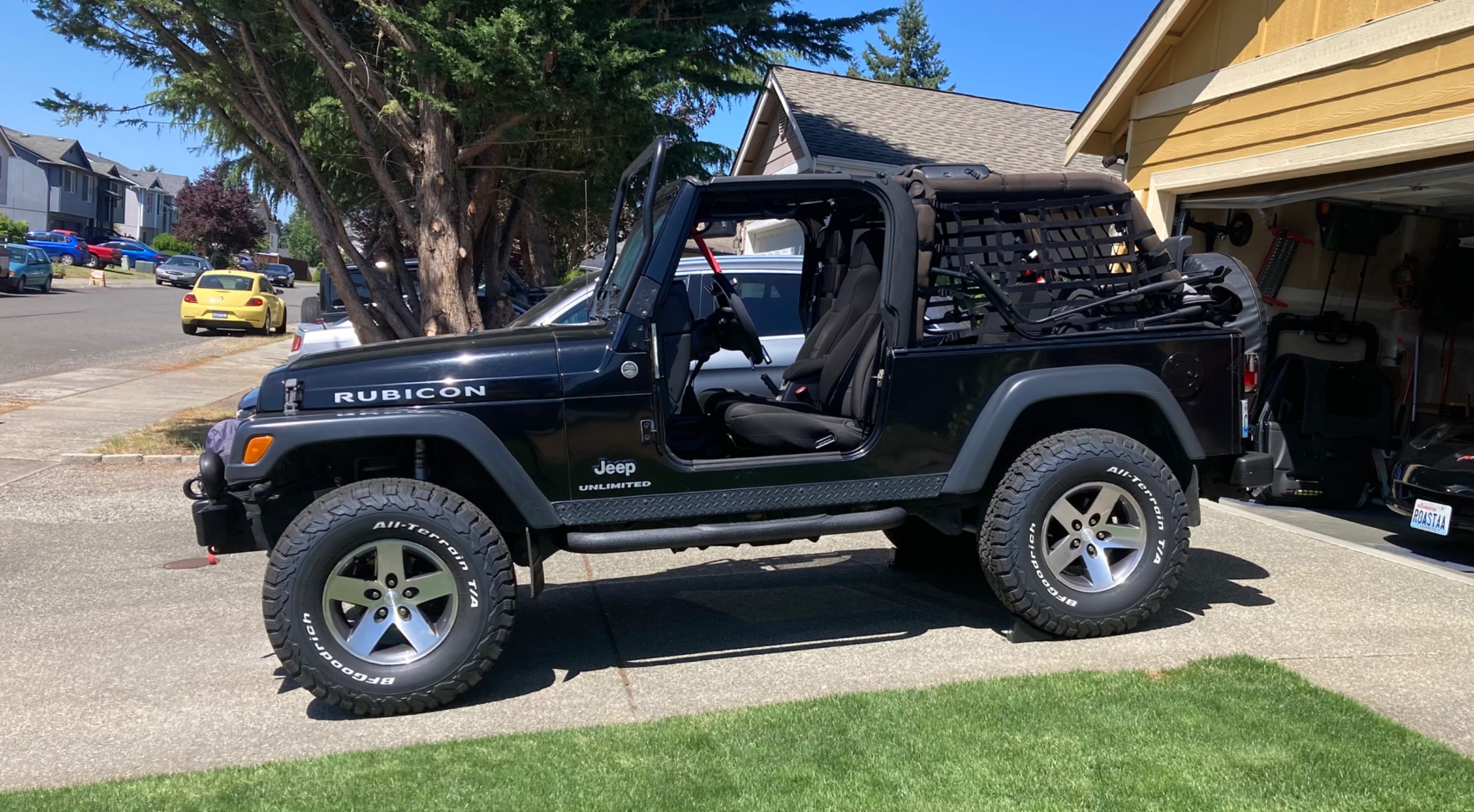

I use the OEM side steps on my '05 Unlimited. It has a 2" lift, 1.25" body lift, and 33s. My wife wouldn't be able to get in without them, and I would have a hard time too.
The TJ and LJ steps are the same. The '05 and '06 use the same mounting. I'm not sure about the '04. At some previous year, a different mounting was used.
If you have the budget Rock Slide Engineering are a nice option for your needs. Otherwise stock steps work fine. Functional sliders with steps will be to high to be practical. My sliders have a step but it is useless except for standing on when switching soft tops. There are a few companies that sell folding or removable steps that mount under the tub. Those might be another option. There are also stirrups or ladder steps that you can hang from the tub. They are not as stable so might not be the best option. My solution for my short wife is just a folding plastic step stool with rope attached. She uses it to get in and then hoists it up and puts it behind the seat.

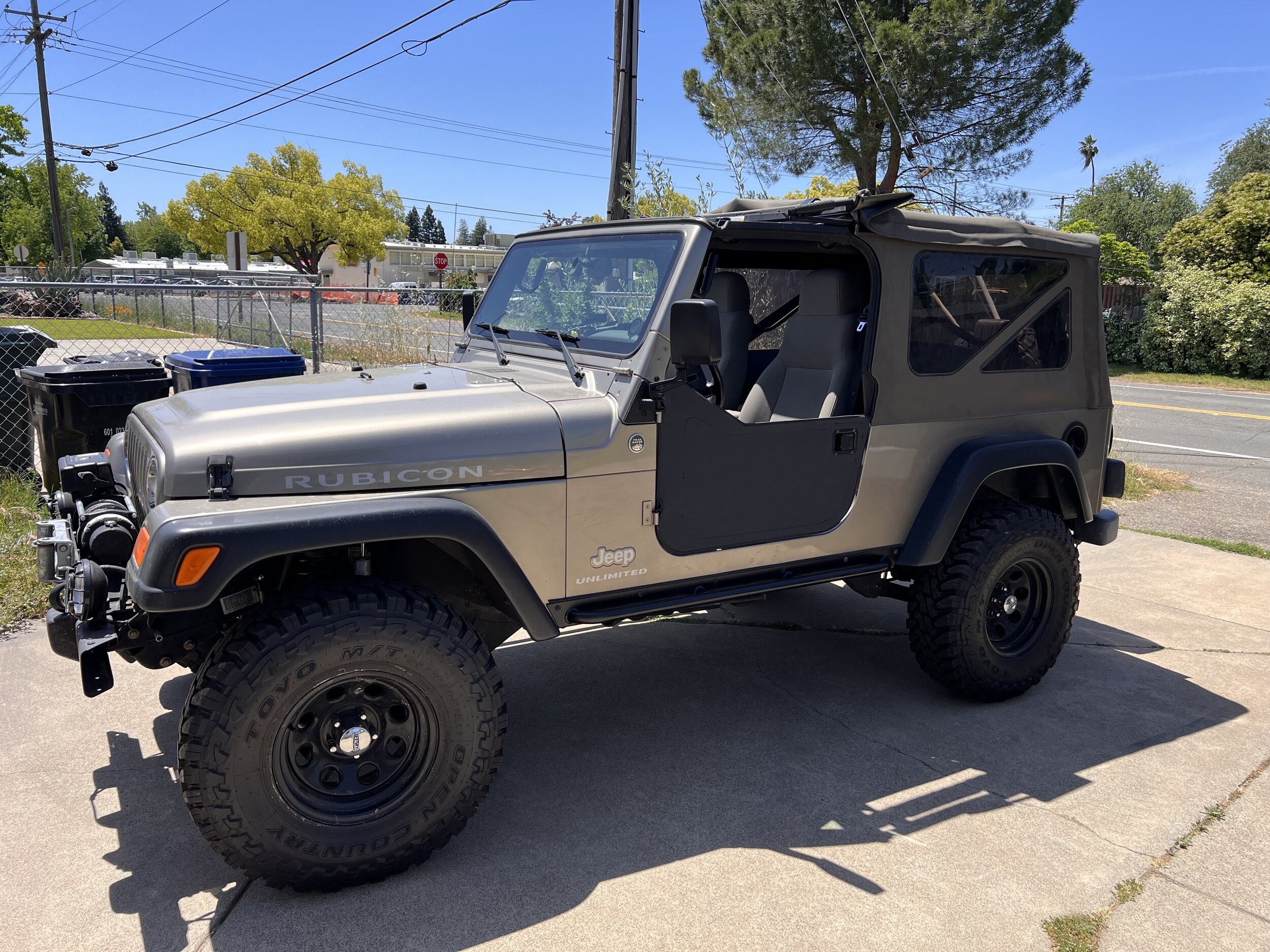

Here’s what I started with as far as side steps nerf bar then rockslider/sidestep. My LJ has 4” lift with 33’s both rim size are 16”. Also installed grab bar and strap. All together they work in unison getting in and out.
Reactions: Danarch
My steps/sliders are frame mounted, an option that many consider inferior to the tub-mounted sliders you will see alot of on TJ/LJ's. Those arguments are usually more offroad performance based instead of functioning as a step.
These specific ones are from a company that no longer exists called Jeeperman, but i believe there are similar designed steps still available. These were on my Jeep when i bought it and i haven't found a reason to remove them at all, i also prefer these because there was no drilling required, they sandwich the frame with large plates.
Edit: Another angle
