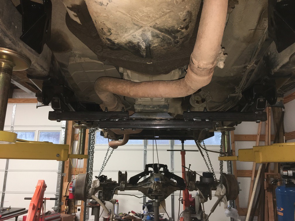

I've made some more progress on my Jeep winter project. I have all of the old lift kit parts removed from my Jeep now. I've got the rear axle dropped and hanging on chains and one jack stand so I can work on it. I have to install a truss on the rear axle for the new lift. All was going well for the test fitting until one of the rear brackets didn't quite line up to the diff housing. I'll have to make a slight modification for it to work.
Flying out tomorrow morning to help BFG sponsor some guests at the finish line of the Baja 1000. The race ends in La Paz this year. This is the 50th anniversary of the race and a lot of hoopla will be going on. This will be my last trip as a full-time employee with Michelin/BFG. 16 more days to retirement. Hoping Rob MacCachren can win it again to make it 4 in a row!
