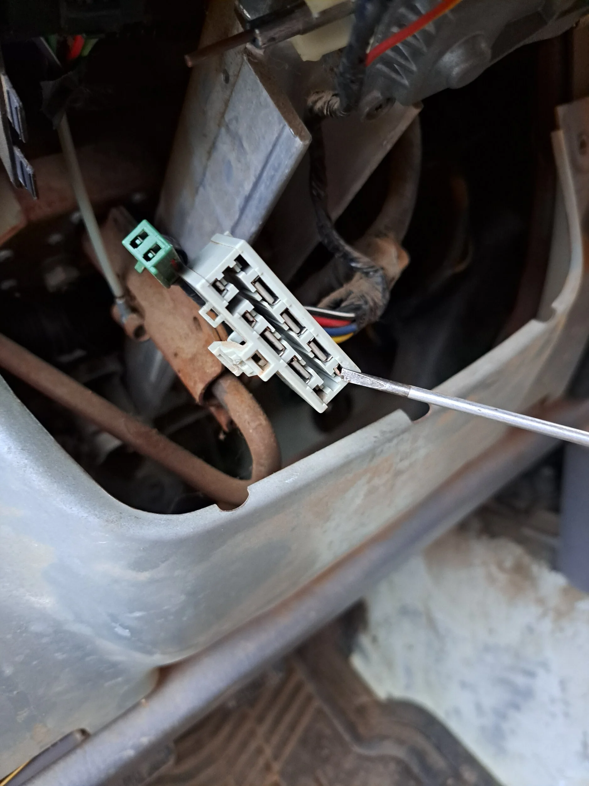

What if you send power to the start wire in the connector?on my 97 it is this yellow wire I'm pointing to.if that works you know its something other than the wiring to the starter

Got the starter issue fixed. Ran a wire from the ignition straight to the starter.
