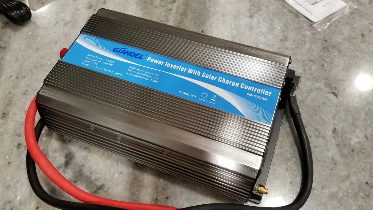

I just picked up one of these from amazon a couple weeks ago. Mainly to be able to keep my fridge and chest freezer cold if Edison decides to kill our power this summer due to fire danger. Or in case of zombie apocalypse, whichever comes first :devilish: . It's a modified sine wave but I think it will work fine for my purposes. A plus was that I could use it as a solar charger if I wanted to make a backup battery bank. I think a couple deep cycle batteries and a couple panels would keep me up and running.
I haven't tested my fridge yet but my freezer runs on 200w so it should be able to at least keep that cold with a couple of solar panels and the CA sunshine if I need it. I could always supplement with a vehicle if need be too.

I think the inverter says 1,200W and surge 2,400W on his unit. Looks like 300w input for solar. Should be sized about right for general purpose stuff. It's at least a nice learning tool.

I ran a 900w space heater off of it for a few minutes to test it out when I bought it and it did just fine. Kinda like running the winch though, you need to idle up the motor to get the alternator spinning fast.
I doubt I'll ever get the solar setup for it but it would be kinda fun and it was a plus for the inverter that didn't really add any cost.
