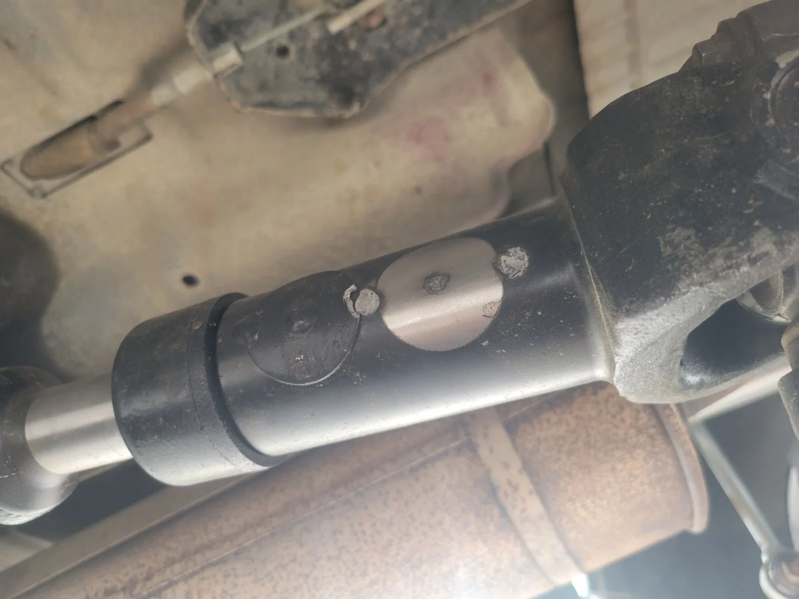

I was under my jeep this morning checking my Johnny Joints, and I saw this.
Anyone ever seen this before? I'm not blaming Tom Wood, I know they make great parts and take pride in their work, but this has happened since I last checked the driveshaft, and I haven't done ANY wheeling since then. I have driven about 600 road miles since I last inspected it though, so it could have came off anywhere. I haven't noticed any vibrations, but I haven't gotten it up over 45mph since Saturday, so if it recently came off, I wouldn't know.
I seriously have no idea how it happened though. Haven't hit anything with my DS or rear diff since this driveshaft has gone in.🤔

That weight most likely fatigued off. That chunk missing off that last weight was definitely a crack that propagated from cyclic loading. What's interesting is that you can see paint between the spot welds and the weight. its likely those spots welds didn't penetrate the weight well enough and over time fatigued.

Yeah, I saw that as well. I'm not an experienced welder/fabricator though, so I hesitated making a judgement call as to what the issue was that caused it.

My driveshaft has many scrapes that go all around the driveshaft. That can happen in the rocks any given time. I don't see scratch marks on yours though...

That's a 100% fair point. It's possible I hit something and didn't realise it. But I'm not aware of hitting anything and as you said, there's no scratches around it.🤷‍♂️

More often than I would like but not often if you take into account the number of shafts we produce. It is frankly quite difficult to get a good weld on the balance weights. Because we are welding dissimilar materials and because we gotta keep the welds small so we don't throw off the balance with big heavy welds. I used to work full time as a welder (not welding drive shafts) and I know that tack welds are not structural welds. It takes a second for the weld to get hot enough to really get a good weld. We crank our machines up real hot so we can get a little better penetration with our tack welds but it still isn't as good as I'd like to see. Not making excuses, just acknowledging that we aren't able to achieve as good of welds on these weights as I'd like.
All that being said, the weights should not come off without taking an angle grinder to them. To the OP: please give us a call, ask for me if you'd like, we can send you a shipping label so we can get that shaft back here and re-balanced. For free of course.

So I just called and spoke with Shawn. He gave me instructions on how to get the shaft packaged for shipping and said he'd get a label out to me ASAP for sending it back to be rebalanced.

Yep it happens. Welding weights on the slip yoke is the hardest as it is the most dissimilar of the materials a driveshaft is produced with and add to that you do not want too much heat where it can reach the glidecoat.
