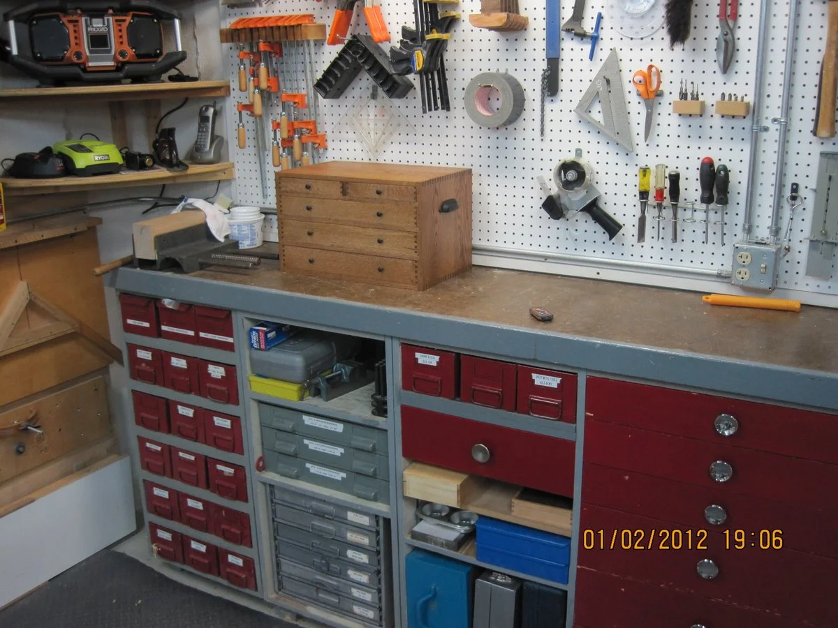

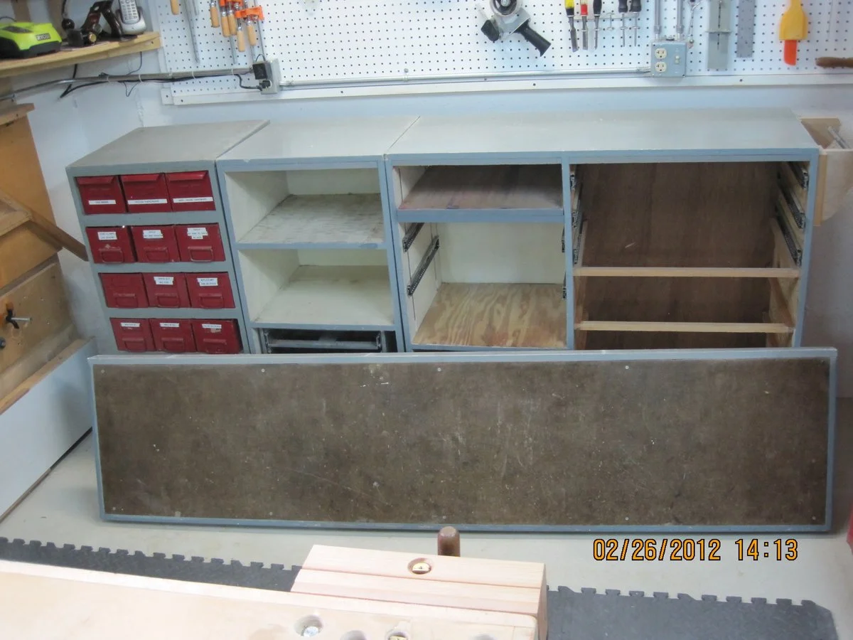

For the last 25? years and four houses my shop has contained this three module, removable top, storage unit. It’s made 3 cross country moves and has evolved over the years. I’m glad each time I was able to take it with me.
These pics show it disassembled and in use in my basement in Michigan. This gives you an idea what I’m talking about.

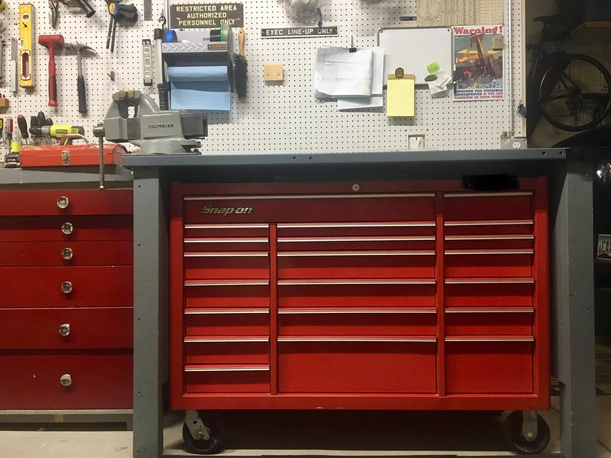

In my current garage I built a metal topped work bench over my former work rollaway.
I LOVE this set up.
I designed it so the metal bench top height lines up with the cabinets in the above pictures.

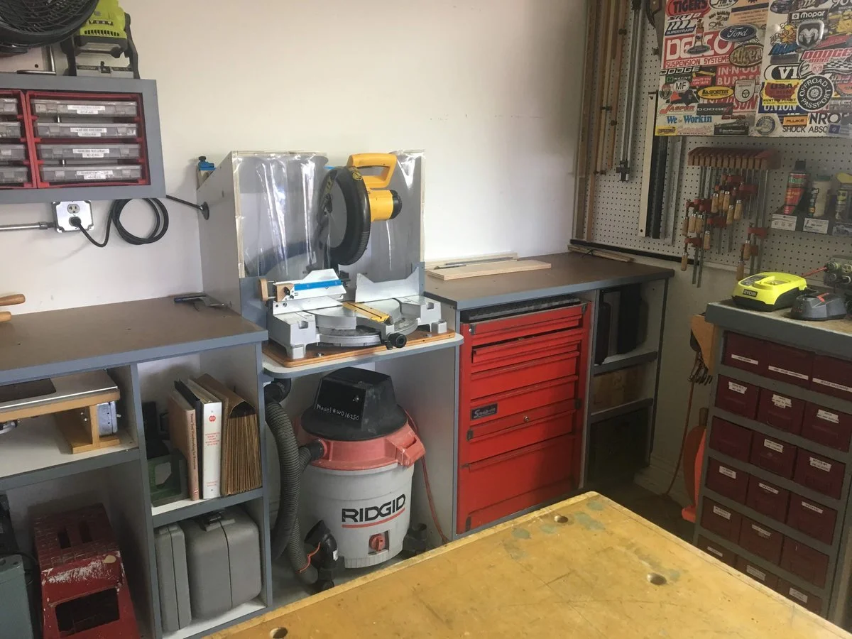

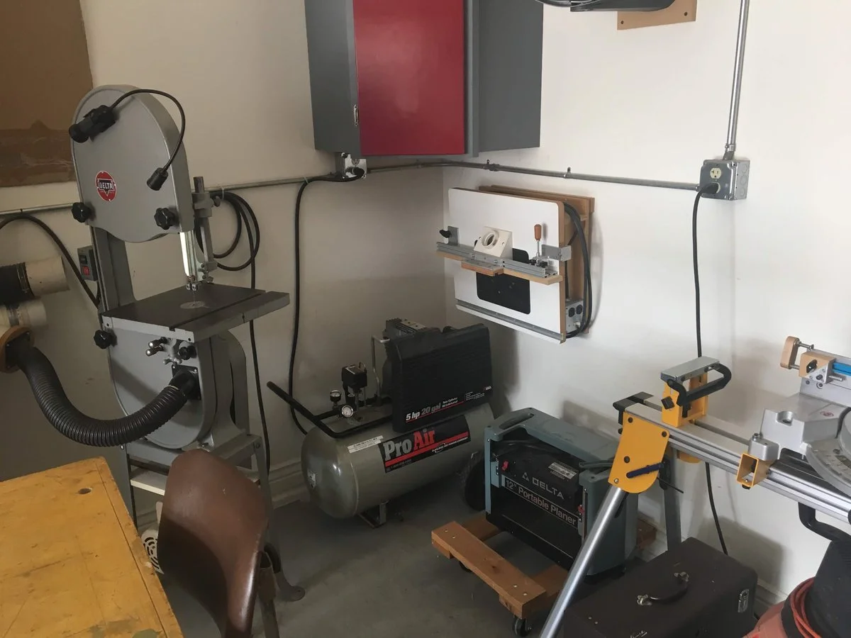

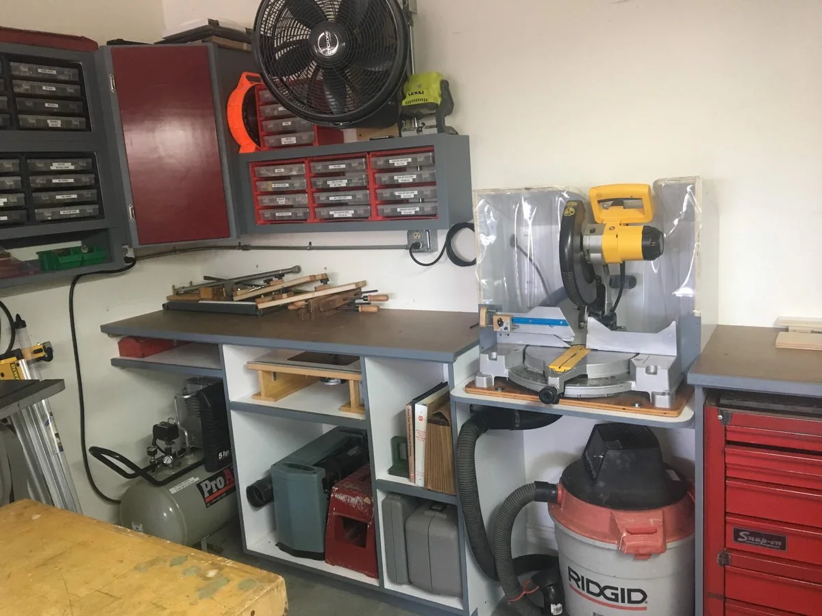

I also got tired of the crap stored on the floor on the back wall. It was a pain cleaning around everything with the mess from the miter saw.
I resisted a built in as long as I could, but finally built the bench unit in these last two pictures.
The wall storage cabinets for the hardware bins let me get rid of an old steel shelf unit that was taking up valuable floor space. Now I have a great spot for a floor model drill press!
My advice is buy a roll away, build a bench, maybe get a 6’ tall foot cabinet or two and build the rest of your storage to suit your needs and how you find yourself working in your shop space.

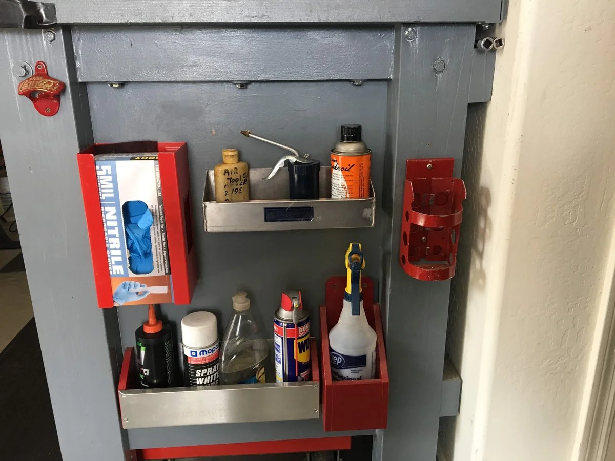

When I built my bench over my rollaway, I knew I wanted a plywood panel to provide torsional stiffness in the legs and horizontal pieces.
Instead of setting the panel in a rabbet and making it flush with the outer edges of the end assembly, I made the panel flush with the INNER edges and gained storage. This works nicely for often used things right at the end of the bench where they are needed

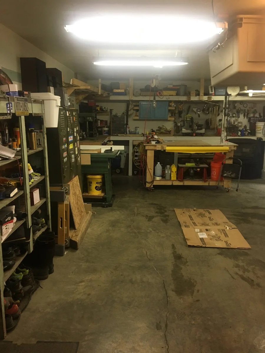

Here’s my set up that works for me in my two car garage. I got the table saw after I built the 4x8 rolling cart or else I would have sunk the table saw into the cart since it’s huge. The table has lockable caster wheels and I find it awesome for assembly and disassembly of projects both woodworking and automotive. My garage is 30 ft deep which helps. On the right side where I have a two foot kick out from the garage door I made three levels of shelves the length of the wall space. They are kind of in disarray from the pic but I built 8 individual 2x8 foot platforms so that I can remove or adjust as needed. I also build them so that I can eventually add doors to hide the storage area. All my carts wheel underneath the back counter space which also runs the length of the wall. Home Depot sells 500lb capacity metal shelving for around $100 bucks each. If I didn’t already have the shelving along the back wall I probably would have gone this route, but you lose storage underneath the bottom shelf.
