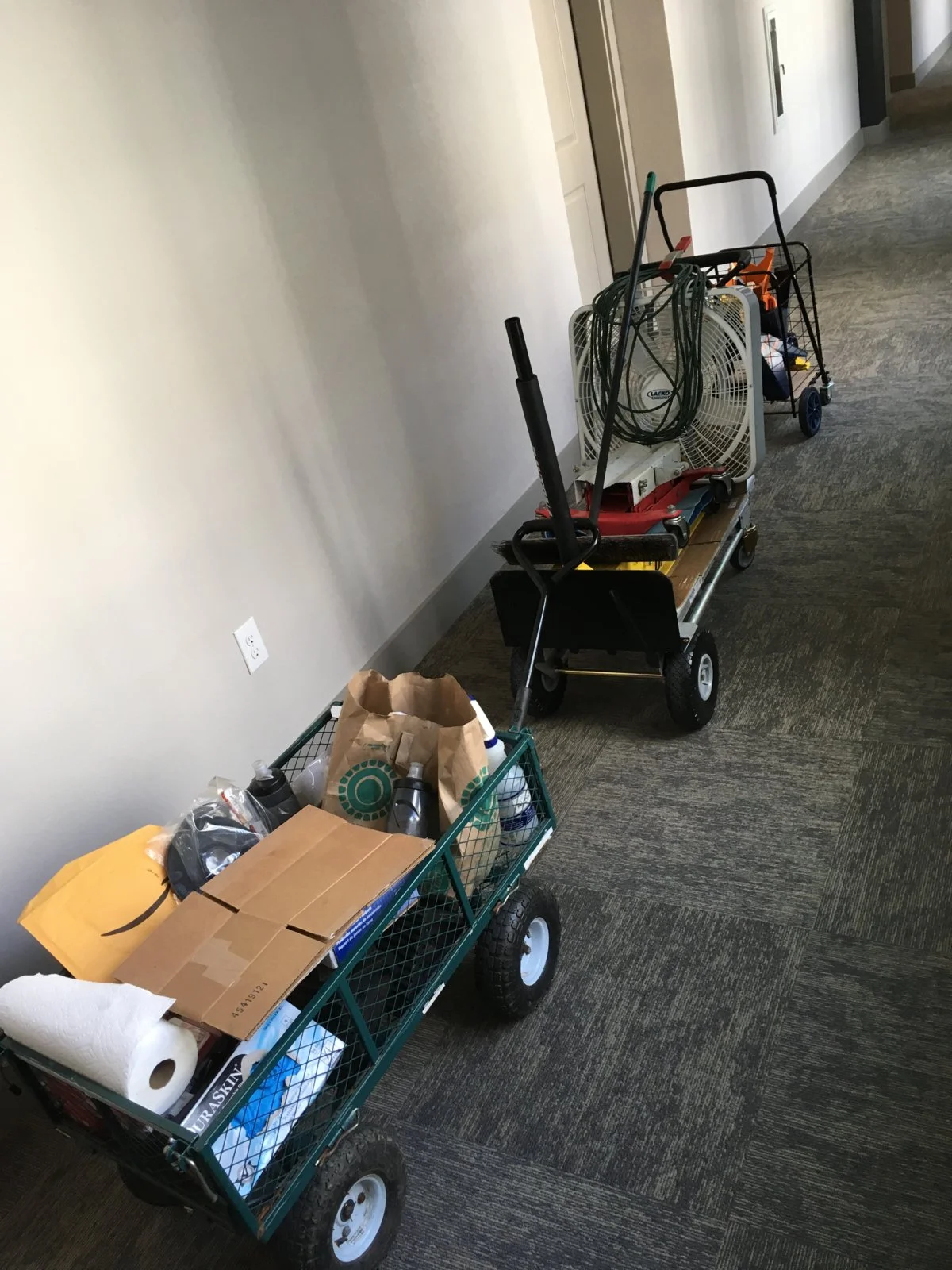

A year ago this coming weekend, Hurricane Harvey took our home and vehicles. We've been somewhat vagabonds since then, and now we are in an apartment complex. Daily I pull my tool train down a city block length hallway to a parking garage to work on the jeep. The majority of jeep fasteners require 13mm, 15mm, 18mm, and 21mm sockets in short and deep-set, standard and impact. Plus ratcheting box end wrenches in the same sizes. Wobble extensions come in handy. Long handle flex-head ratchets in 3/8ths and 1/2 drives, hydraulic jack and jack stands, transmission jack, and impact wrench. Plus a range of torque wrenches, with settings of 23 to 130 lb/ft.

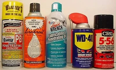

· Penetrating oil (recommend 50/50 acetone with tranny fluid)

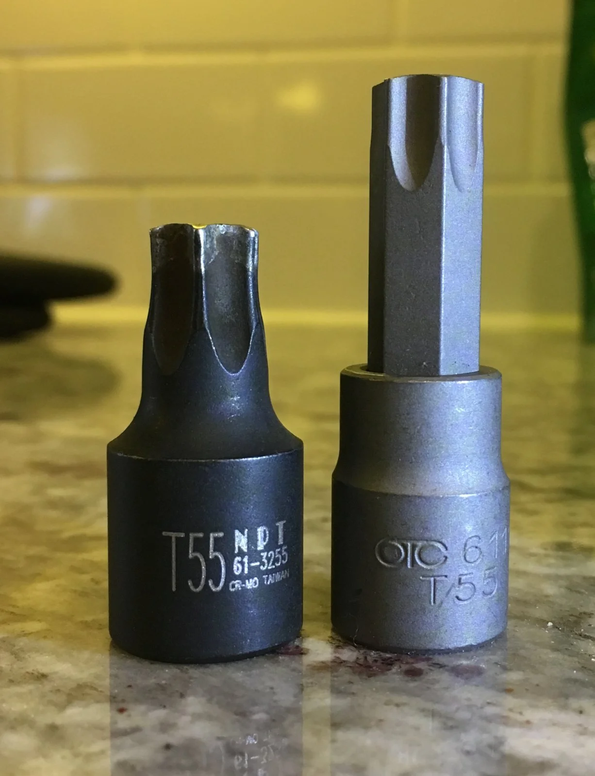

Short shank on the left, standard length on the right,
Both are 3/8ths drive. Ratchet heads are less thick than 1/2 inch drive, combined with a shorter shank, the combo will fit in tight spaces like between the trackbar mount on the rear axle and the fuel tank. Sorry, I don't remember where I picked mine up.
