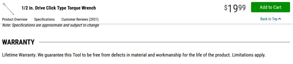

The HF wrenches also have a lifetime warranty (even on the cheap ones).
I had one that you had to tap the head on the ground to get it to reset. It would click, but not un-click until you gave the head a light tap. I took it in without the receipt and they just had me grab a new one off the shelf. Easiest replacement ever. Can't beat that for a home garage.
