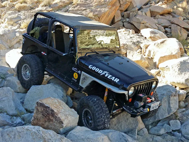

Just a little more foot training is all that is needed for smooth rock crawling. On the rocks is where my TJ lives 99% of its offroad life, on extremely bumpy rocky trails. It's pretty much nothing but a rock crawler. Placing the right-side of your foot on the transmission tunnel to partially support it pretty well stops the foot from bouncing. I'm running a 4:1 tcase and 5.38 gearing with my automatic and this is my second TJ with an automatic (I converted my first TJ from a stick to an automatic) so if a jerky throttle was a problem for me I would agree. :)
This is my present TJ, it's my second pure rock crawler....

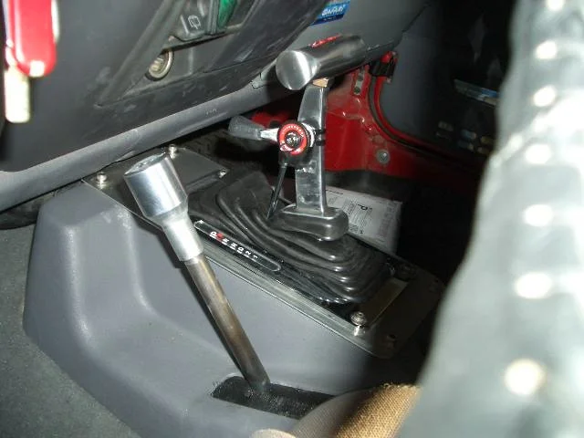

P.S. If you just can't take the gas pedal's traits, you can always install a hand throttle onto your automatic.
This is what I installed into my previous TJ when I converted it over to the automatic but it wasn't long before it was no longer needed....

Probably naive question, but how exactly do you use the hand throttle? Do set it to lock at a certain RPM or is it like a thumb throttle on an ATV? Assume it would allow for smoother acceleration and holding throttle bouncing around?
The teraflex hand throttle I have can do both. You can turn a piece that adjusts the "clamping force" the hand throttle can put on the throttle cable to allow it to act either way. Either the spring at the engine can overcome the "clamping force" from the hand throttle or it can't. I say "clamping force" because I don't know how exactly the mechanism works.
Most people usually leave it so it locks in.
Operation of a shifter mounted hand throttle is similar to a thumb throttle. Adjust tension on the lever so that it will hold at the position you select (i.e., the rpm you desire) but not so tight that you can't quickly and easily push the lever with your thumb when you need to reduce rpm.
Hand throttles are most commonly used with manual transmissions so that one can hold engine rpm while braking with the right foot and clutching with the left rather than trying to use the right foot for both brake and throttle. A side benefit is that throttle jerkiness over bumps is reduced.
I had a hand throttle in my CJ with Ford T-19 manual transmission. I used it some, but not as much as I thought I would when I installed it.
There are commercial kits such as the Teraflex kit linked above or you can make your own with a bicycle shifter. See https://www.stu-offroad.com/engine/throttle/jeep_throttle.htm
Another option would be a dash mounted hand throttle, but these are more commonly used in flat dash panels and I'm not sure how or where one could mount one in a TJ or LJ.

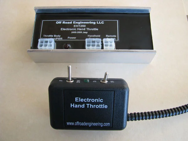

A third option, albeit pricey, is an electronic hand throttle such as the unit marketed by Off-Road Engineering (not sure if still available)
