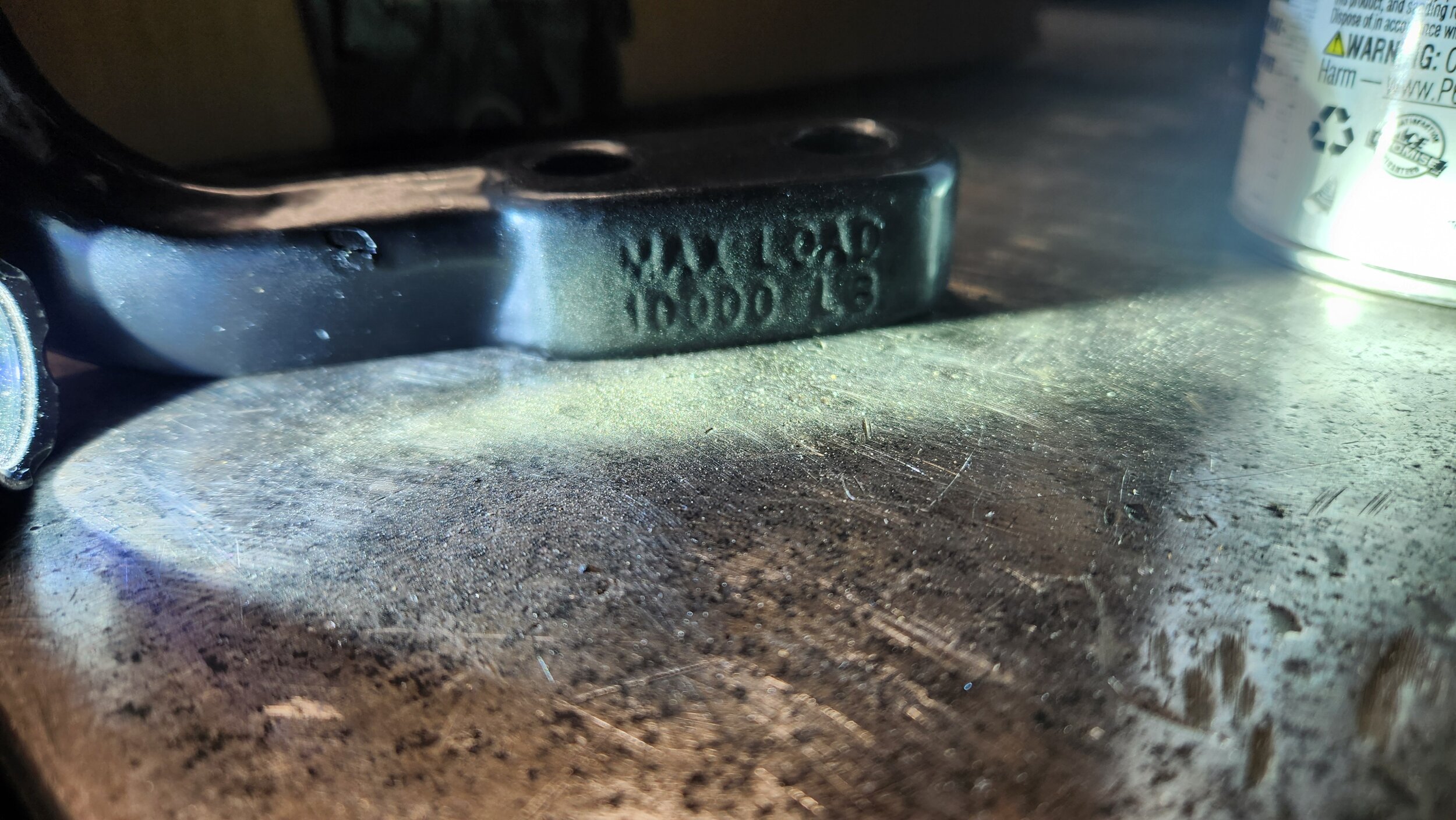

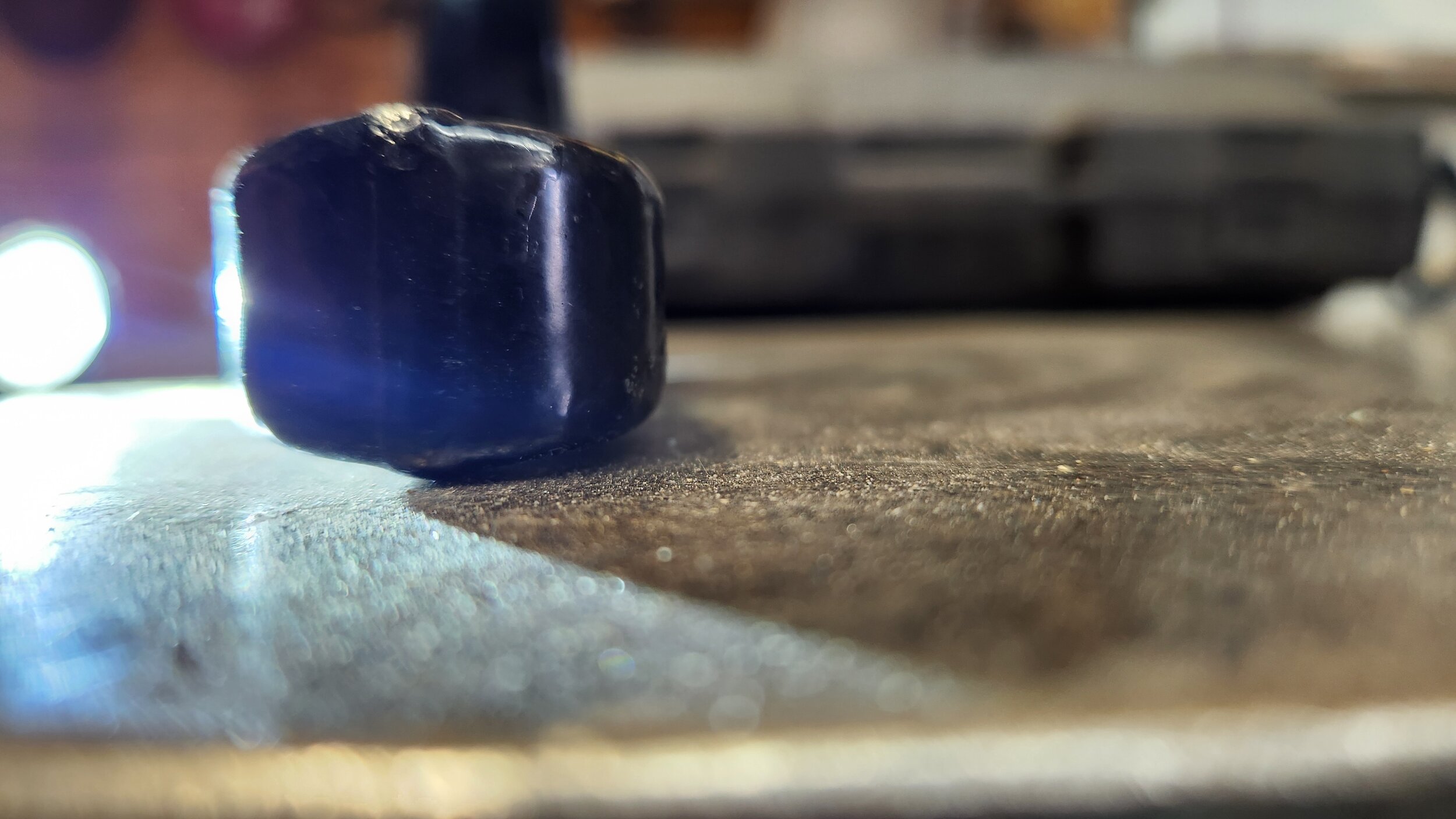

Updating this thread, I had ordered a Curt hook and just like @mrblaine said, it was seriously rounded on the bottom, it looked like a beached rowboat (see pic) I wanted the retaining clips which the expensive Warn didn't show in the pic, but I ran across these: https://www.amazon.com/dp/B07WZL8GT7?tag=wranglerorg-20 which have clips, the holes line up with the front bumper holes and they come with clips. Best of all you get two in the package. FWIW they claim a 10,000 lb. rating.

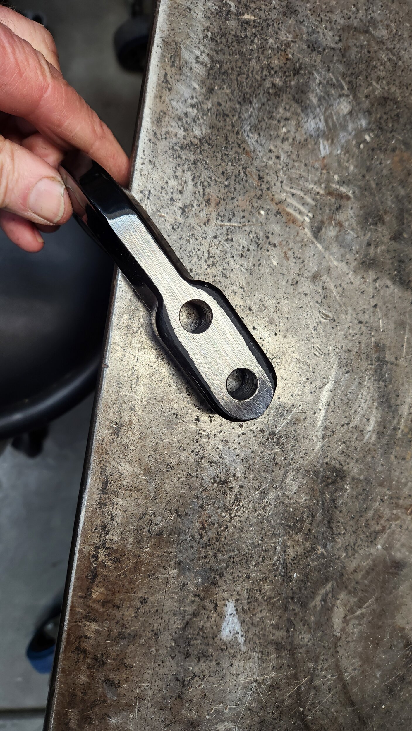

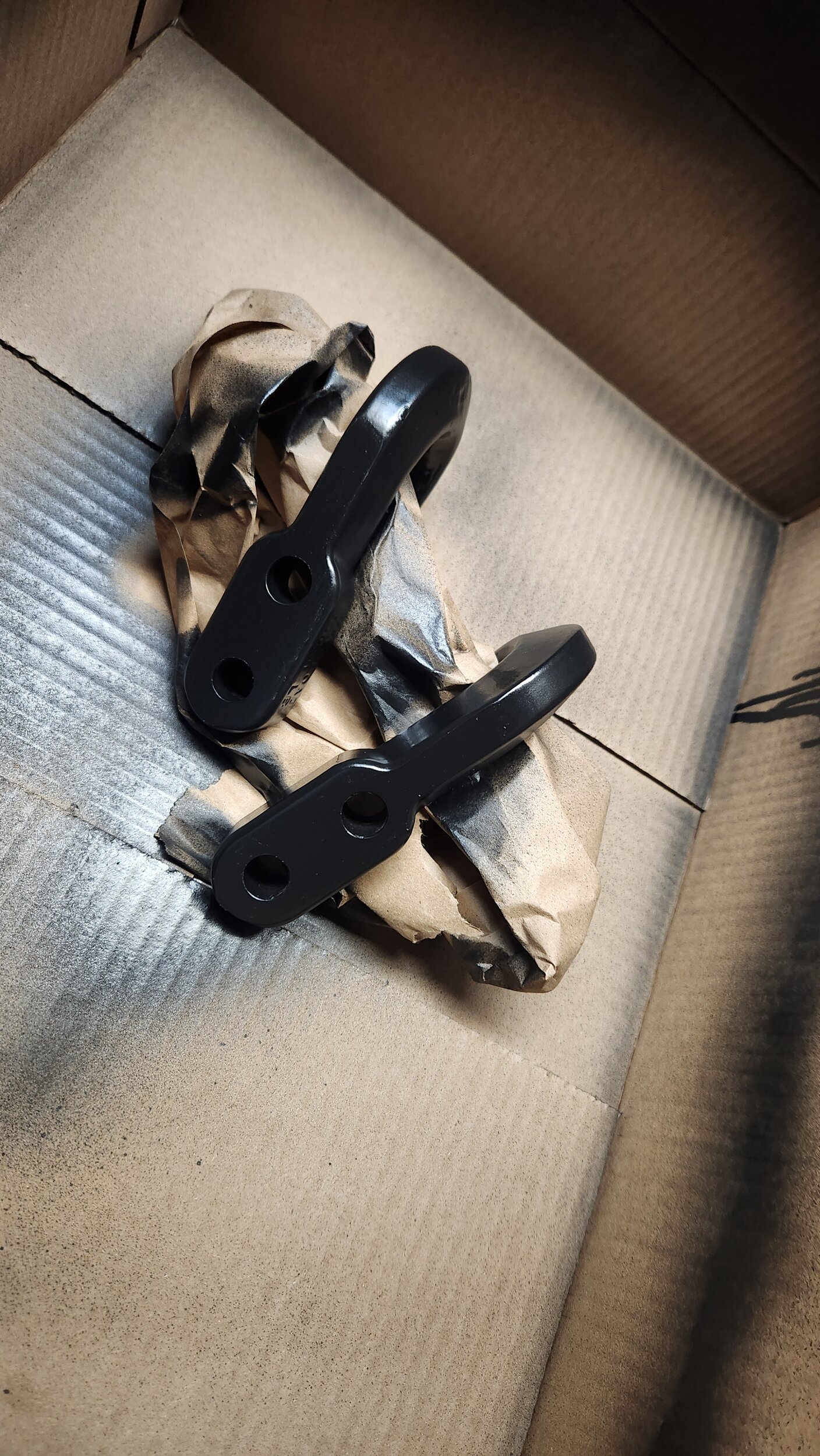

When they arrived I opened them up and there was a very slight rounded/raised ridge on the bottom, no where near like the Curt. I took them out to the shop and it literally took 30 seconds to flatten them on the benchtop belt sander (with an aluminum oxide abrasive belt). I think most of it was paint. After a quick re-paint they are ready to go. These will work for both the front bumper and the rear frame.

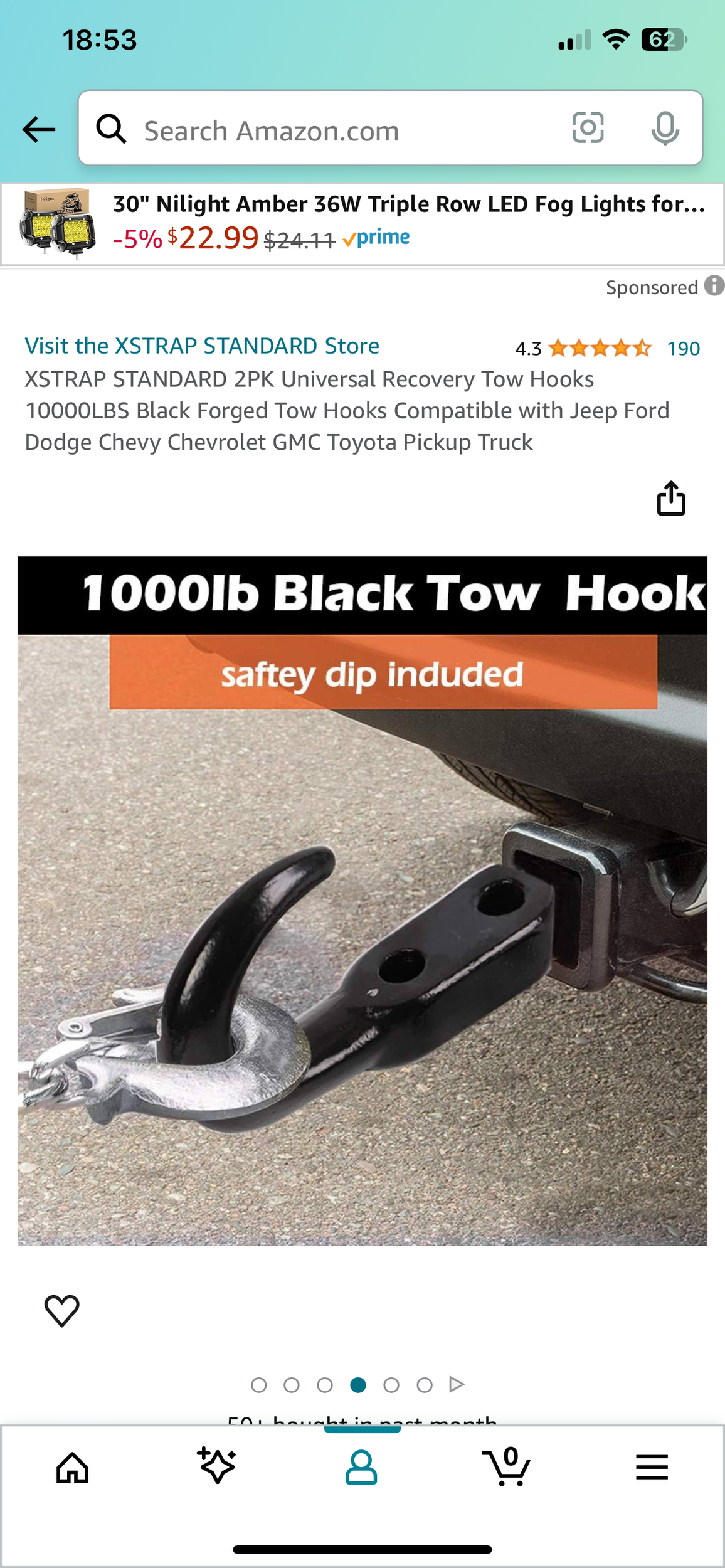

First pic is the Curt, followed by the XSTRAP
Does Xstrap Standard know how these are used?
yeah I saw that but pretty much all of the ads are like that for Chinese stuff
Yeah, I was swiping through the pics and went right by it then a second later though what the hell did I just see? 🤣
