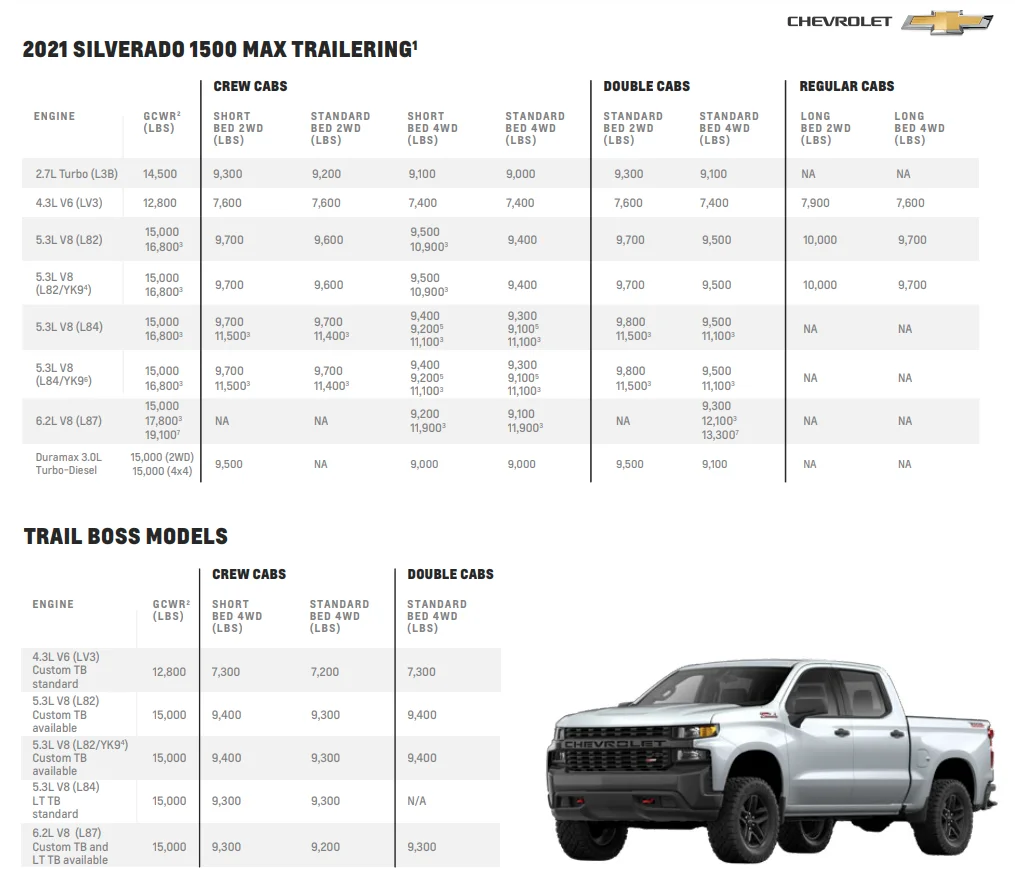

Also, OP asked about towing info which when towing a Jeep on a short trailer, payload won't be even close to an issue in a 3/4 ton. Makes me curious though what the tow rating would be on a half ton Chevy/GMC with the smaller Duramax instead of the V8... so I looked it up. You have multiple options even with a Crew Cab with the 3.0 Turbo Duramax to tow 9k+ which would work if towing 6500-7000 lbs.
The duramax 1500 payload numbers are abysmal though on the actual trucks, and honestly I would run a gasser half ton long before the small diesel if towing 7000lbs. Also, look at that GCWR on the duramax. 15000lbs. Only the lower rated 5.3 is the same, all other V8's with substantially higher GCWR.
