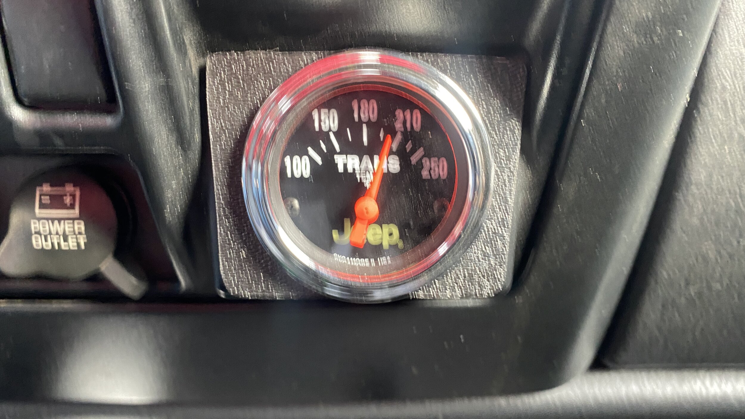

There’s no way I’d go without a gauge and cooler even not pulling a trailer. When I wheeled for 40 minutes without a cooler and just a gauge and ambient temps were 46*F my transmission temps were inching up to 210*F. Who knows what they would have been if I kept wheeling.

Curious was that in 1:1 or 2.72:1?
Got it, I just noticed that you have the Tera Low.
Dang, I wouldn't want to see the numbers when offroading in 1:1 without a cooler.
What external cooler are you running and what temps do you see when offroading in 1:1?

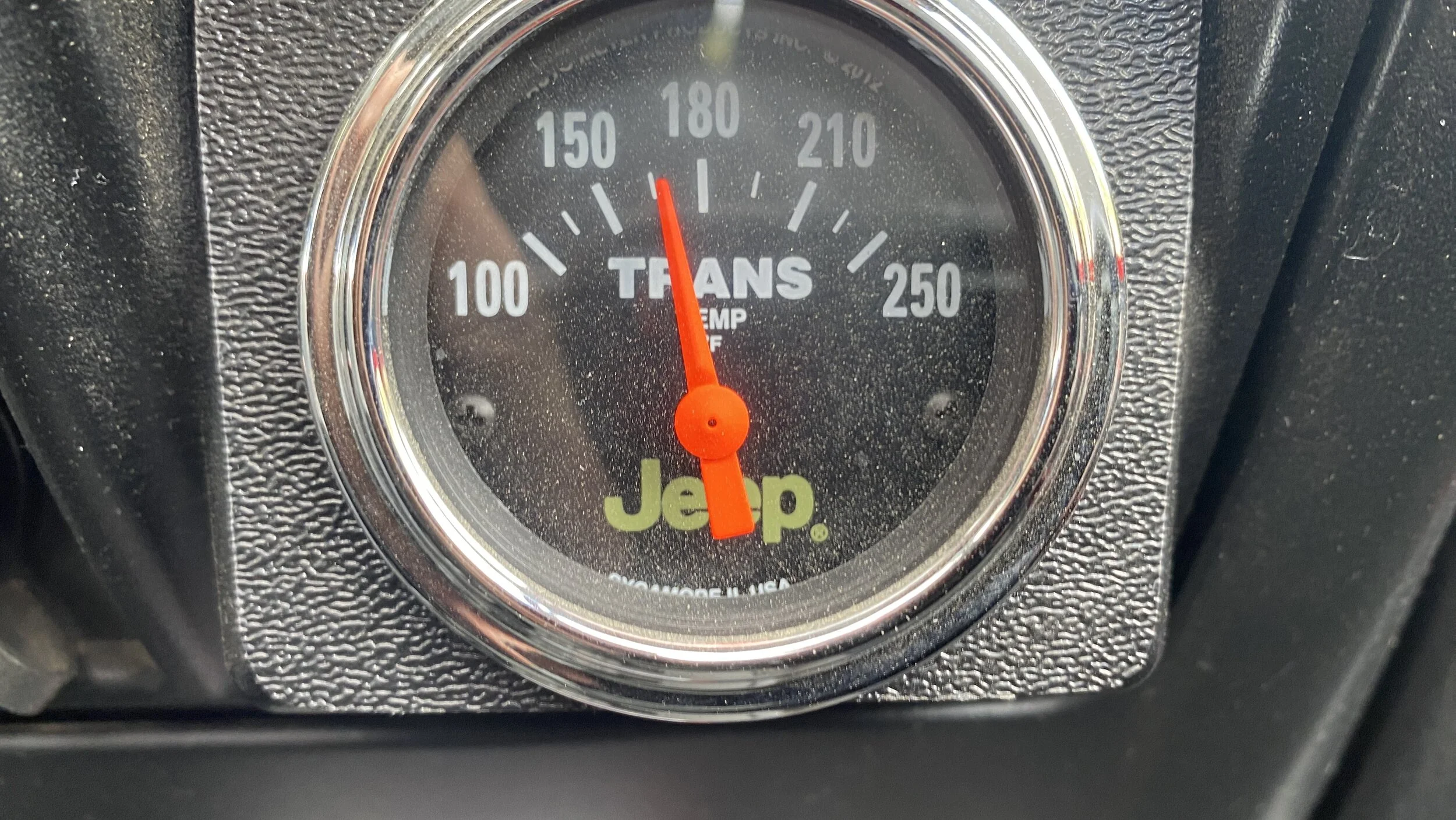

This is the highest temp I’ve seen in 4:1 with the cooler and ambient temp at 67*F.
