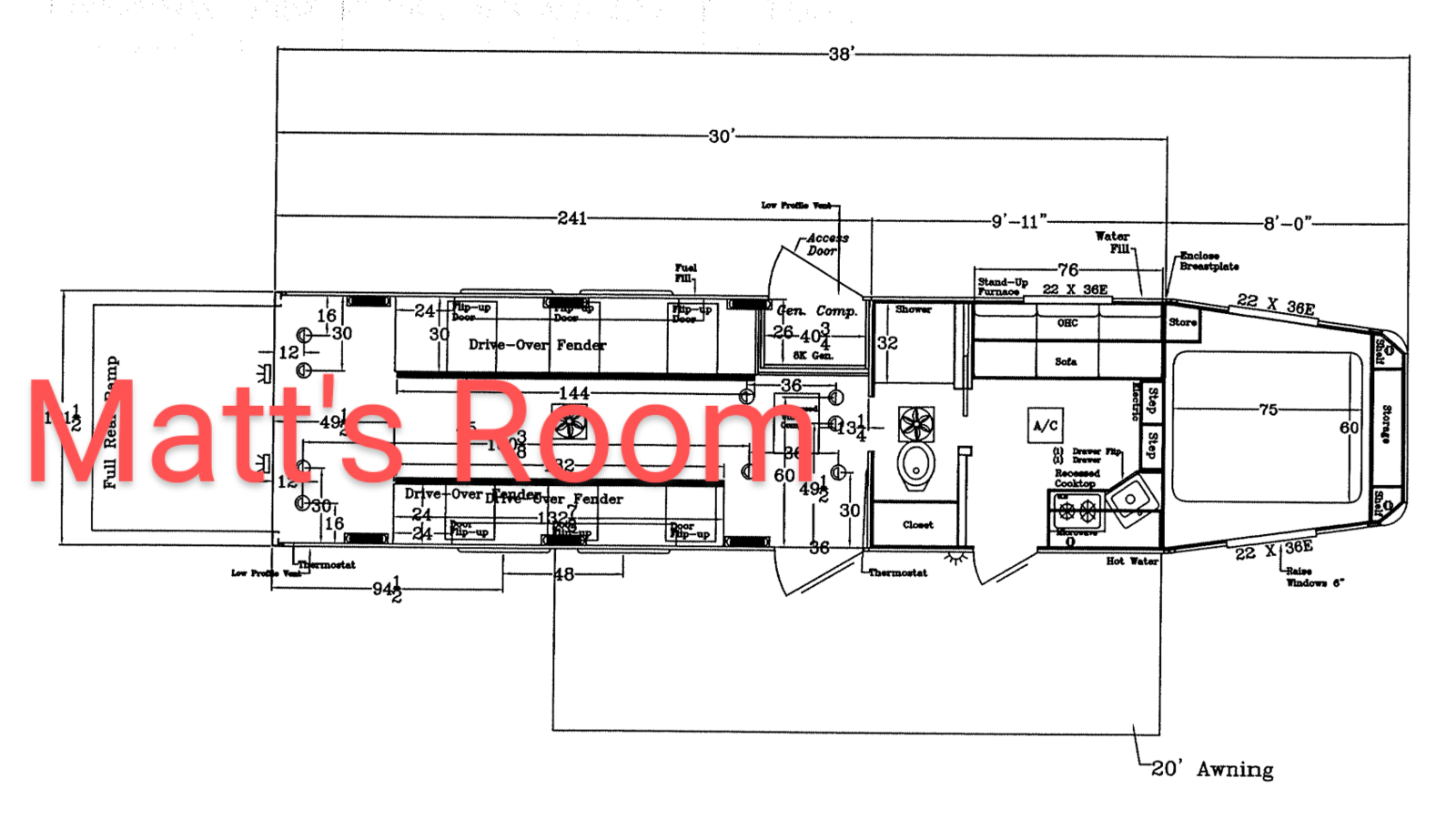

We decided on the shortest possible floor plan that would work for us so that we can be as nimble as possible. That includes a 20ft garage with a workbench, storage for tools, and on board generator. Because I might not be back at my home garage for a while, it is important to me to be able to bring tools and parts along to fix my rig so a wheeling trip doesn't get ruined if something breaks. The living quarters is 10ft + 8ft bed over the gooseneck and has a shower, fold out couch, and kitchen. It's insulated, heated and air conditioned so we don't die from the weather when driving from WI to hot southern states. Many places we want to wheel such as Johnson Valley don't have campgrounds nearby so being able to boondock (camping without electric or water hookups) was a priority, so there's onboard electricity and gas reserves to be self sufficient for a minimum of 1 week even under the hottest or coldest conditions (2 weeks under normal conditions).
The heater runs off of propane, and everything except AC and the microwave runs off 12v battery power. All lighting is LED to save on power. We're adding solar panels to be able charge the batteries every day automatically without having to run the generator. Worst case, the generator or truck can charge the batteries. If we determine that we need more heat, I will look into adding supplemental heaters.
Well, that covers the summary, but once we pick it up in September/October I'll be sure to share more details.
Floor plan:
