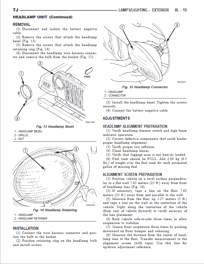

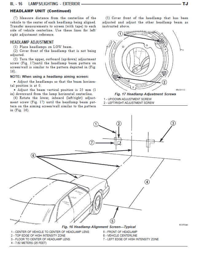

Here's the '02 TJ FSM section on headlight adjustment:

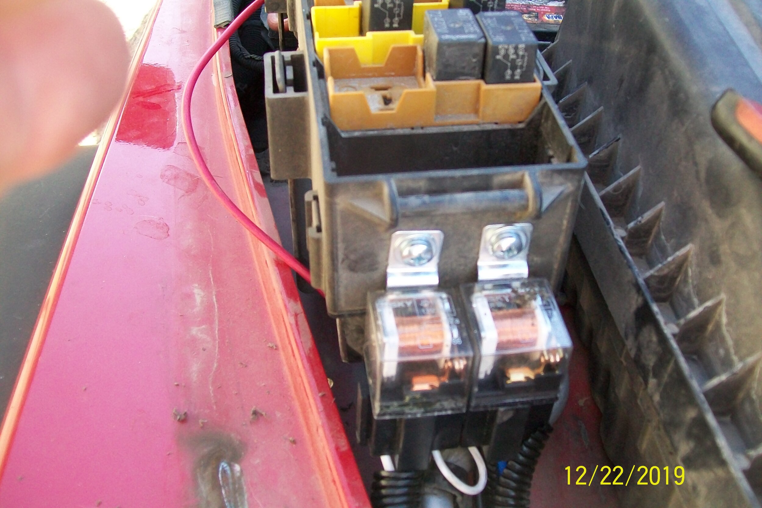

Nope super easy install. Just decide where you want the relays and the fuses.
I ziptied the relays to the bar next to the air filter. Working fantastic.
