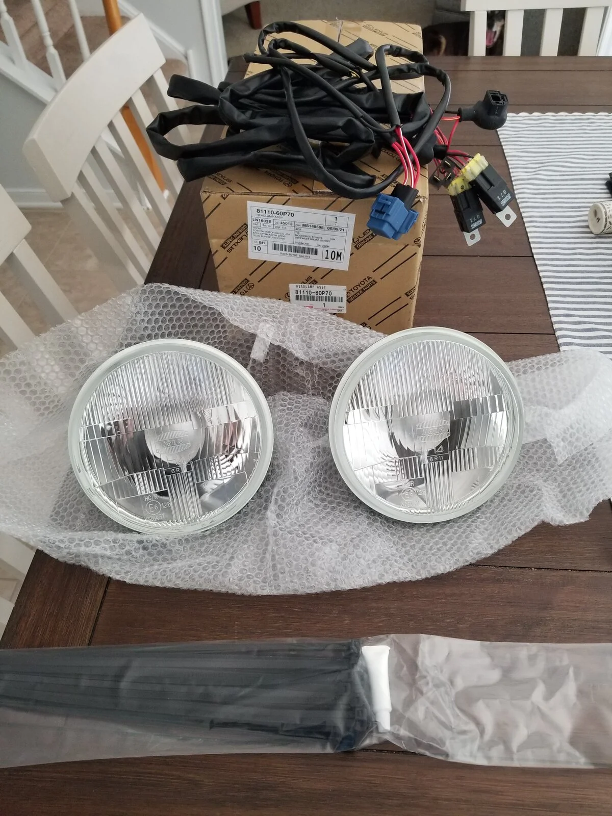

If anyone is looking for a nice alternative to LEDs and is considering the h4 route, Toyota sells a complete h4 conversion kit directly from the dealer. Part number 81110-60P70. It comes with a very nice harness with weather pack fuse holders and room for a spare fuse within the weather pack. A bag a zip ties, dielectric grease, instructions and an apology letter from Toyota saying they are sorry the crap sealed beams you thought you ordered are being replaced with these brighter h4 conversion beams. All this for the low price of $64 usd shipped to your door. My local dealer had it in stock for $58 but Ihad already ordered from their online site. This is cheaper than the hella ecodes which are typically $80 for just housings. These Koitos housings are suppose to have a better pattern as well.

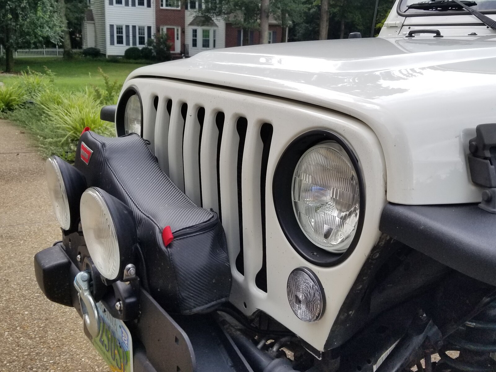

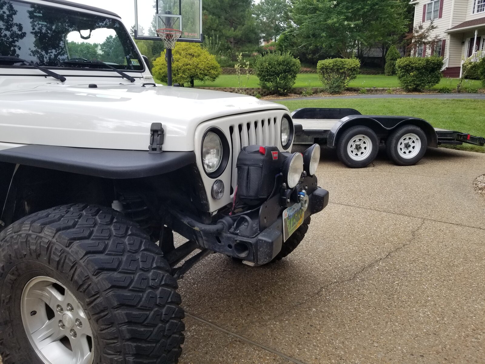

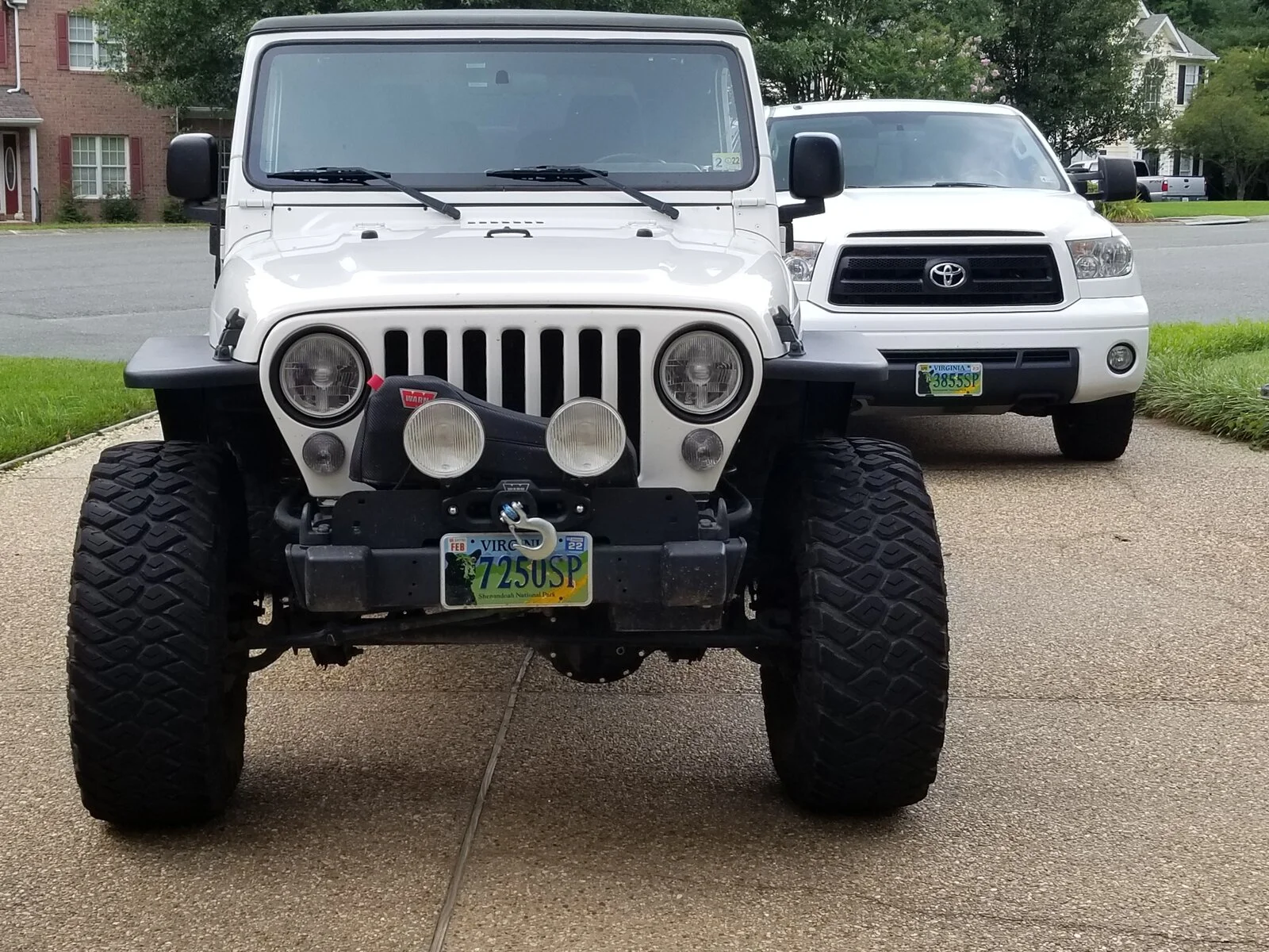

I will try and post some light pattern photos tonight. Seams like a nice cheap alternative to led lights. I like the original look of the h4s vs the LEDs personally on the TJ. I currently have hella ecodes but have never been satisfied with the beam pattern though they are better than stock. I just wanted to pass what seems like a nice conversion kit, along to others. 20210709_103738.jpg20210709_103749.jpg20210709_103756.jpg

I will try and post some light pattern photos tonight. Seams like a nice cheap alternative to led lights. I like the original look of the h4s vs the LEDs personally on the TJ. I currently have hella ecodes but have never been satisfied with the beam pattern though they are better than stock. I just wanted to pass what seems like a nice conversion kit, along to others. View attachment 264247View attachment 264248View attachment 264249

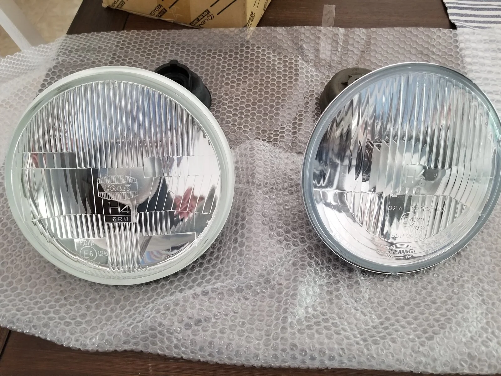

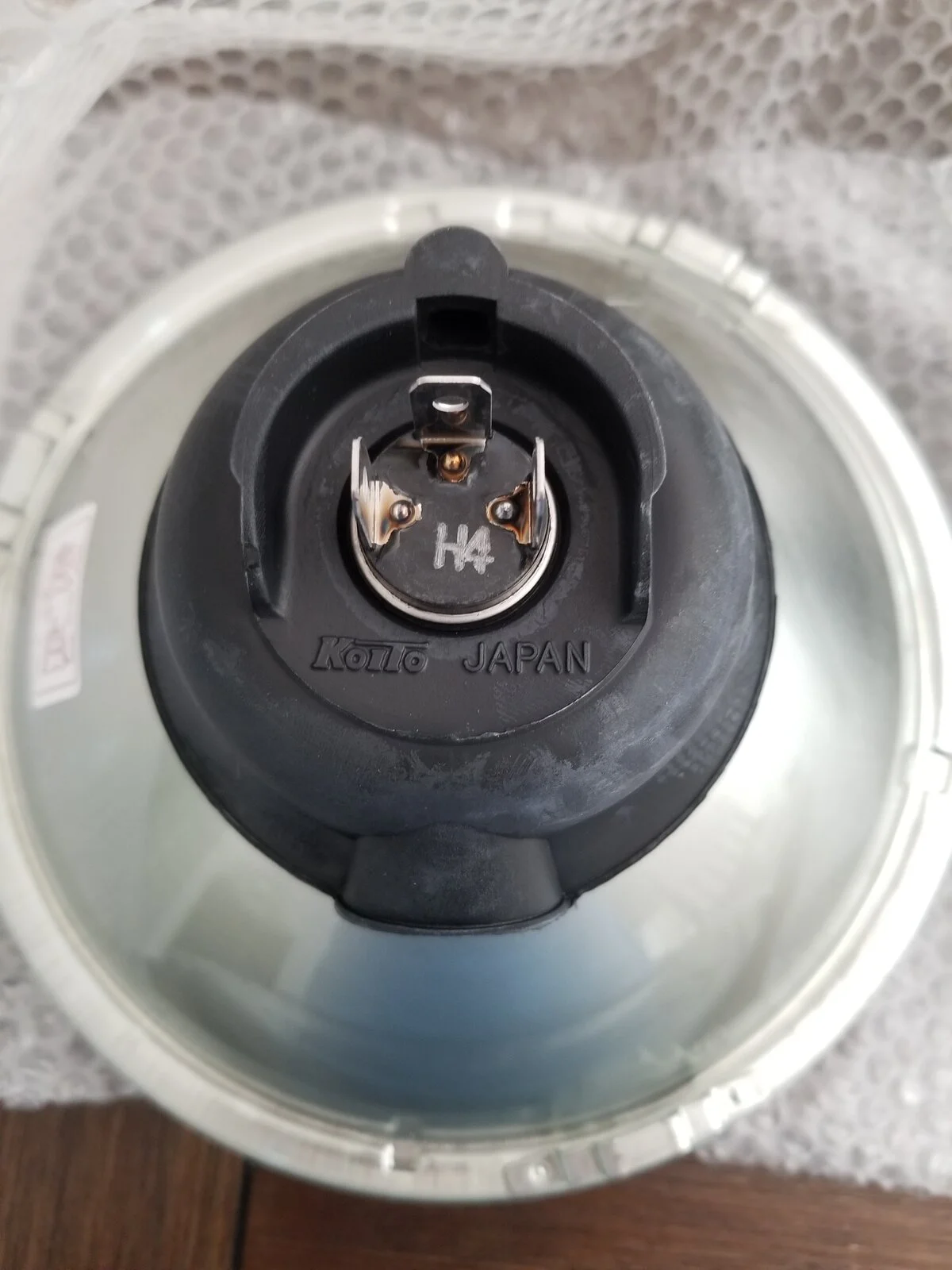

I can say the housings themselves seem to be much higher quality than the hella e codes. The bulb is secured with twist lock rather than the wire style that is typical for h4 housings. The lenses are thicker and the rubber boot seems nicer. To be honest I don't know how or why this kit is such a bargain. I need it to get dark here to test them.
I don't think a tj would need the harness unless you want to run higher wattage bulbs. The harness seems nice though so I plan to run it. Hell the cheapest h4 harness I can find on Amazon is nearly half the cost of this entire kit.
Photo comparison between the hella e code and the koito e codes. Hella is on the right, toyota/koito housing on the left.
I stumbled onto a pair of LNIB E-code Hellas for $20/both, put LEDs in them, am very happy, blah, blah, blah. BUT, if I hadn't, I'd be all over these. The E-code Hellas cost $40 or more per side if you have to pay full buck for them. Cool find!

Install pics! I still need to put the harness in but you can run the housings without the harness of you keep the same wattage bulbs. I have some 100w I might try as well once the new harness is in. The kit comes with instructions.
The lights are for an fj40. So they are now releasing this h4 kit for the fj40 land cruiser which is basically the Japanese version of the Jeep. That is the nice thing about the harness. It is long enough to reach the battery and the headlights since the fj40 battery and light placement is similar to the TJ.
Install photos attached and my Toyota photo bombing. I like the look of these better than the hella lights as well. If the pattern is good I will probably get another kit for backup housings.
