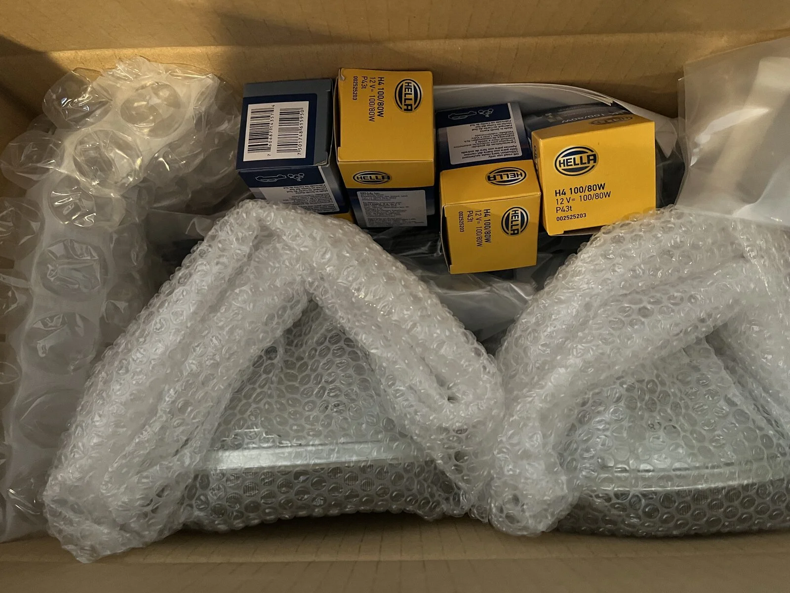

I have the full Toyo H4 kit and currently run the 100/80 Hella H4 bulbs.
Came across 130/90 Hella H4's and am curious whether the upgraded harness is ample for these higher wattage bulbs?
Has anyone tried the Hella 130/90?
