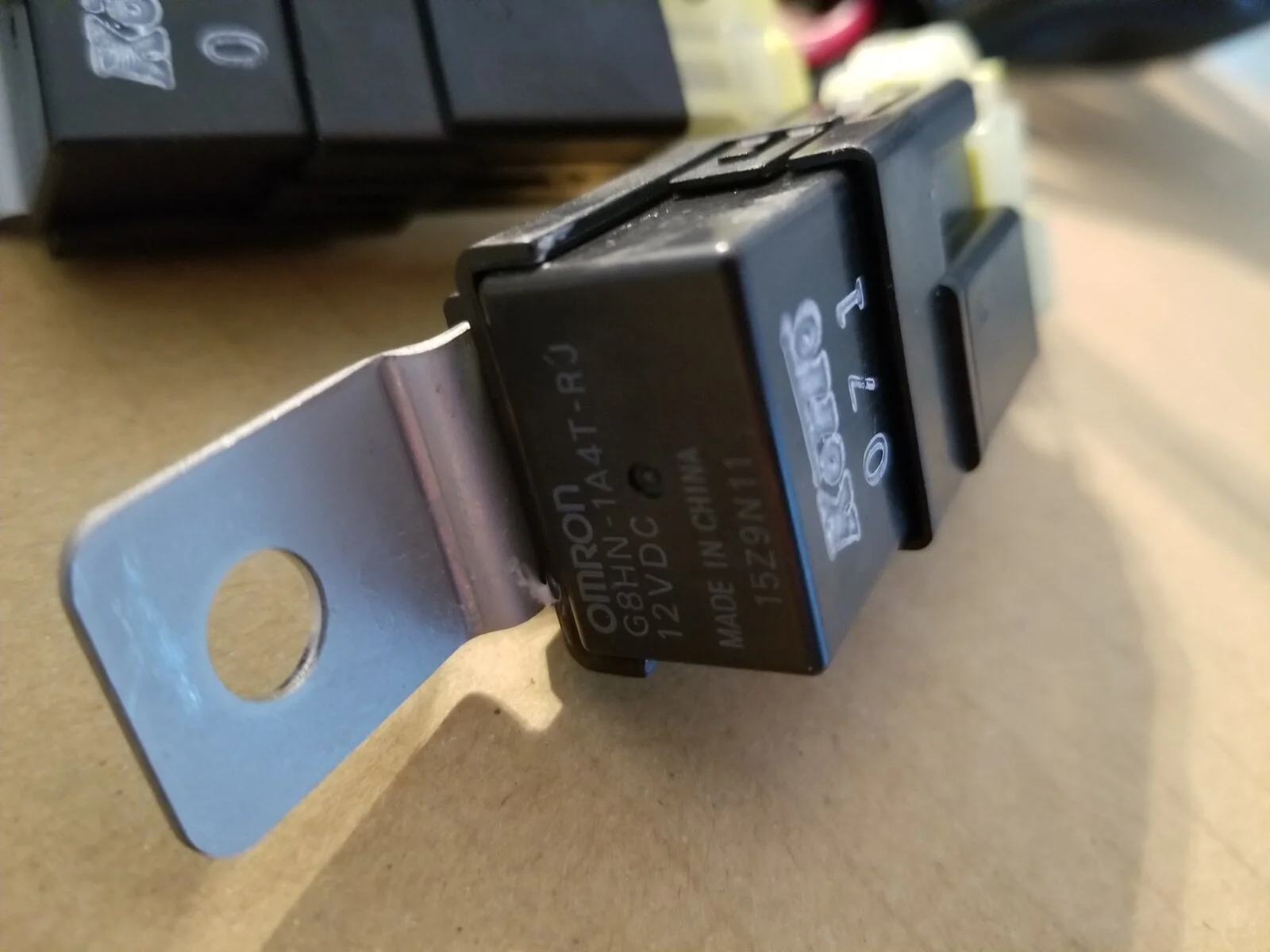

Attached a picture of the relay they use which seem to be an OEM relay used by Koito. It's hard to find relays not made in China anymore.
You cant even find H4 housings for that cheap! I'm assuming that there's no need for all the wiring when implementing in a TJ though, correct?
Correct. The stock TJ sealed beam headlamp has the same 3-prong connection as an H4 bulb so the headlamps and H4 bulbs are plug-n-play.
I'm not sure how the wiring harness would be connected but the harness itself is not necessary unless you want battery power to the bulbs. With the stock setup, power to the headlamps goes through the multifunction switch. Bypassing the multifunction switch allows you to run higher wattage bulbs without melting the switch.
