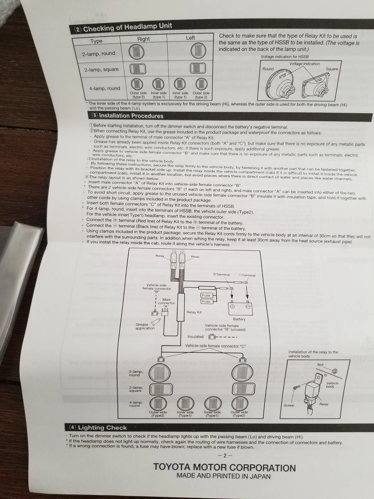

so if I'm reading this right:
- stock harness with these is good to go
- can use 100/80 H4 bulbs if I install the included harness no?
- the included harness also appears to be plug and play no?
Reactions: defenderu
You know that I love you guys, but some of you are just plain overthinking this wiring harness. It's literally as simple as Red wire to hot side of battery, black wire to ground side of battery, unplug FACTORY connectors from lights, plug NEW HARNESS connectors into lights, plug connector from NEW HARNESS into FACTORY harness. the rest is just deciding where to run the wires. The kit even comes with instructions.
that is simple enough.

I installed the harness today. I separated the leads for the high and low beam circuits, removed the included fuse holders, and installed each lead to an individual terminal on a Blue Sea fuse block.
I didn't have a chance to take it out tonight, but I imagine that even with the included bulbs, the harness will benefit with better light than just running the housings and bulbs without the harness. I'll post back with my impressions later this week when I get a chance to get out after dark.
Good deal!
Could you tell what gauge wire it was since you modified the harness? I almost cut into the harness just to confirm the wire gauge but I didn't.
