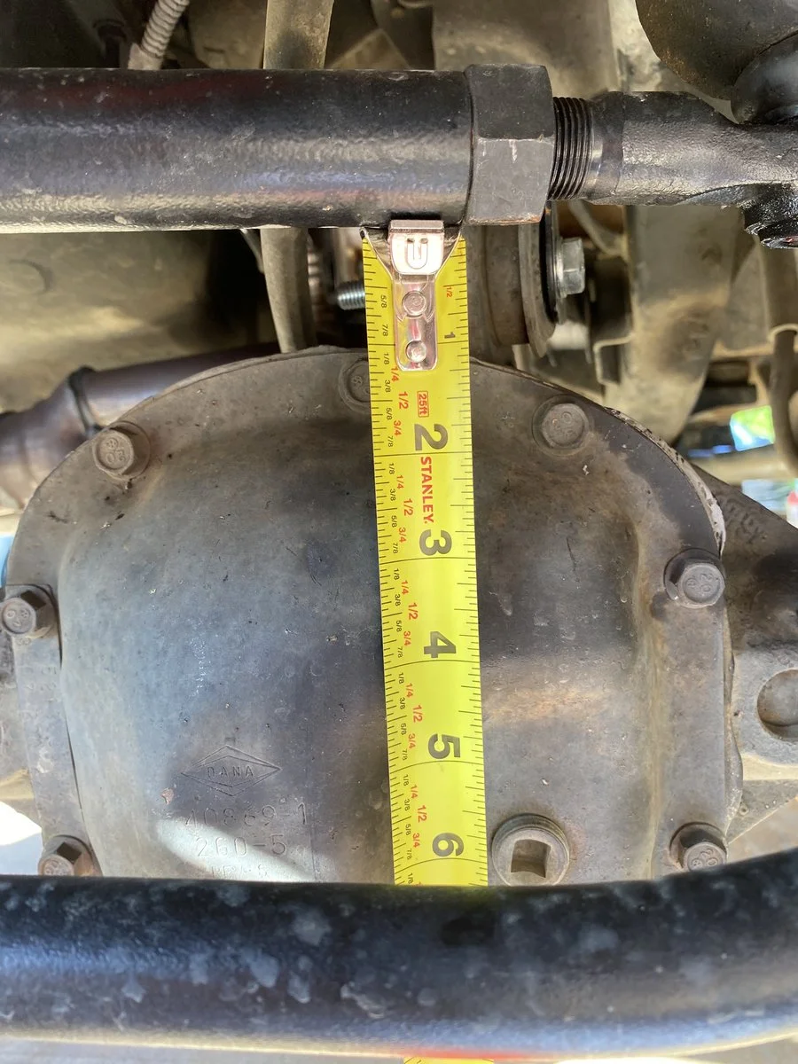

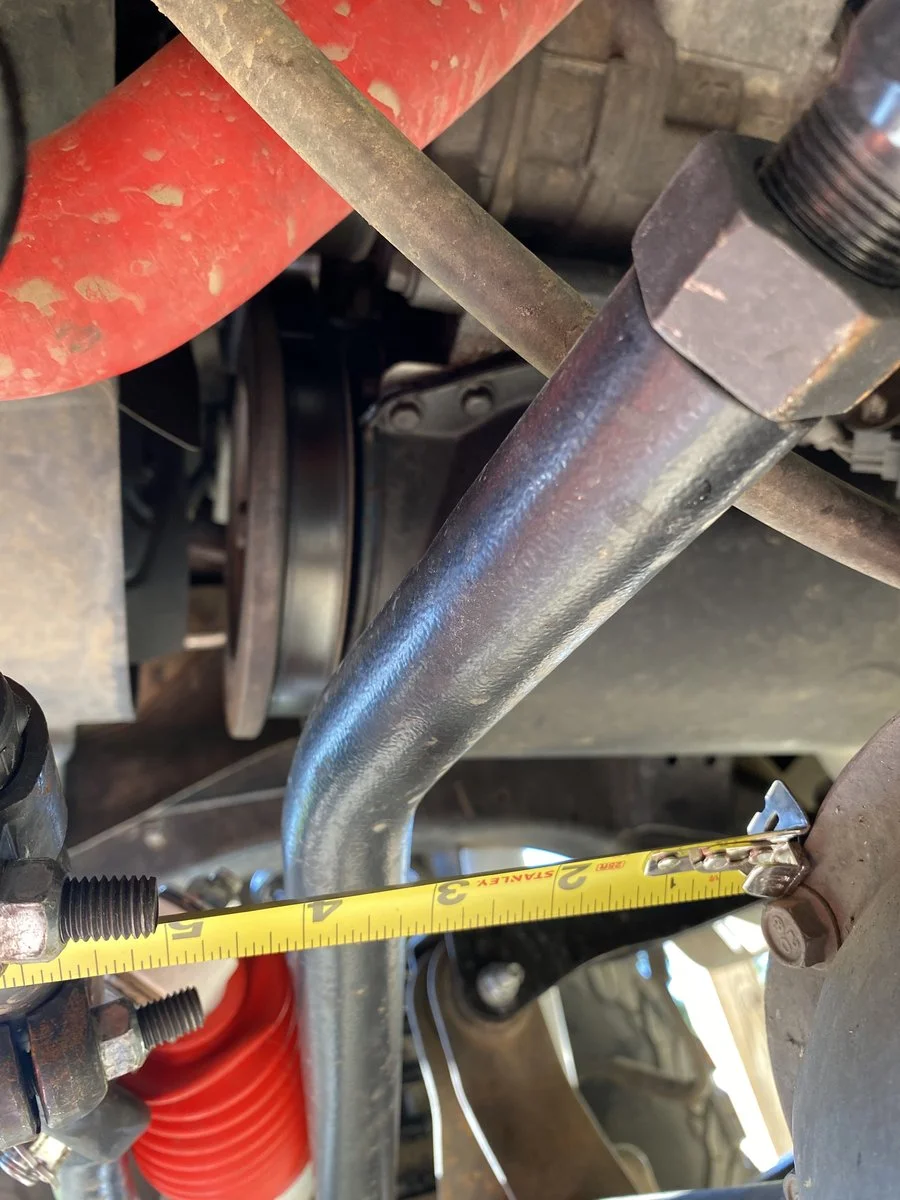

i have a unique situation. and need an offset bar with a joint in that orientation. most are cocked off at that axle joint or arched at odd angles over the diff cover. i need a 3" offset with the joint able to clock the offset forward.
length is not really important i can change that.

I believe it has the arch over the diff cover. I will go out and get some pics of the joints in few minutes
Reactions: someguysjeep
@someguysjeep , don’t know if these will help or not.it does offset some.

I think if you look at the older Rough Country track bar... The one that has the bodacious curve... You might find that it has the clearance you need.
Also that would be an easy type to move the mount forward or make a custom mount. It seems to me.
Good luck and keep us posted with what you got going on
ay, thank you very much that was way more than called for. i appreciate you taking the time.......
yah the 1 pic in that link looked like it was ran the offset out front (red line). but your pics clearly show it's canted up n out (more like green line).
i do appreciate your help. thanx again.
