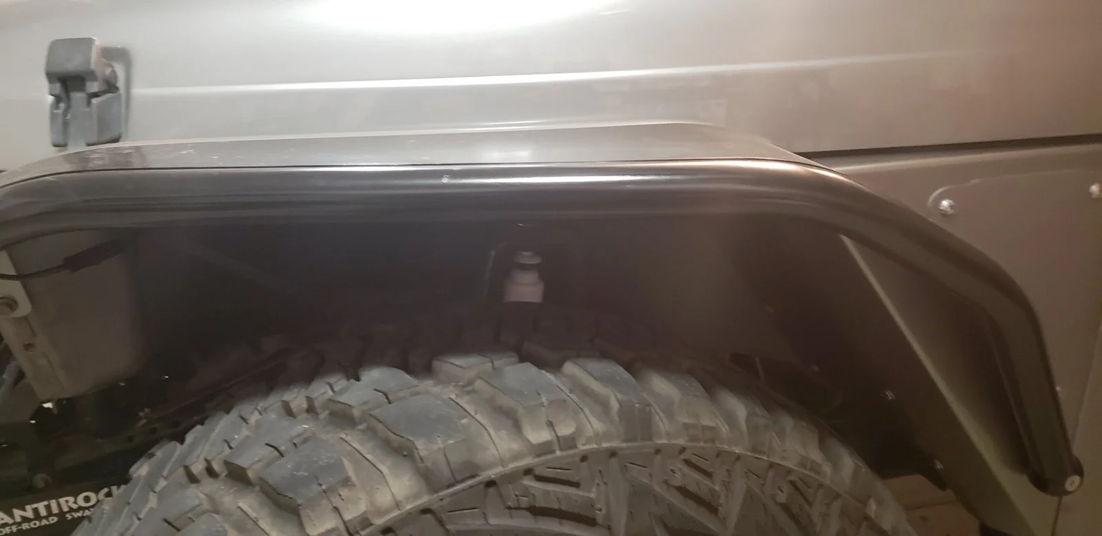

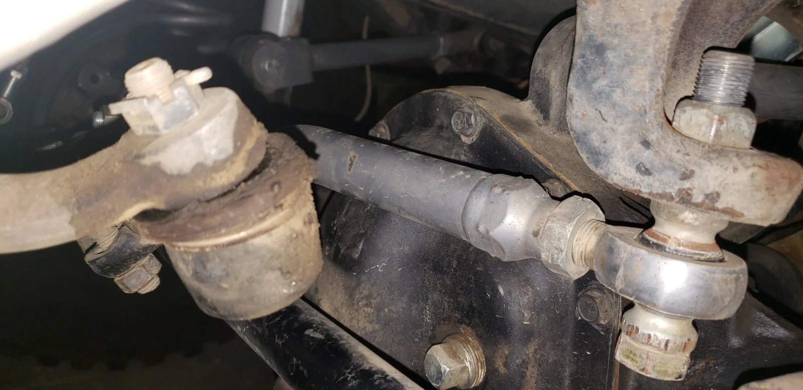

I was measuring my bump stops yesterday and my front track bar contacted the diff cover. You can also see that my shock is about to bottom out as well.
Should I be looking at buying a different track bar (currently have a rubicon express) or should I push the axle back with the adjustable arms to gain clearance?
Also, I think I need to order shocks with a smaller body so I can get more up travel out of them. Thoughts?
Shorten your arms a little. Pull the springs, set the axle at full bump, then adjust the arms so nothing hits. Looks like your tb has rubbed the tie rod as well, or is that mark on the front face of the tb dirt or grease?
I'm not sure what that mark is. I now is the time I really wish I had double adjustable arms.

Jim do you think its worth losing over all travel for increased up travel?
Currently I run the RS55255 which is according to rancho the 3.5 inch lift shock.
As you can see I am maybe a 1/4 of an inch away from bottoming out the shock.

It would depend on what the travel bias is, the amount of bump stop extension and what it is extended for. I run the 55255 on my front, but to use it all with just enough BS extension, I raised the upper mount to fit the compressed length.
View attachment 70682View attachment 70683
Alex, I'd do the trick that Josh did on his and raise the upper mount an inch to gain another inch of up, cause it looks like you still have tire clearance. More uptravel always trumps down IMO.
