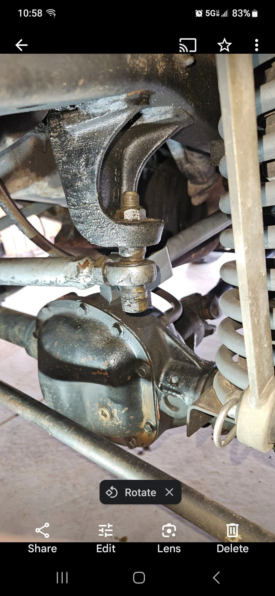

But when I installed it I noticed that the ball joint went to high up into the frame hole mount. The castle nut was all the way tight when too many threads from the bolt were exposed so the cotter pin would have been useless if that makes sense. So I had to ease the tension a little bit to make the cotter pin do it's job. I tried my best to center the axle by reading a bunch of threads on here (bouncing on it, ect) and my drivers side wheel is still too far out. Definetly and inch or so off center.
But anyways, I filled up that ball joint with grease and the whole thing was tight. Immediately felt better driving, especially on bumps and turns. But that only lasted 4 days.... Now the whole things loose and there is play in it. Only thing I can figure is the owner before my had reamed out the frame mount or something for the Hiem joint. I can't tighten it anymore if that makes sense. Definitely doesn't feel safe to drive

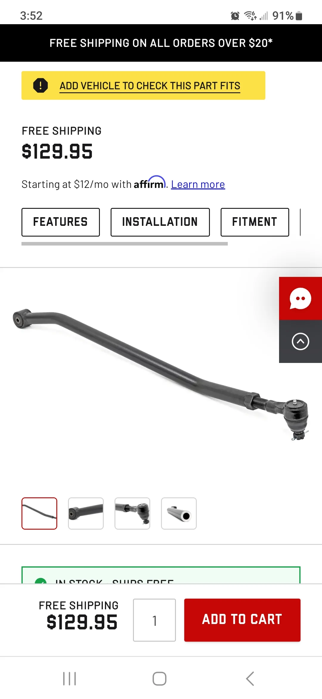

My question is what track bar end can I fit in the mount that that Hiem joint used to be in? What hiem or ball joint will fit in the Rough Country track bar?
I will provide pictures as well. I appreciate all the help I can get.

Assuming your frame side mount has been drilled and can no longer accept a tapered ball joint, I would suggest a JKS bar.
IIRC, the OGS126 uses a 9/16 bolt, and the OGS128 uses a 5/8 bolt.

I doubt the hole is reamed for a taper. I'm sure it's drilled out for a regular bolt.
There's no way the RC joint will stay tight in that hole. Do not drive it that way.

You shouldn't need a heim joint, you just need a joint with a straight bolt instead of a taper. Figure out what diameter bolt your heim joint has and get a trackbar or a joint with the same size bolt.

The end on the RC bar is an ES 3096 , has a 7 degree taper.

Unbolt the current bar at the frame and look to see if it is drilled out. Buy a rockjock or jks bar if it is. If it isn't you can put a washer under the castle nut

Your last option is his best one. The hole has been drilled out straight and they are tough to repair.

Am I the only one who can tell there is a bolt in the picture he posted?

Do we need to assume anything when we can clearly see there is a bolt there?
