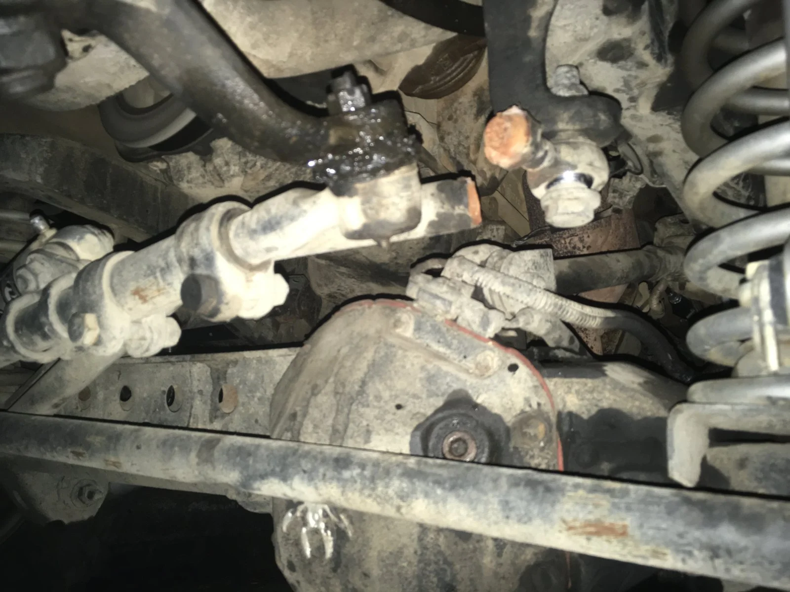

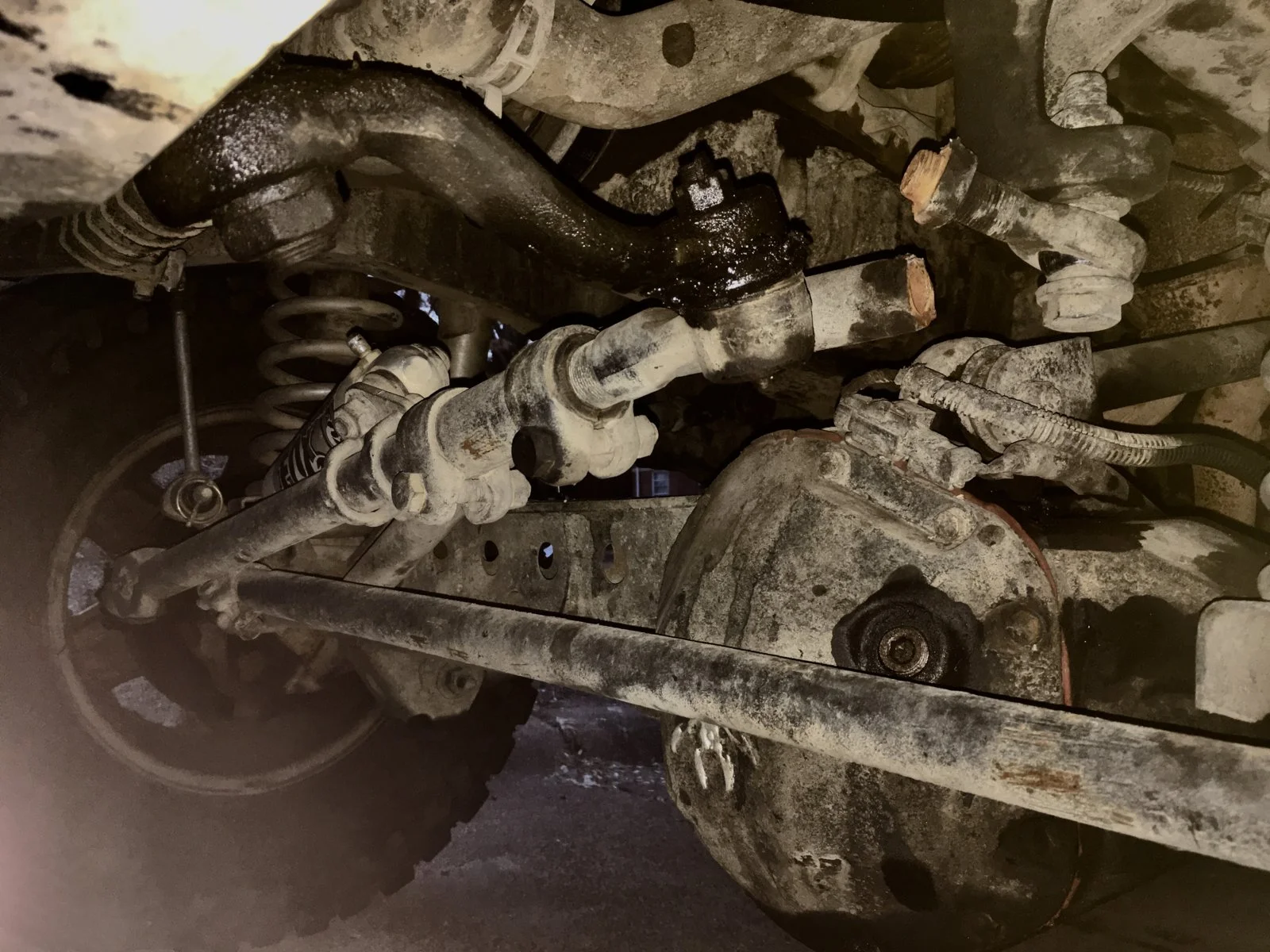

While I was headed to my cousins last night I hit a pot hole and experienced my first death wobble... holy crap was that scary!
I pulled off the road to check it all out really quick and that’s when I got my first Christmas surprise lol. The track bar snapped! I have a beefier steering set up than stock but I’m not exactly sure what the previous owner put in there.
Well now that my track bar has snapped I’m looking at my options...
In my mind I’m contemplating an either an entirely new steering set up like the Currie Currectlync.
i was curious if I should jump for the whole new steering or if I simply needed to get a new track bar. It seems the track bar is separate from the steering sets. Any recommendation with regards to just the track bar if that’s the way to go?
On a semi related note, when I tried to fix my alignment I wasn’t able to get the tie rod to budge at all when ineas using a pipe wrench. I was afraid I would break (on the Jeep or even myself) if I just kept trying to force it.
And my steering gearbox seems to be leaking. I’ve started putting Lucas stop leak in there and dread the thought of both modifying the frame for the older models box or having to find/buy one of those Mercedes gear boxes.
That track bar is too short. You should have a minimum of twice the thread diameter of engagement. It almost looks like a tack weld on the jam nut which I bet was because the previous owner had issues with it coming loose.
That’s exactly it. I didn’t even notice that when I was down there. I just went back and sure enough I can see it’s a clean break all around and that it looks to be a broken weld.

Make sure to check for clearance between the trackbar and the diff cover as well. Some aftermarket trackbars are known to contact the stock cover if additional bump stop hasn't been added, and where it appears you have an aftermarket diff cover, you could have even less room. The trackbar making contact with the cover is known to snap the trackbars just like you have pictured also.
There was no contact before it broke but I suppose that could have been the cause with all the jostling around. Outside of trial and error with each different track bar set up, is there a good way to figure out if it will be an issue before hand?
