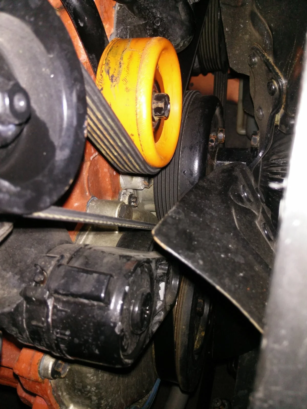

A possibility that has, interestingly, come up twice recently, is the possibility of a too-long belt. Take a look at the belt where it pases by itself when it runs over the idler. It should look something like this with about 1 - 1.3 inches distance at the closest point. If it's much less, your belt is too long and the tensioner can't keep it tight enough to grip.
I had this problem and resolved it with a Dayco Poly Rib 5060883 belt.
P.S. The fact that the sound changes when spraying water would also lend credence to this theory as most bearings (unless they're REALLY bad) will not react immediately to water spray).
P.P.S. Also look for signs of oil contaminations on the belts or pulleys (I think you've already done this, but just checking).
EDIT: just realized I didn't attach the picture...here 'tis.

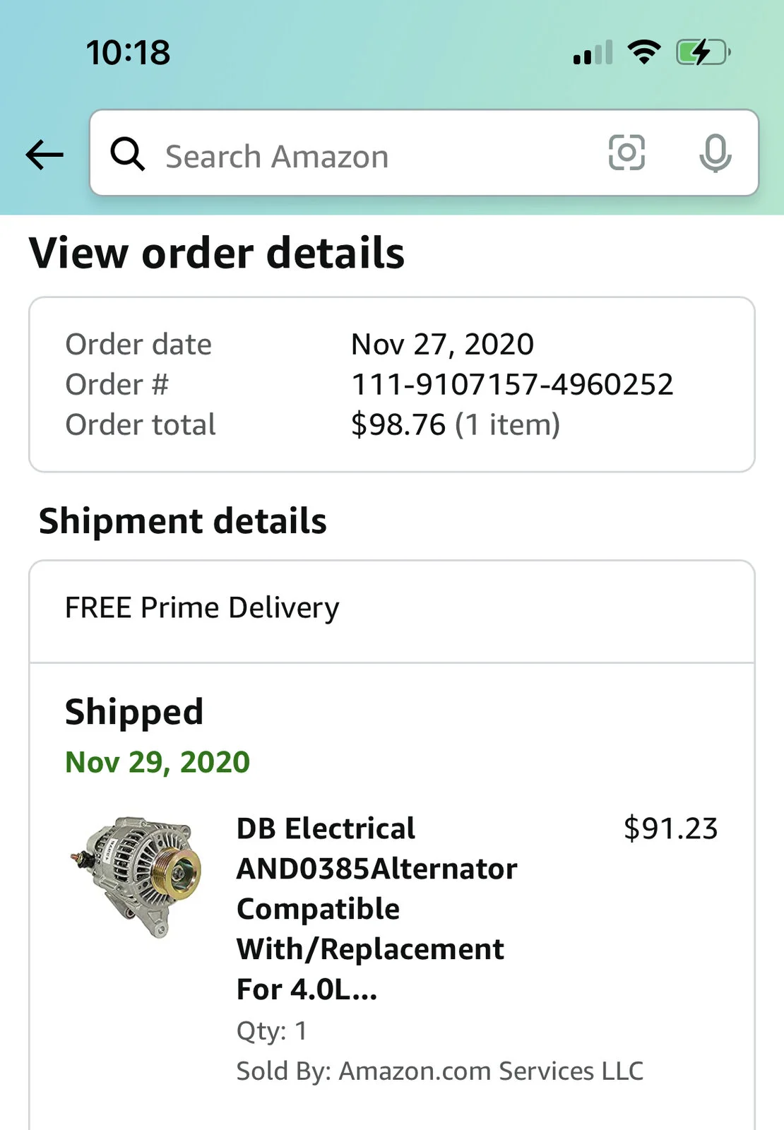

I bought this Db Electric to replace my Alternator and it’s run my battery fine with my 6 Halogen KC’s and Hogh output headlights. I’m not sure it hurts, but I got a lot of advice that the high output alternator isn’t really necessary for my 1 battery setup etc.
