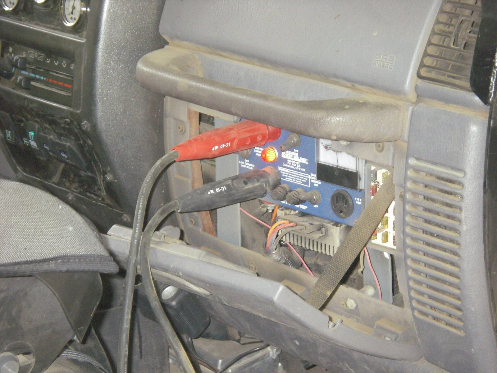

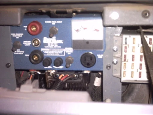

I have the Premier Power welder installed in my glove box since I'd rean out of room under the hood.

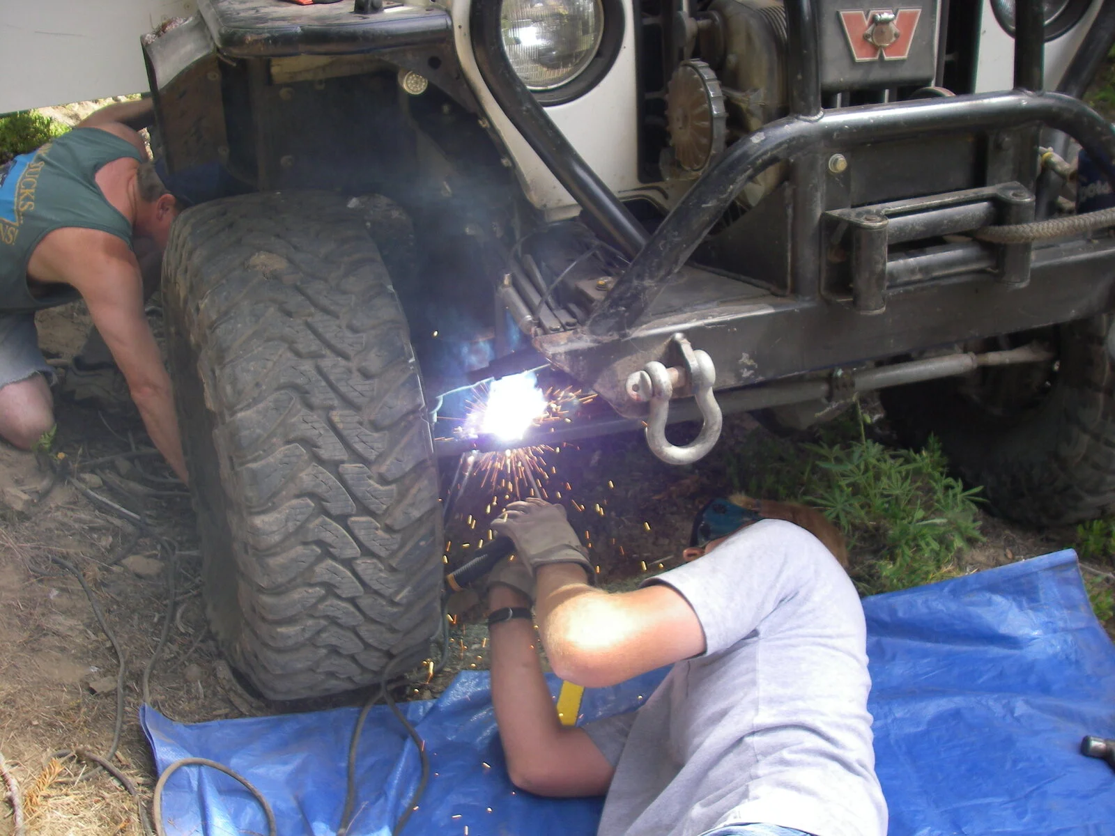

Doing repairs on my own Jeep. My trackbar/hydro assist cylinder came loose.

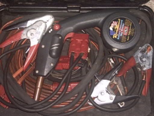

I'd lucked out and found a Ready Weleder for cheap that a local farmer was selling. But I'd already ordered the Premier Power welder so I have both now.

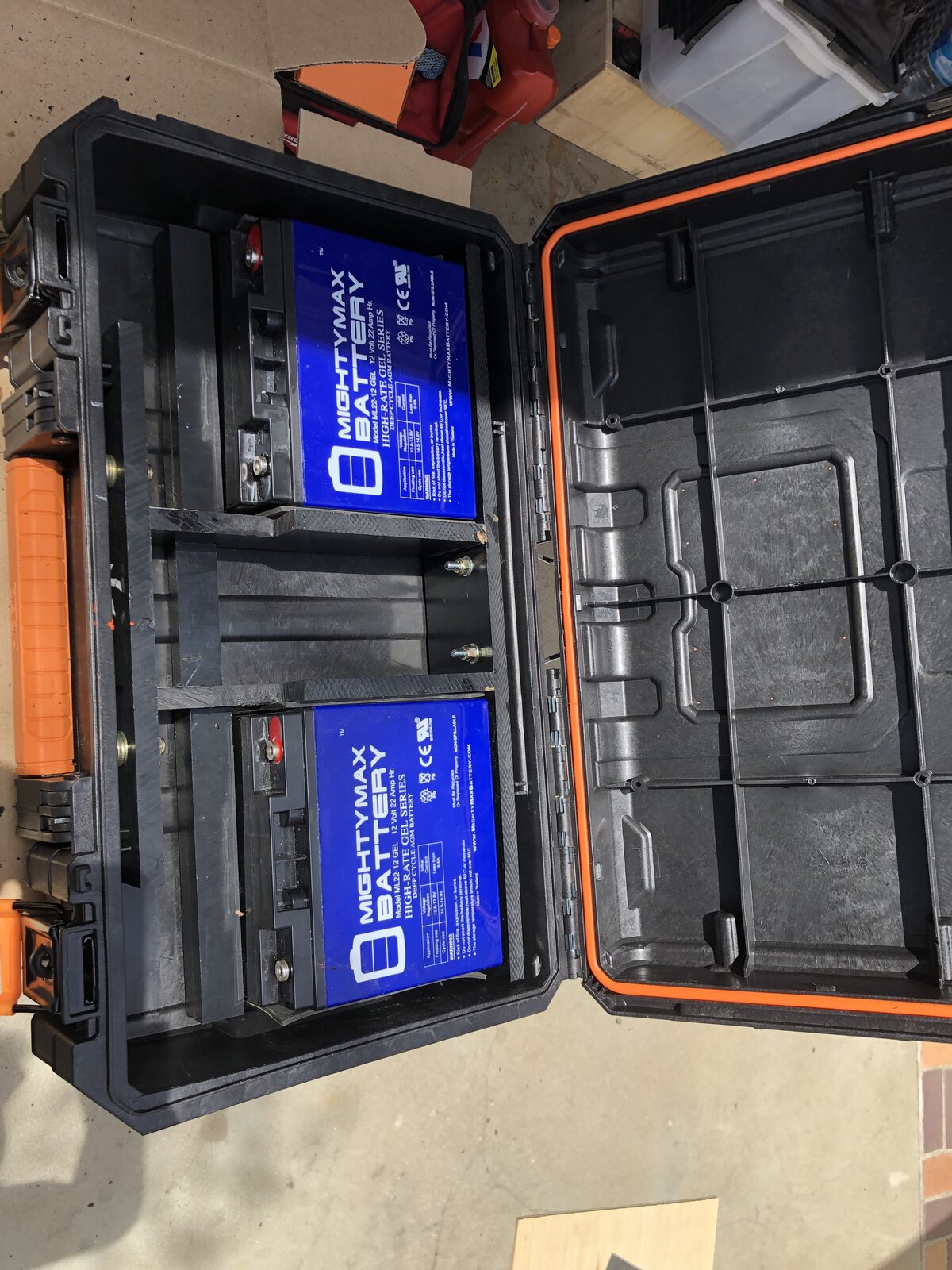

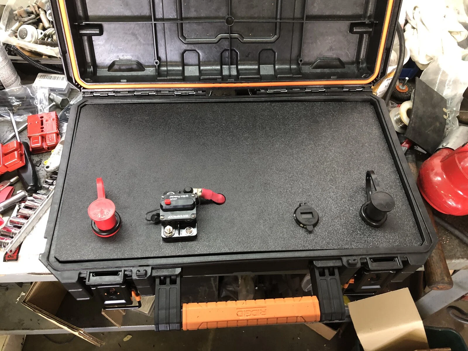

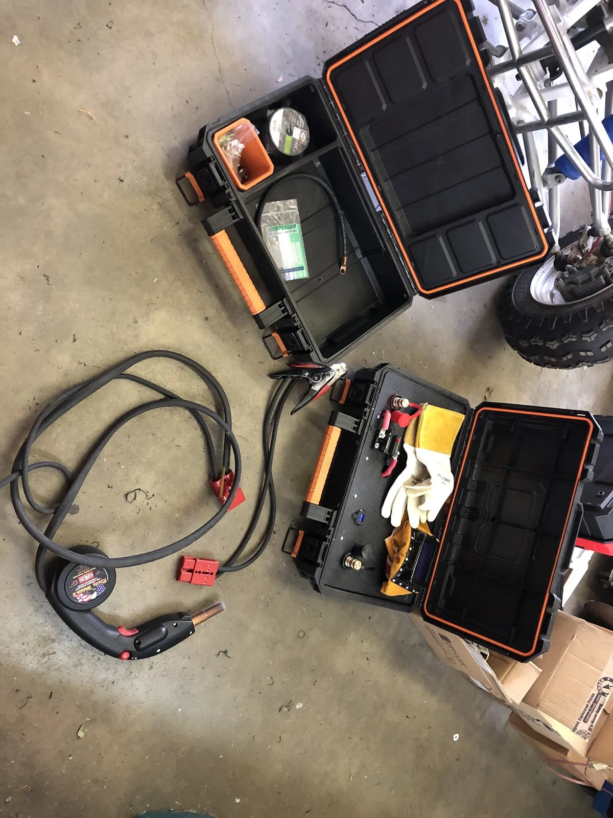

I picked up a ready welder a few years ago, it works great burns hot! I was in Moab with a buddy who had one and he made a battery pack for his. I had to have one so I built one when I got home. Makes it real easy, pull 2 cases out, hook up cables, weld and go.
