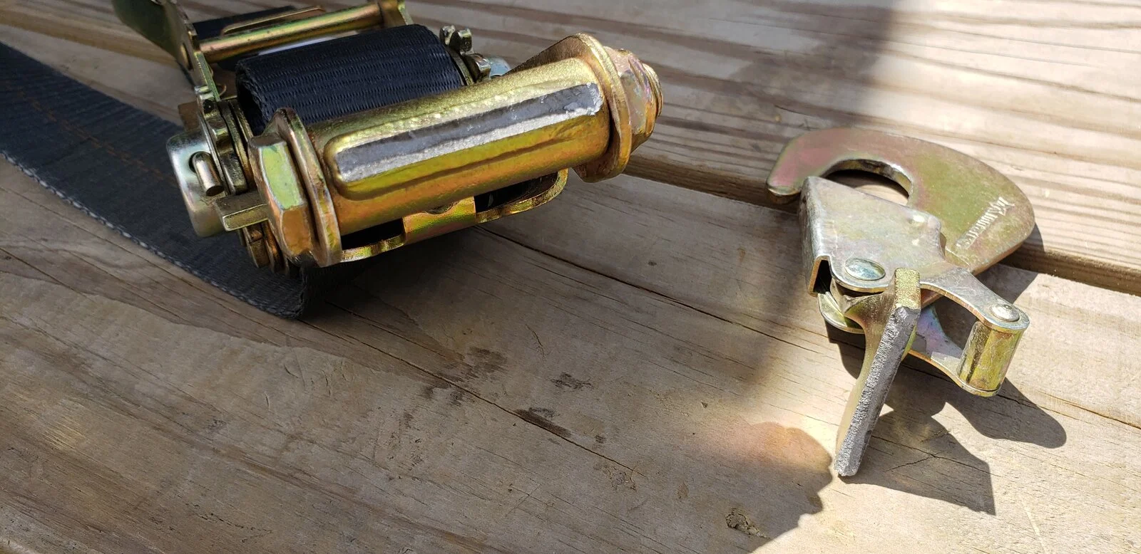

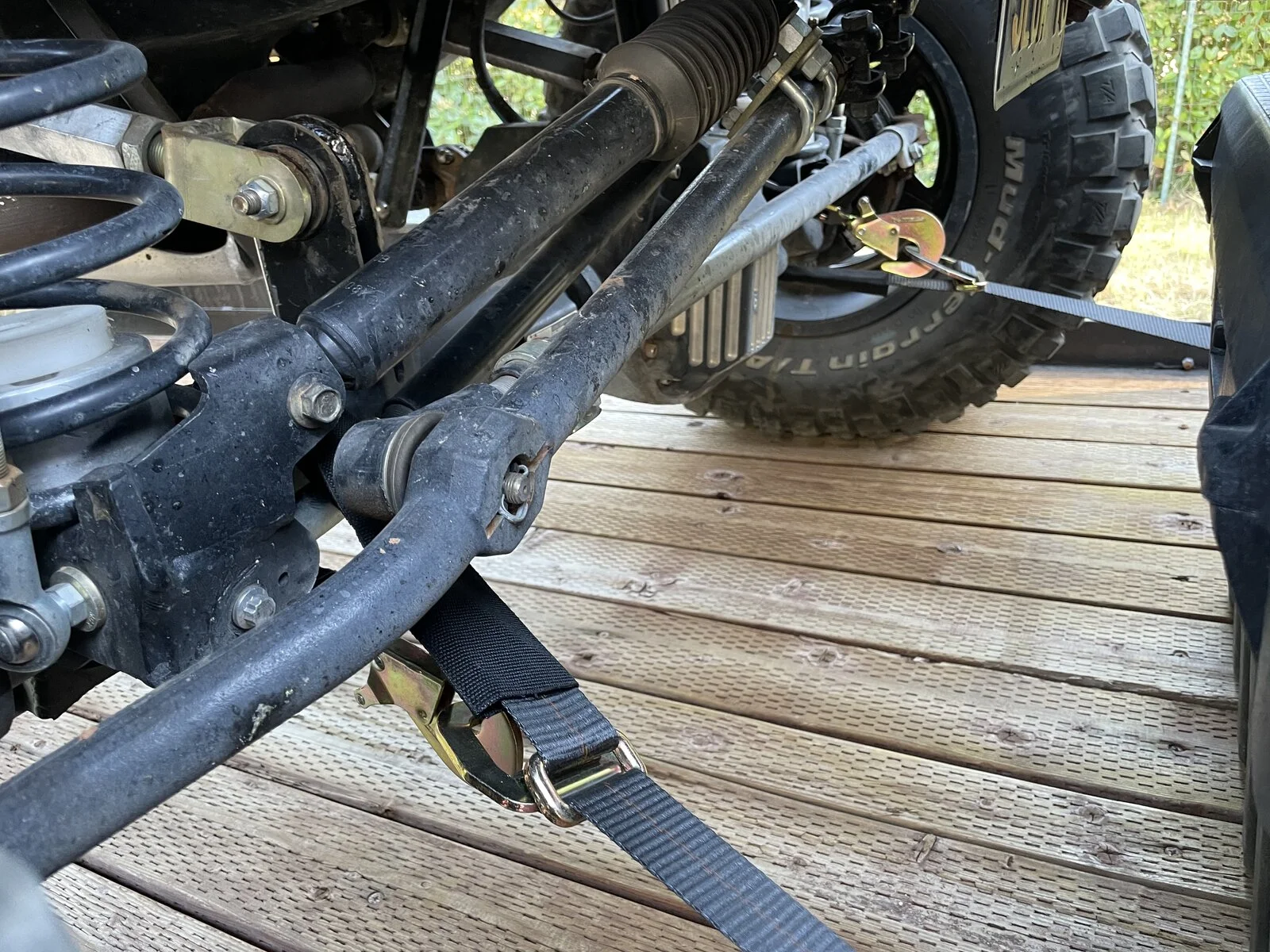

I purchased the Mac’s Super Pack tie down kit to replace my old cargo straps, the cargo straps were ok for strapping the Jeep down but I had to use axle straps and the sewn in hooks on the ratchet end were long and different length, they made it challenging to attach to the trailer and keep the ratchet out from under the rig.
https://www.macscustomtiedowns.com/...e-down-kit-with-integrated-axle-straps-511106
The Super Pack offers a hook on the ratchet which allowed me to keep the ratchet out from under the vehicle and was easy to use with the tie ins on my trailer and they have an adjustable length axle strap that is sleeved to protect the strap, you can also use it as a standard strap if you choose. The 2” straps are #10,000 rated and come in different colors and two lengths of your choice (6’, 8’, or two of each) I got the 8’ straps but could have gotten the 6’ and not have to deal with the excess strap (about 3’ with my setup). The kit comes with a bag and straps to secure the excess strap to the ratchet handle in the closed position (my preference) which keeps the tails from whipping around in the wind and random hands from easily loosening your load. The integrated axle strap was a real plus for me and I only re-tensioned the straps once on the way to Moab and didn’t have to at all on the return. I realize there are other brands out there but these were what I bought and I’m just passing on what I learned, so for me it’s two thumbs up for the Mac’s Super Pack 👍🏻 👍🏻

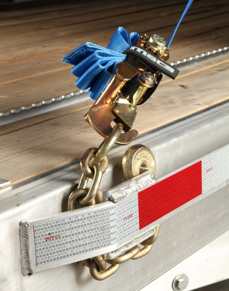

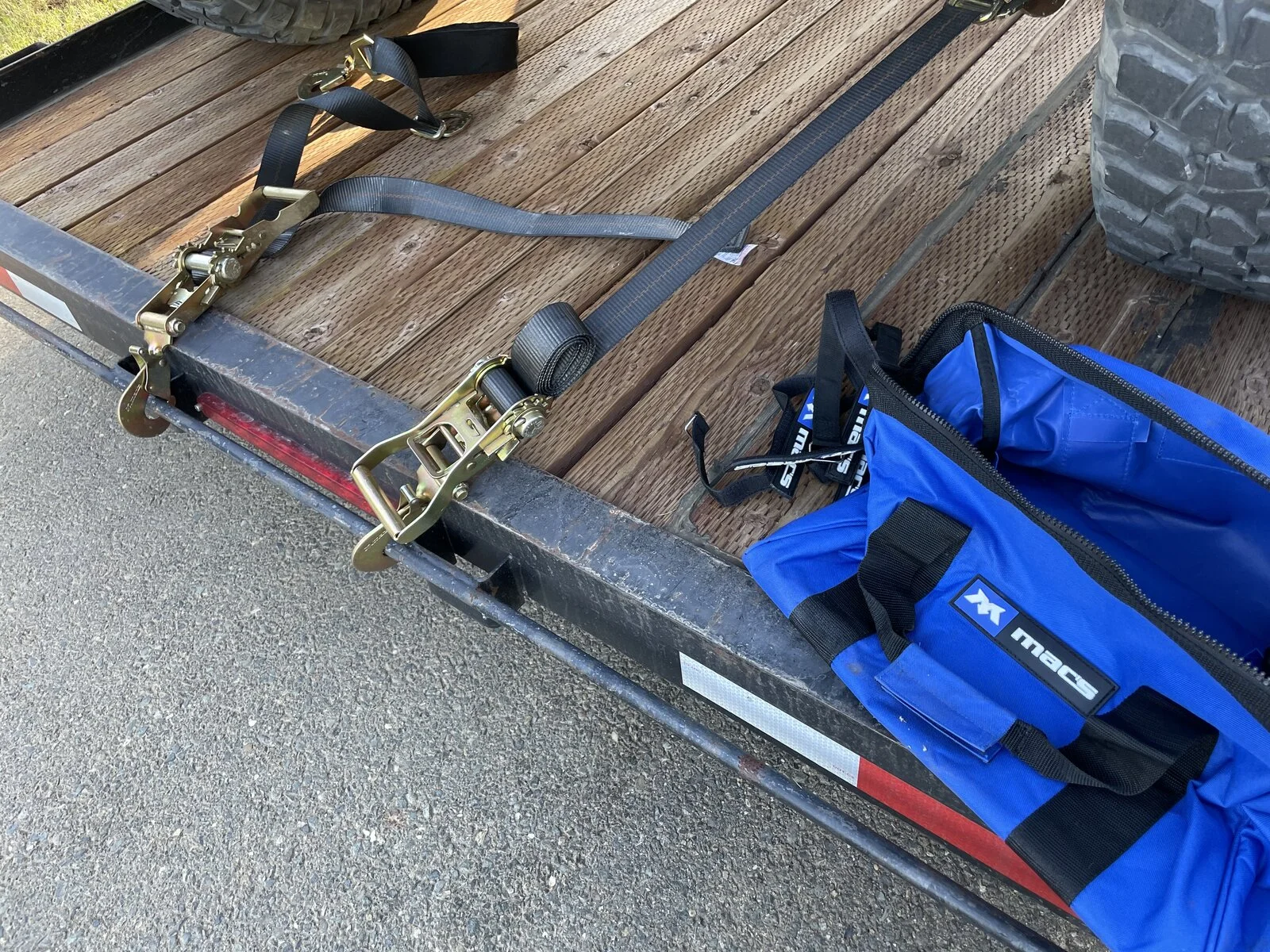

But I'm concerned with this picture If you're putting any stress on that area above the hook where it looks to be hitting the trailer I'd be worried. Eventually you'll break one. @MagnumV8 just broke one in that same spot. You need the macs d-ring on a chain hook for those stake pockets.
Love my MAC setup. Just ordered a set for a dirtbike too, delivery next week.
or something like these: https://www.amazon.com/gp/product/B07B3VPHNY/?tag=wranglerorg-20
The chains fit in the bag easier ;) if you pull them. those would also hang down on the rear of the trailer and may drag.
they don't hang down, they sit above the pocket... and I don't remove them from the trailer so they don't take any space in the bag :)
The pin has to be below the stake pocket so it has to stick out the bottom.

Here is what happened to mine on only it's 3rd use. All 3 times it was used in a straight pull, never hooked over the edge. My D rings are above the deck.
