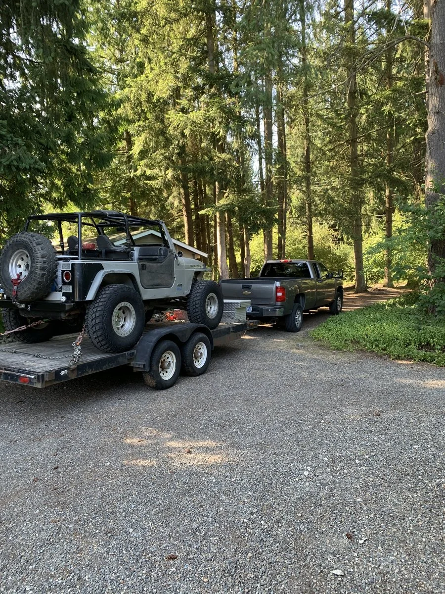

Just curious on how other people who trailer their Jeeps on how you tie it down.
I’m always looking for different, faster, easier ways to load my Jeep on the trailer. The group I wheel with all seem to have different methods like straps or chain. Axles or frame. Over tires with straps or baskets. Cross or straight.
Currently I use axle straps connected to chain and binders, the front go straight and I cross the rear (last time I didn’t cross the rear I rubbed both rear shocks and blew out the seals) and sometimes straight back depending on what’s all in the trailer and where the Jeep is sitting
I’m also looking since I have to replace my axle straps due to wear.
I also am a believer that there is more than one correct way to tie down a rig so I’m not looking to start any arguments on this subject as I’ve seen threads like this go downhill real fast. Just looking for new better ideas.
Here’s mine

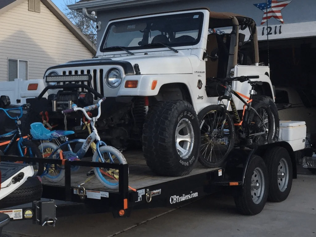

I usually don't cross because I have other crap on the trailer. I use axle straps too, that way I can feed them under the rear brake line. On the front (if I remember right, the TJ sits over the winter) I feed the axle straps though the bottom shock perch. I don't use chains though, I use 10k straps going to my tie downs.
Never felt comfortable tying down by the frame... I watch it bounce all day long in my rearview.
Edit: One thing that I do which I think is a good idea (if you have a better one please share) with these straps at the tie down point is to make sure you fasten them somehow to the D-ring. You can see here in my pic that the straps I have are an open hook (D-ring under my daughters blue bike), so God forbid something shifted enough on the road that hook can come off. After I ratchet it all down I clip on some large open chainlinks through the D-ring and the back part of the strap hook to make sure they can't separate if the straps slack.

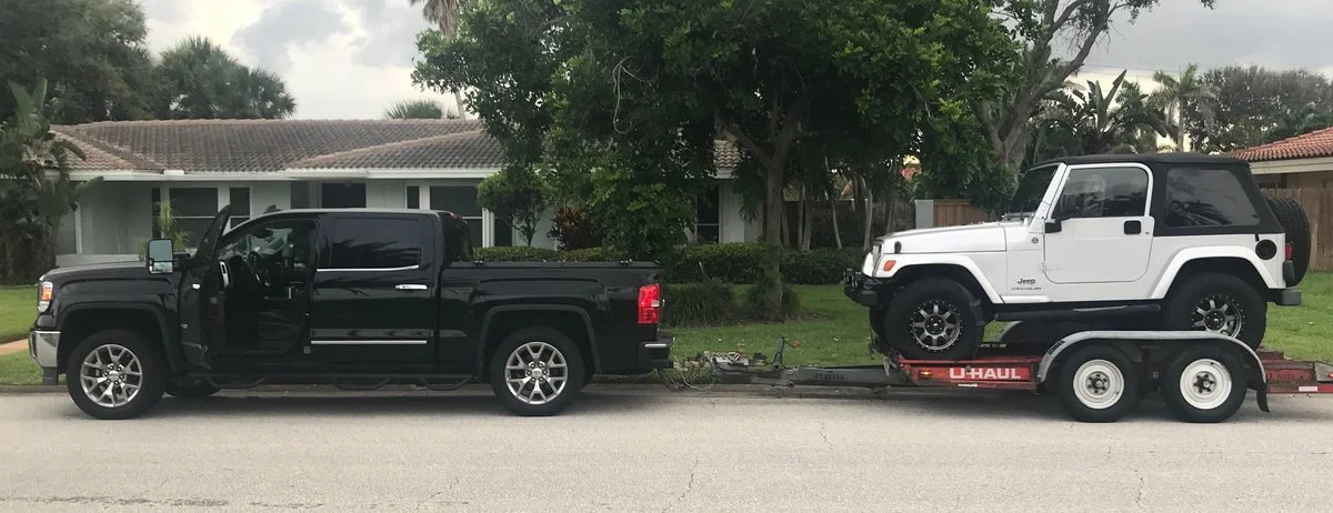

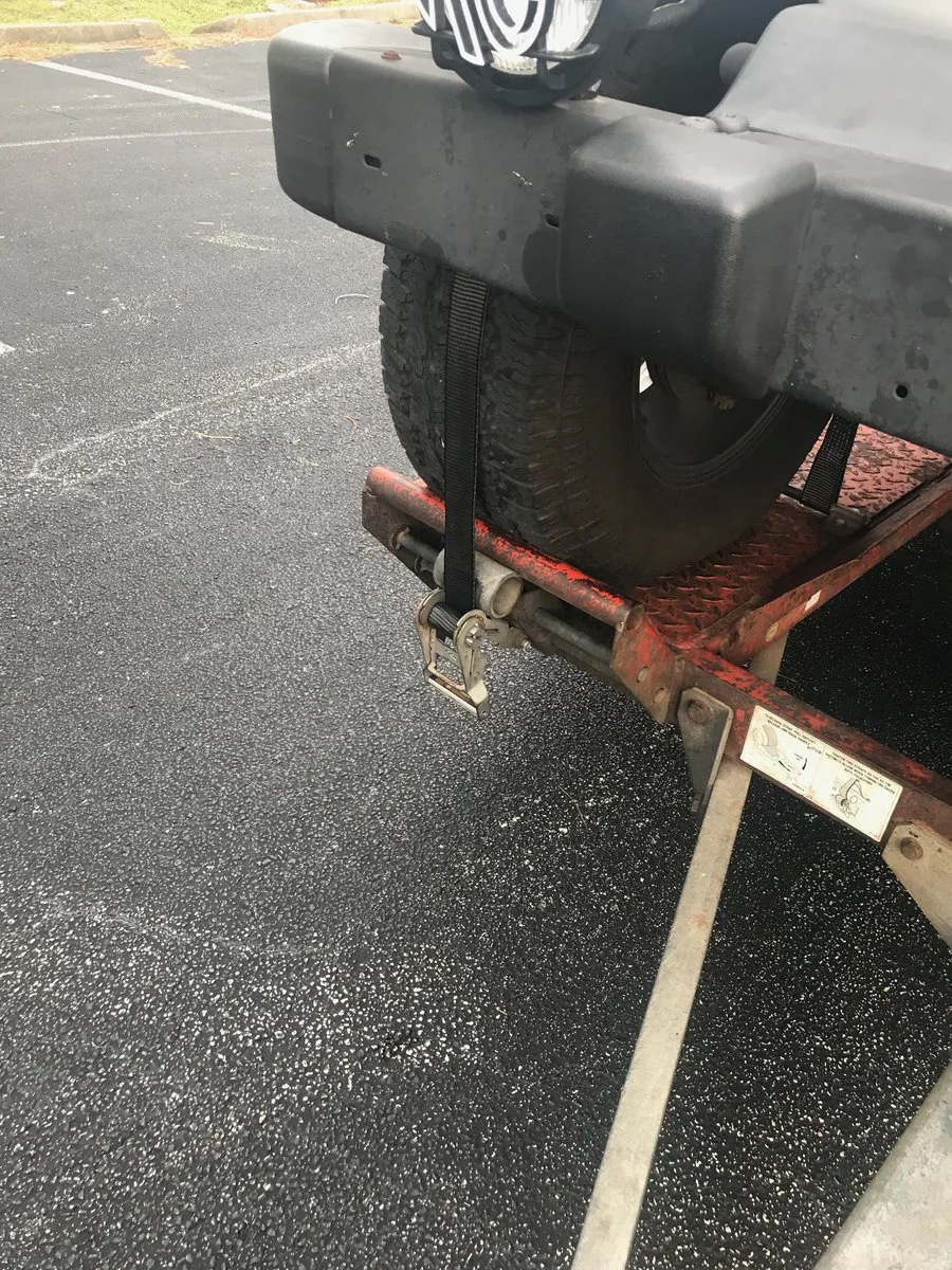

When I bought my Jeep I trailered it home on a UHaul trailer. It had basket straps for the front tires and only a safety chain that could not be tightened for the rear axle. The basket straps were too short for the 33" tires. We had to air down the front tires and use other straps to compress the tires so we could get the basket straps into the ratchet mechanism. Had I known any of this I would have brought my own straps. It did just fine and did not move at all.
UHaul actually has it the closest to the best way you can do it of any I've seen so far.

I've checked the website a few times and after selecting the tow vehicle and vehicle to be towed (a Jeep) it says it is approved. Obviously the straps on the U haul trailer I had were not made for 33" tires but I got it to work, barely.
