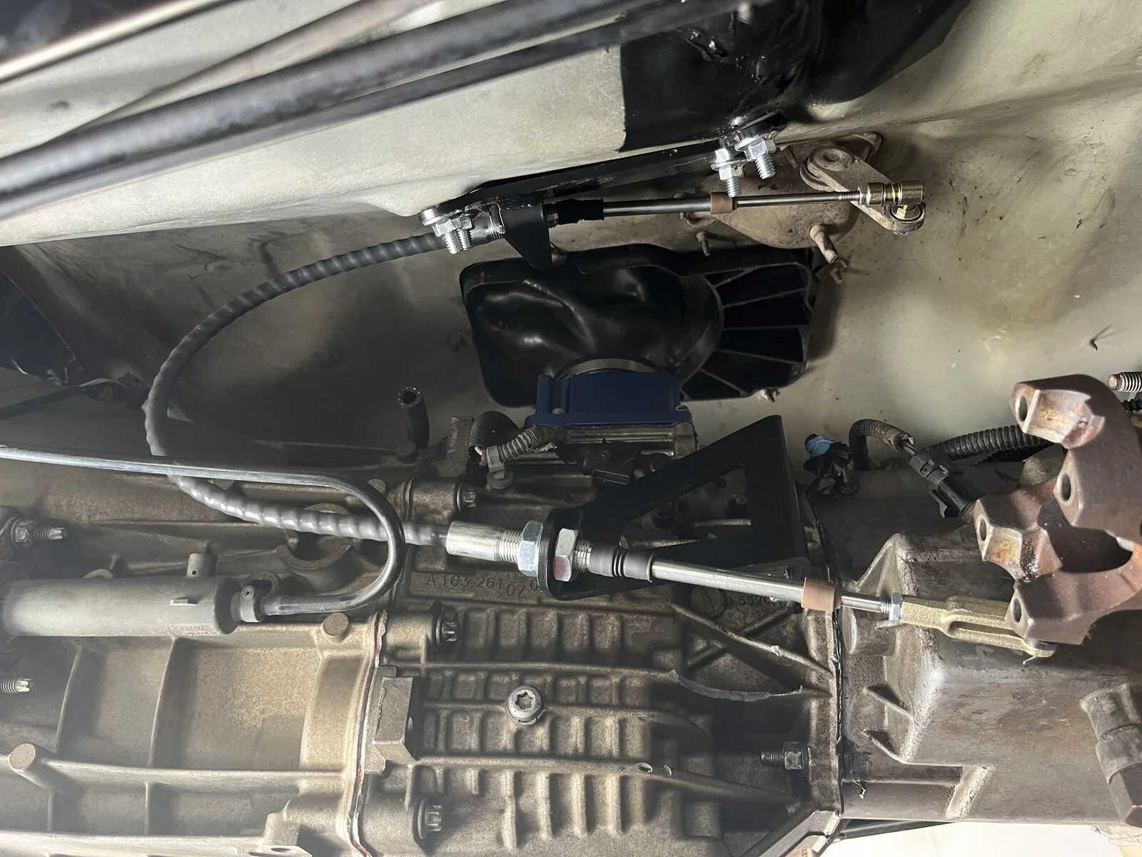

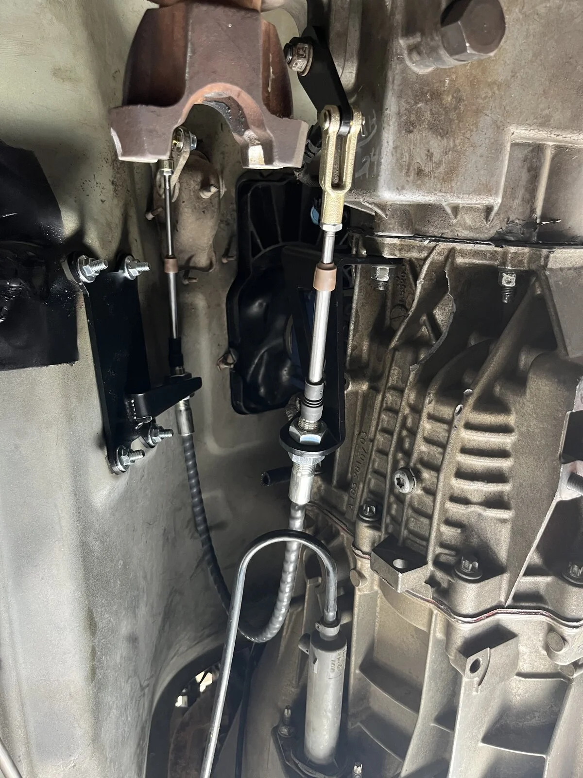

Transfer case linkage adjustment questions
Not enough of a difference to be worth the coin at the time I did it. My factory shifter was in good condition, and shifted solidly. The factory shifter is easier to adjust as well.
Cool, I found differently, but I get it. My linkage getting it off and on a couple times, was kinking but inhad a lift and didn’t like it for some reason.
Don't get me wrong the Savvy is a nice piece. Just don't expect a huge difference from a good OEM to the Savvy. It's over-recommended in my opinion.
Do you have any video or tutorial on how to adjust the factory one?
There is one on YouTube- it’s just a 13 mm bolt on the rod you loosen that and throw the lever till it’s firmly in four-wheel-drive lo or 2 wheelndrive and snug the 13mm nut
If it’s a Rubicon you roll the lever backward basically clockwise and a- non Rubicon you roll the louvre down - counter clockwise for 4 lo on each -
