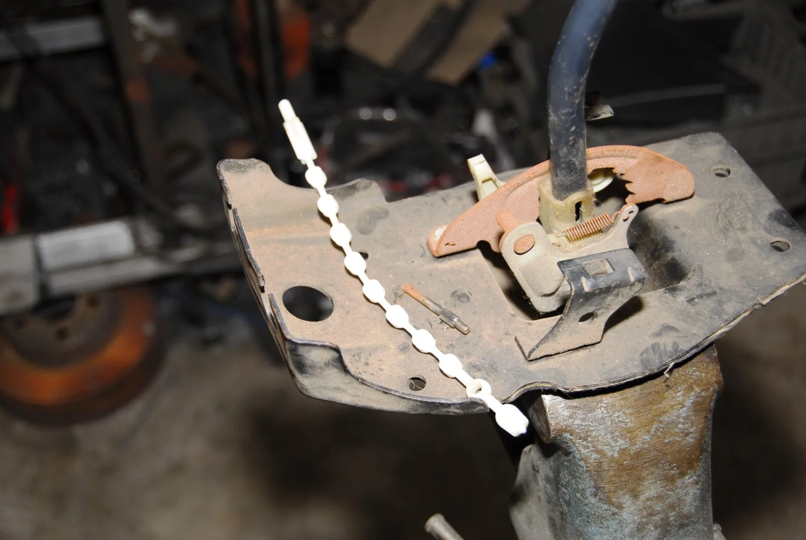

This piece broke on my Jeep under the shift selector. I put a piece of pipe in its place for now to get the transmission to shift. I couldn’t find the part to purchase. Anyone know where I can buy one

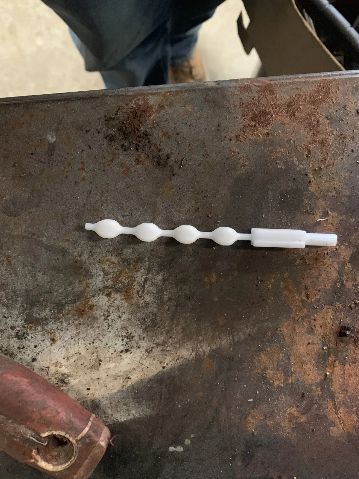

Mine broke within the first year of ownership. Over 60k miles later the metal rod is still working great.
I have discovered a very easy fix for that but likely not what most have laying around. If you measure the distance between two of the beads in the unbroken section, you can use that to cut a small piece of plastic air line and drop it in the shifter handle. It will fit between the two beads and keep them from bypassing so the shifter works perfectly again. I used some that was 1/4" ID which made the OD large enough that the small cylinder wouldn't tip over sideways in the shifter tube. If you wanted, you could stick a dab of silicone on the broken end you have out to hold the piece of tubing in place. The diameter has to be small enough that the beads won't go down inside, large enough so it won't tip over when you push the button.

Those for sale aren't broken but I agree those rods that probably cost five cents to manufacture are grossly overpriced. Some only want to install what was in there and aren't sure their "fabrication" skills are up to making a chopstick, plastic rod, etc. work without causing a problem.

Ya I left the bottom in and used a flared piece of brake line but it seems harder to push in than it did from before the repair
Now you're going to make me pull one apart to check it. Last time I looked at one with an eye on replacing just the beaded rod, there was a roll pin at the bottom of the shifter handle that hand to be driven out so the rod would come out. I don't see that hole in the ones in the pics so now I have to check one more thing.
