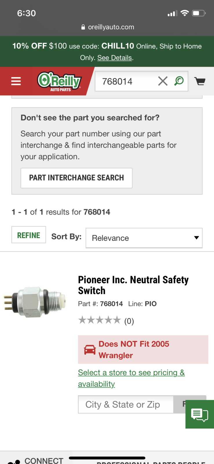

Oh I was just curious. Ya I was trying to look for the neutral safety switch to see where it was and how to test it. I’ve been through the entire transmission control wiring diagram and the starter motor wiring diagrams and I just can’t seem to find it. I do see that there is a clutch neutral safety switch but that would only be for a manual transmission right? Do you happen to have that oreillys part number by chance?
I just checked that number. It doesn’t say it fits a 2005 wrangler
