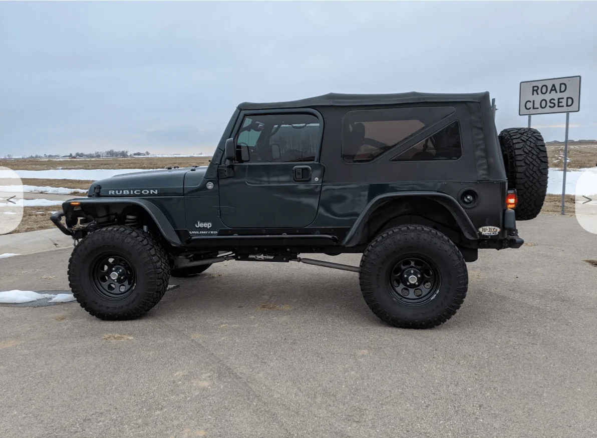

I have a similar but different questions I just bought a 2006 unlimited rubicon in Colorado with both soft and hard tops. The soft top is currently installed. I am picking it up to drive it back to Minnesota this weekend. If I remove the soft top and put the hard top on, will the soft top with all of its framing and hardware fit in the back of the jeep?

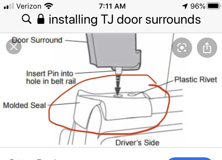

Make sure the “mucket” seals remain in place when you remove the surrounds. Some are held in place with a plastic rivet some are not, this is where lots of folks have leaks, either from damage or getting lost. Also get all the fasteners in loosely and align everything before latching the top and tightening the hardware.

It'd be nice to see your new LJR as well. When I started looking for a new Jeep in 2011-2012, I could not find any clean TJs around the Twin Cities - every single one had serious rust issues. After looking for months, I finally decided to just buy a new JK instead but while I was at Park Jeep I looked at an '05 LJ they had and found that it had just come up from Arkansas. I couldn't pass up a perfectly clean LJ so that's what I bought instead.
