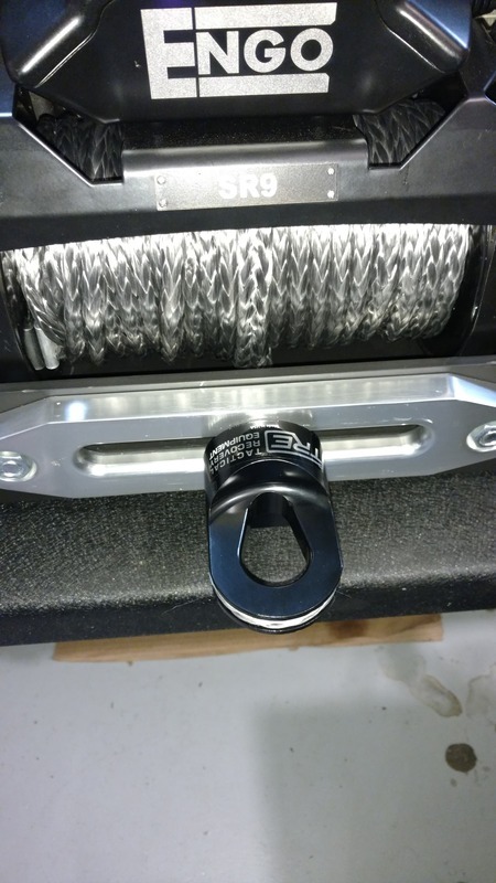

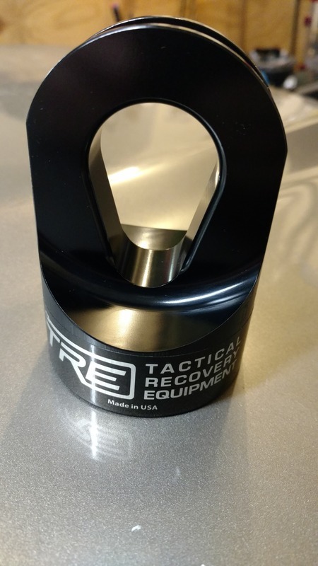

OK, so I received the thimble from TRE today. Beefy piece of kit.

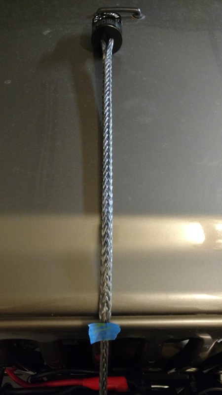

The install went far too easy. I was able to pull the line from inside itself, no cutting, and it was already tapered and ready for install. I used the fid that came with and fed the line back into itself like the videos show. The rec for 3/8" line was 3 and I ended up with close to 4 fid. The tape is the end of the line.
So, did I do it correctly?? It seemed far to easy. I get that it tightens onto itself but nothing else needs to be done? It literally took 5 mins to install. When something goes that easy, I get nervous. I guess I will pull something and find out :D

You did it correctly. You have what appears to be too much bury but that won't hurt anything. What I would like to see is the transition smoothed out at the end of the buried tail with a much longer taper. The change is a bit more abrupt than I like to see. The sharper transition loads the fibers unevenly in that area and can lead to them breaking and causing a weak point in the line.
I like to see about 6" of taper from 2 strands to the full number.

Thanks Blaine. I will work on smoothing out the taper. Good part is, it comes back apart with little effort.

A lot of knot snobs have argued that the reason for the lock stitch is to get the splice up to full strength and in reality, it's simply a vandalism resistant stitch. Once you load the thimble, the line locks in, takes a set, and is much harder to get apart after that. It isn't a struggle but you'll be able to tell it isn't going any where.
Reactions: Rob5589
I don't understand the point of such a device. Is it safer than a hook because a hook can possibly bend completely open?
A hook will go through a roller fairlead. If you are holding onto the hook, the hook will go through the fairlead and take your fingers and hand with it. The collar that integral to the bottom of the Safety Thimble is something I came up with after watching a video of a competitor getting his hand sucked through the fairlead when the winch solenoids stuck powering in.
That and a shackle is the safest method for attaching to stuff, steel or soft. The connection is positive and intentional. Before the advent of safety hooks with latches, we used to take electrical tape across the opening of the hook to keep them attached to stuff in an intentional and positive manner. Most of the folks who understood safe recovery were just using a tube thimble with a shackle but that still didn't stop the thimble from going through the fairlead. I fixed that with the Safety Thimble.
