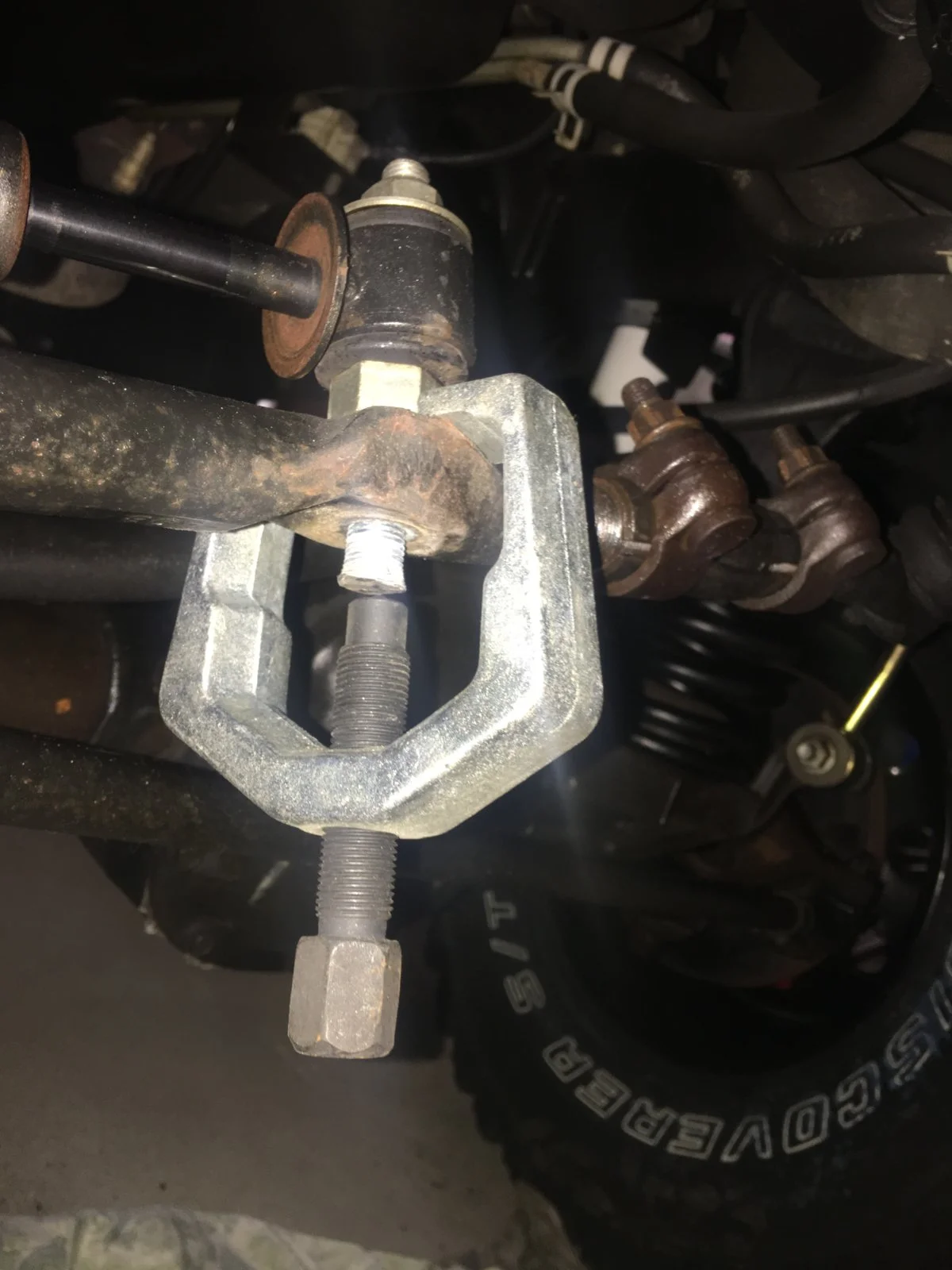

So I ignorantly ignored the many threads on about how to not hit the bolt (as it will mushroom) and to whack the side of the tie-arm to pop the bolt free. Of course I just hit the bolt thinking it'll pop right out....not a chance :(
So after torch heating, banging with heavy hammer and trying everything I could think of doing...it wouldn't budge. Then I found a youtube video with a guy ("Jeep Pickle") showing his "tip" for removal...using a tie-rod removeal tool. IT WORKED GREAT! So I'd thought I share his video and my pics.
PS I would still heat up the bolt as it no doubt still makes it easier to remove.

That is good advice. However, I can honestly say that that method would not work on this tapered bolt. Or at least on mine anyway. I saw how much pressure it took even with the tie-rod puller AND with torch heat...there was no way I was hitting that bolt out. The nut would have stripped the threads before coming close to moving the bolt.

I've used the puller with good success on several different jobs. When the puller is loaded up with force spray some penetrating oil on the tapered bolt junction, let sit and then hit with small maul. That usually pops it loose. When re-installing new one, coat with Never Seize.

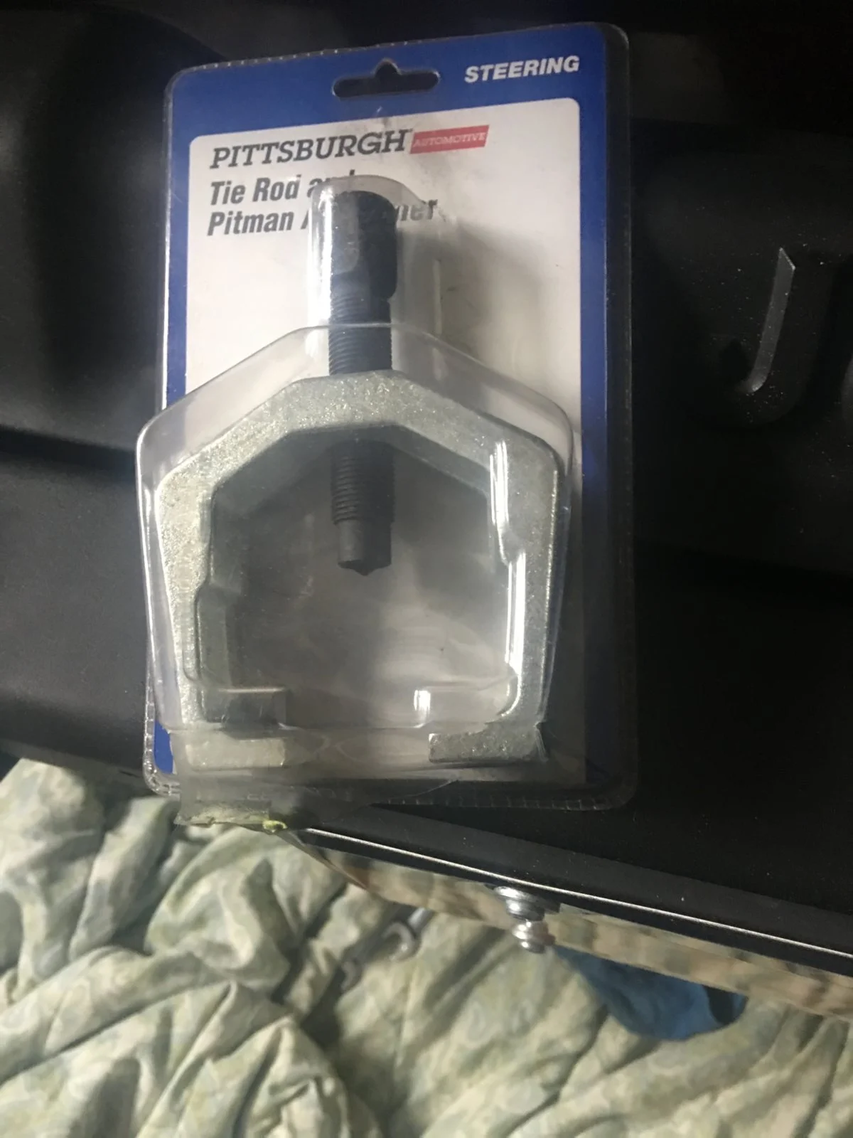

I used this from Advance Auto Parts. Quick and easy. Also used it on the sway bars links, where they attach to the sway bar.
