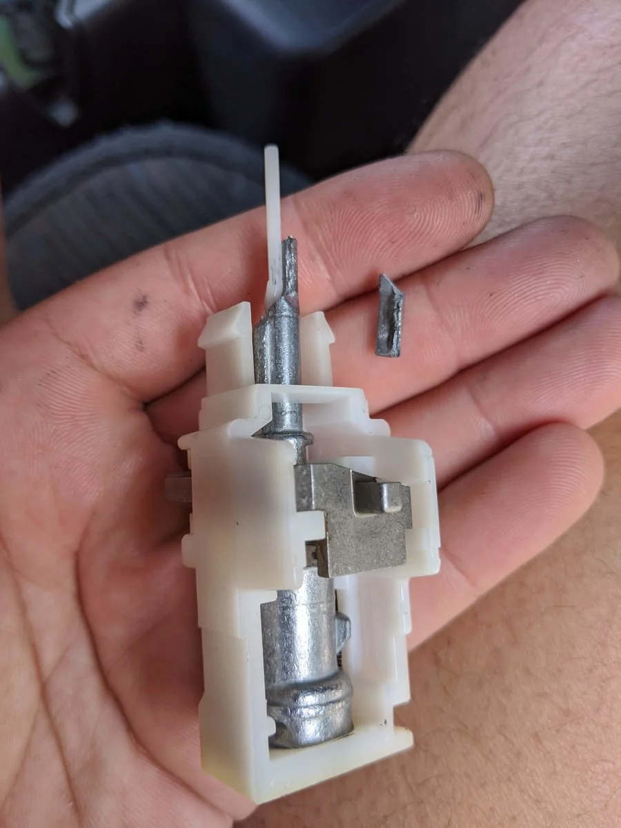

Thanks for the help, I took my ignition switch lock cylinder out but it seems fine so i'm gonna leave that for now. After taking this out I then took the actuator pin out and found out the metal surround was broken shown by the picture below.
I assume this is what was blocking the key from turning to the ignition spring return position but would this be related to the issues I had starting it before it broke completely? Before it broke, it felt like i had full range of motion in the ignition switch but it still took 2-3 tries at turning it over to start.
I'll be replacing this and I've heard replacing the ignition switch (Not the lock cylinder barrel) is a good idea at this point too. I'll report back to help with anyone in the future that might see this.

If you get it back together and that fixes the turning of the ignition (key) but it still takes three turns or so to get it started, I’d be looking at the fuel pump. As it sits, the fuel is draining back into the tank, so when you try to start it, it takes awhile for fuel to get to the injectors. There is a valve that stops that drainage and they can go bad. Then as you cycle through the three or so turns of the ignition, it pumps the fuel back up to the injectors and it starts.

Forgot to report back here. I ordered the amazon ignition switch Chris linked above. Installed it and key switch works perfectly now. Still having slow starting issues. Will have a look at replacing the fuel pump next when I get a chance. Cheers guys.
