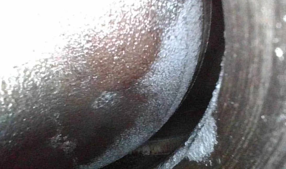

Well, I finally found out what the problem was... Here's a photo of the intake valve on cylinder 1 on the near side of the intake port. Looks like some blowby on that valve. Probably only happens sometimes and at low RPM. Looks like I'll be taking the heads off this weekend....
Update: Thanks everyone for your help; running like a dream now. Turns out the valve in that cylinder was just gunked up and didn't need a full rebuild, just some serious cleaning. Root cause was the coil pack.
