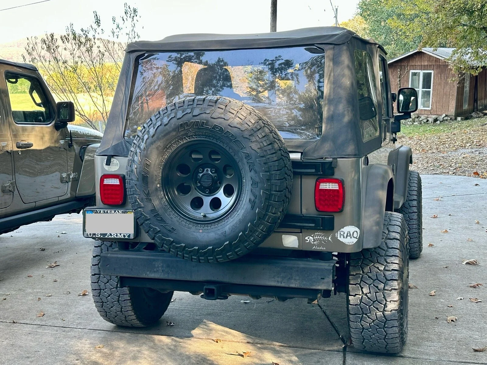

This is the poke you get with a 33x12.5x15 with 3.5 inch backspacing, no spacers.

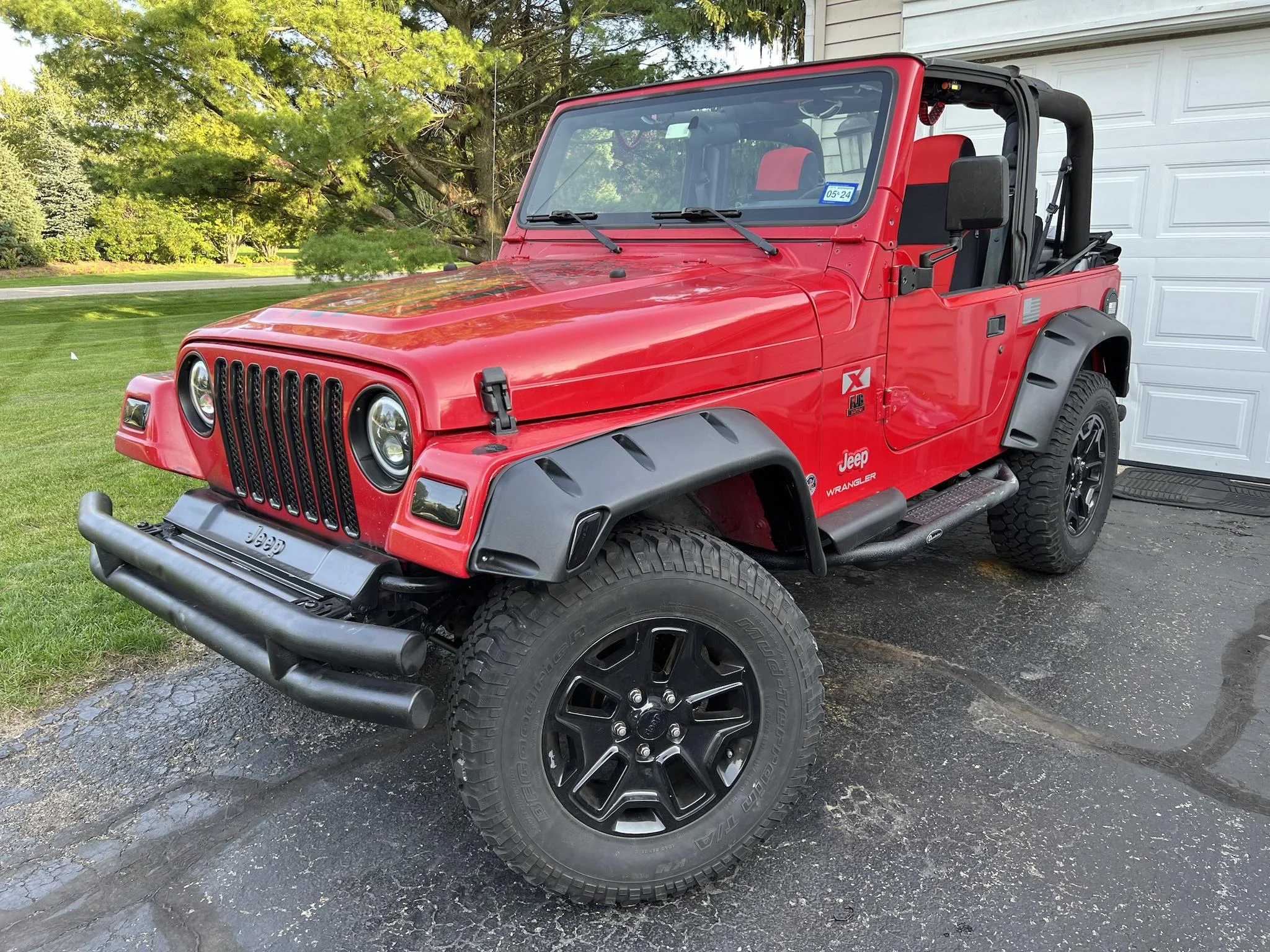

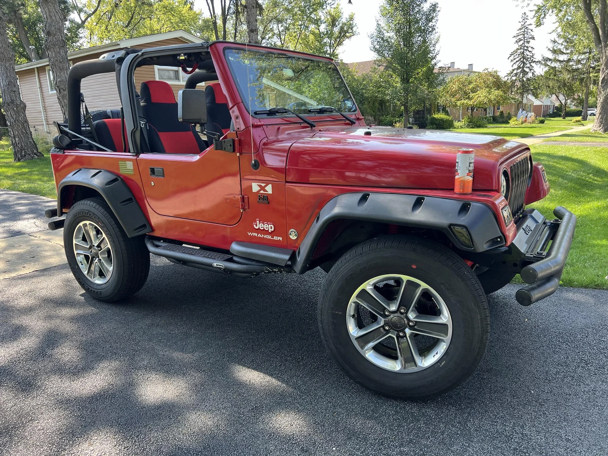

Im using 17” 2022 Sahara rims on mine with no issues
I have a 2.5” Rancho lift I just put on it also
Obviously the TJ has 4.5 lug pattern that isnt compatible with newer Jeeps, so Im using wheel spacers strictly to convert to the newer Jeep lug pattern
These are the JKU rims I just took off that I got from a buddy. I didnt like Mud terrain tires for street use
