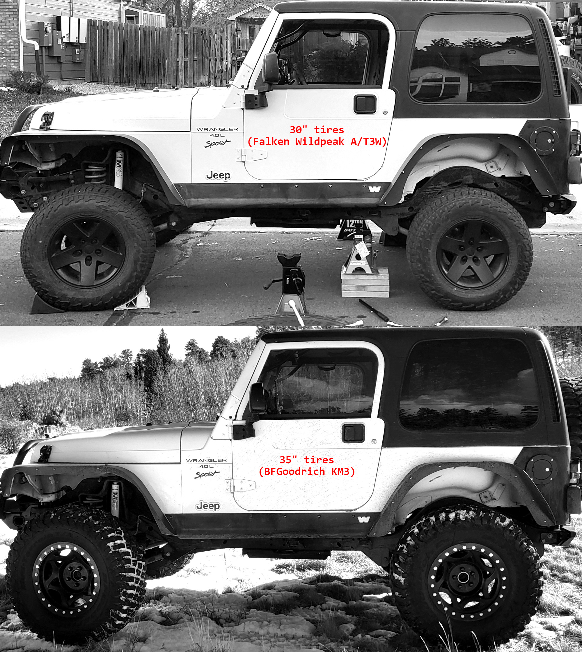

Here's what it looks like with 33s and 35s...
So, the 33s will be somewhere in between. If/when I get the 33" K03s on 16" wheels, I will switch back to the 35" KM3 on 17" wheels when the weather is warm again. I'll probably switch back and forth between the warm/KM3 and colder/KO2 weather tires until the KM3s are worn down or too old to use.
I think this makes the most sense for my situation, but I thought I would post something here in case there's something I'm not thinking about in stepping down from 35" tires to 33" tires on this vehicle. FWIW, the exact size of the 33s I'm looking at are 285/75R16 (32.8"). There's also a 295/75R16 (33.4").
