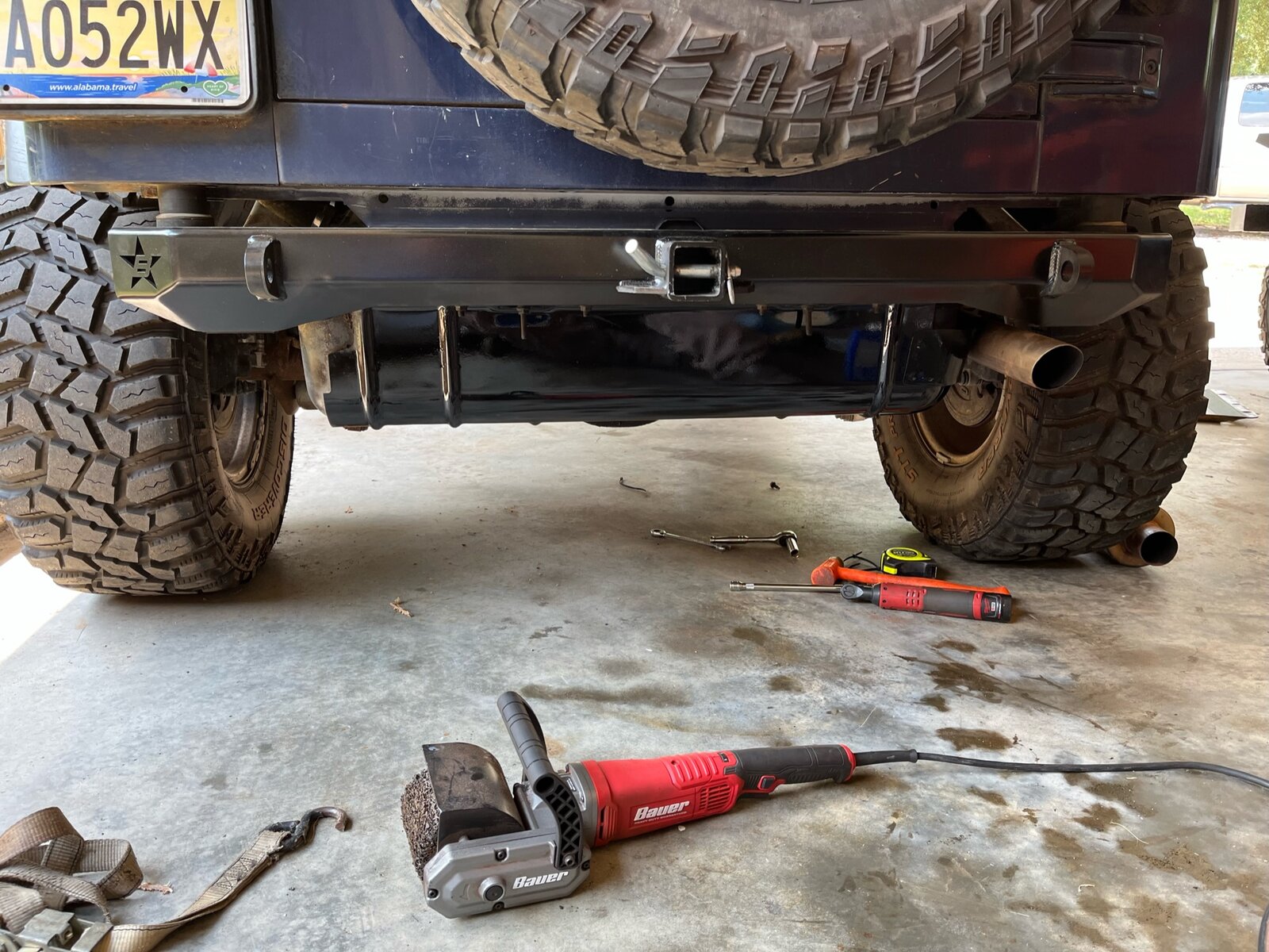

Will a bumper with a built in hitch work for you? I have a cargo trail that I pulled behind mine also and had a bumper with a hitch but you do have to be careful if you do get one that it has the clearance behind it to get the stinger in or modify one that is for your Jeep only.
I have an FRP tune in the ECU so that's ruled out. Its not throwing a CEL, but I haven't hooked up my scanner to read the O2 sensors, fuel trim, Etc. I suspect there is a small vacuum leak or something else minor.
A bumper with a built in hitch is my end goal but what I want is either too expensive or I have to build it (which I'm leaning toward right now). This Ruff Stuff bumper caught my eye recently though: https://www.ruffstuffspecialties.com/R2605-H.html .
This is the one I went with.
https://www.swagoffroad.com/collections/swag-jeep-tj-yj-rear-bumper

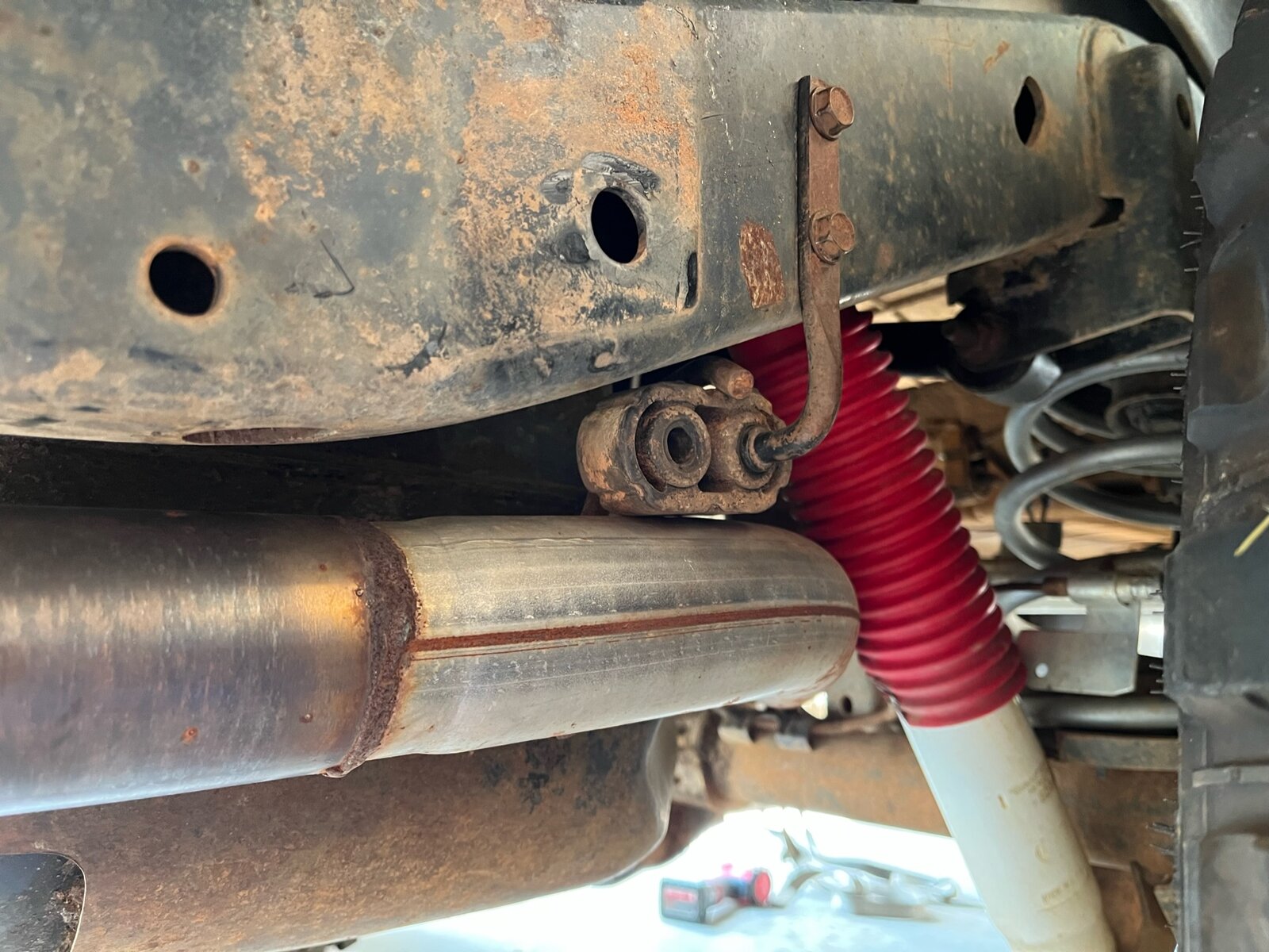

I took the week off between Christmas and New Years and got in a good weather day to work on the Jeep. The to-do list included installing the rear JKS track bar, angled relocation bracket and new lower control arms, all in an effort to correct the rear pinion angle. This project ended up taking most of a day and rendered a few lessons learned.
The first issue came with the shocks hitting the coil buckets due to the pinion being rotated so far up. Nothing a grinder and cutoff wheel can’t fix. (picture taken mid process).
The second issue came with the control arms. Core4x4 offers these in 0-6” and 6”+ lift increments and without much thought I ordered the 0-6” Tier 3 arms. Seemed logical. Except for the fact that the arms didn’t have enough adjustment to pull the lower mounts forward enough to roll the pinion like I needed. This doesn’t have anything to do with the arms – in fact I am very impressed with the fit, finish and quality of them. This has everything to do with me not measuring correctly before and after. To get the pinion somewhat close to correct, the track bar was trying (unsuccessfully, might I add) to coexist with the gas tank again. All of my issues revolved around the tummy tuck and relative lift height of the drivetrain, which will all be resolved when I swap in the 8.8 and can clock the bracketry as needed.
