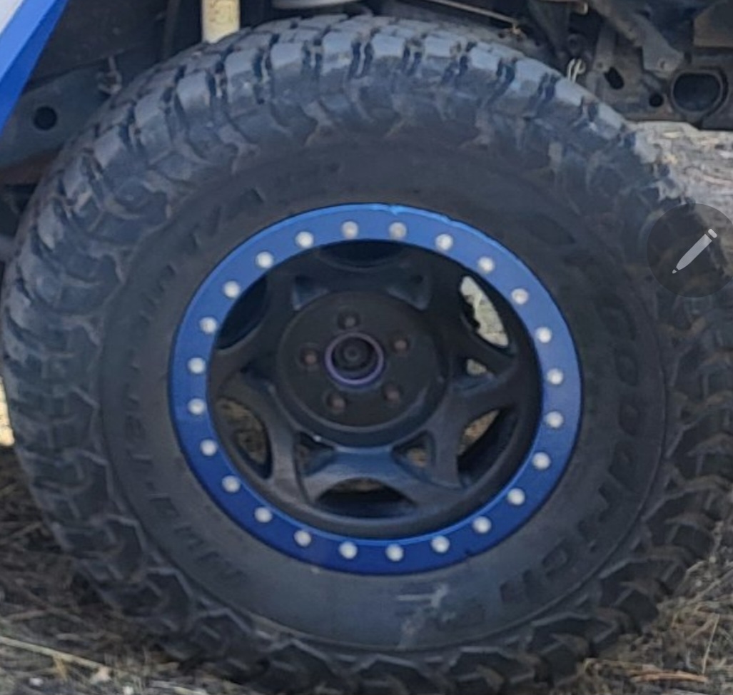

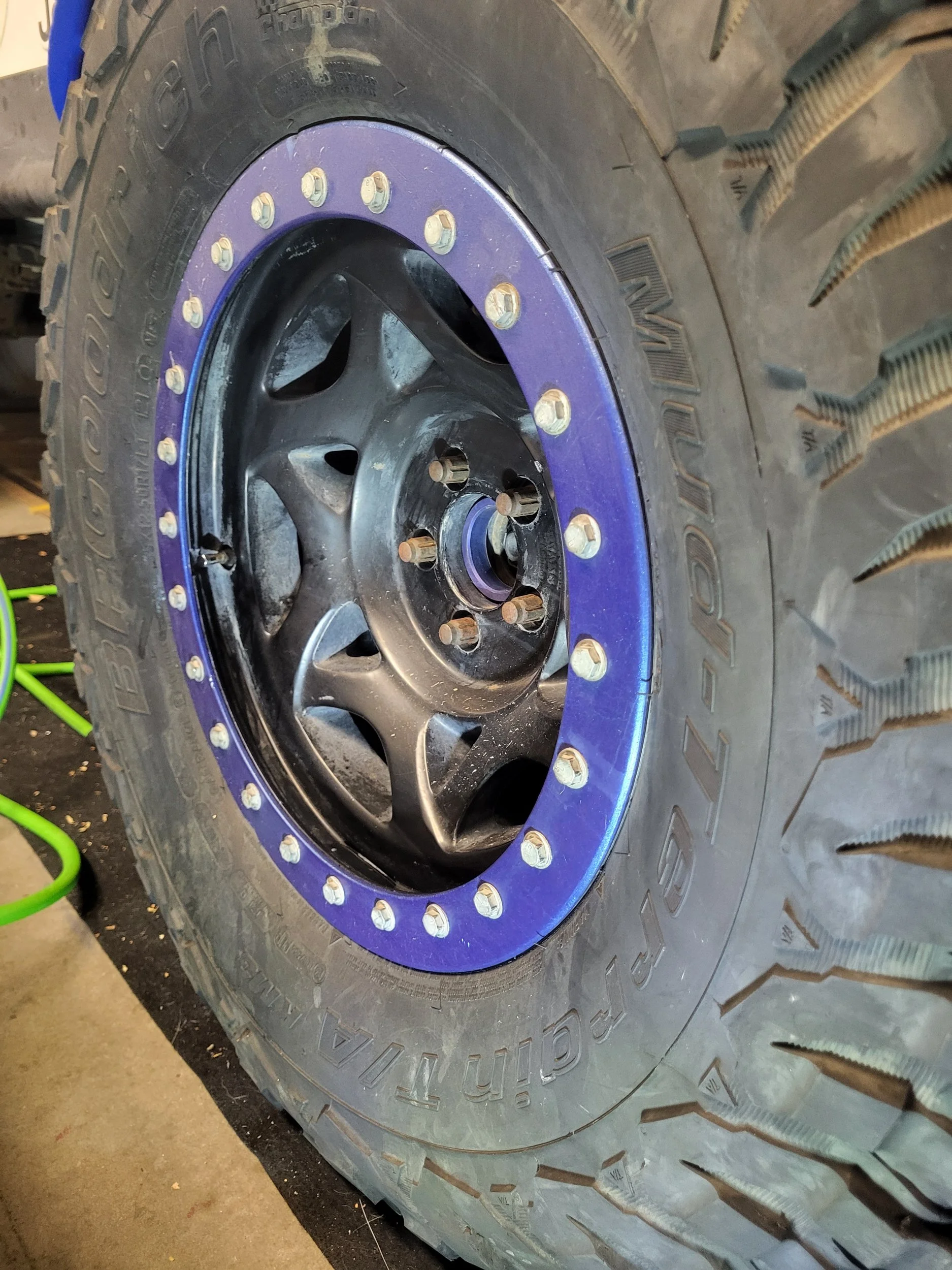

I'm trying to identify the aftermarket wheels that a previous owner put on my Jeep. I posted a couple pictures. If anyone knows what these are, I would appreciate your insight! My understanding is that these are some kind of beadlock wheels, but this is something I've never dealt with before (although I spent some time reading up on the subject at this point). I also read about "fake" beadlocks (for looks I guess), but I'm guessing nobody would put something this ugly on the vehicle for looks. Any chance these are fake beadlocks and I'm overthinking this?

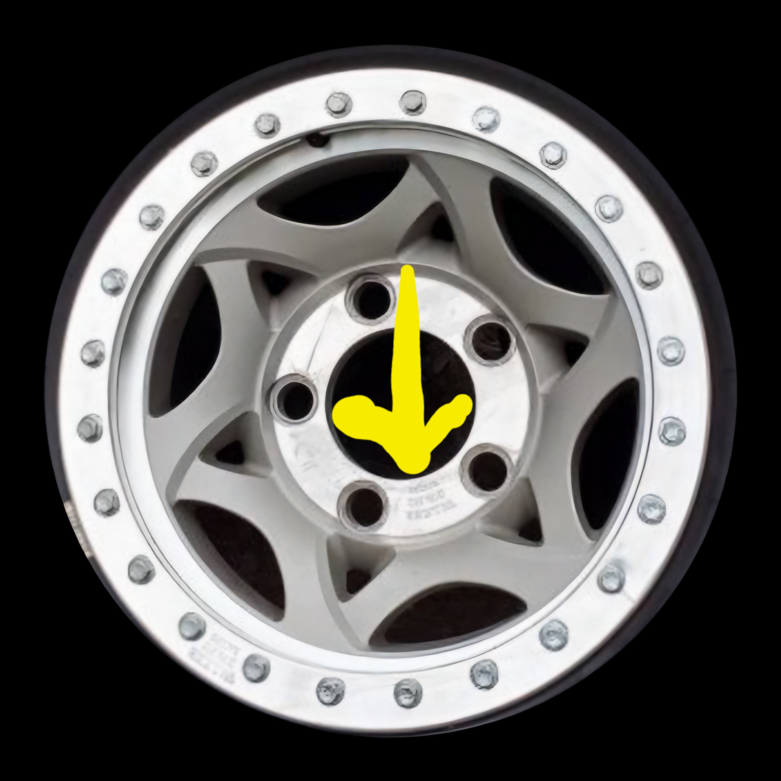

If they're the same ones you've posted in other threads, they look like Walker Evans Racing beadlocks (discontinued) or a knock-off:
it looks like the real deal had the name stamped on the wheel in between lug holes

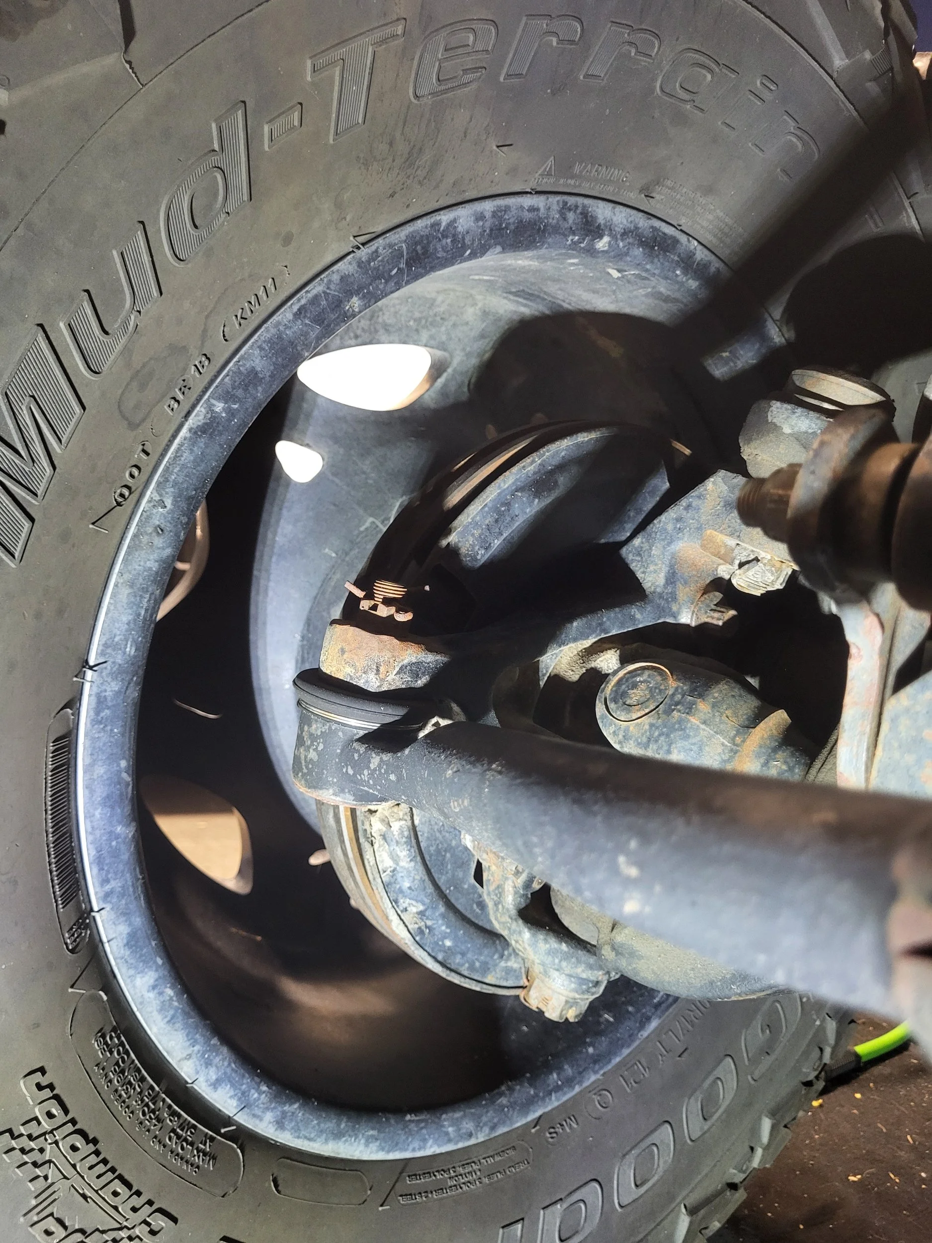

On a side note, one of the things I don't like about these wheels is that water pools up in them (no way to drain). So, I have to dry them with a rag after cleaning, rain, etc. It's garaged now, but the previous owner had it outside. Probably not a big deal but I had never dealt with this with other wheels before. I'm not sure if that's a beadlock design thing, or just something about these particular wheels.

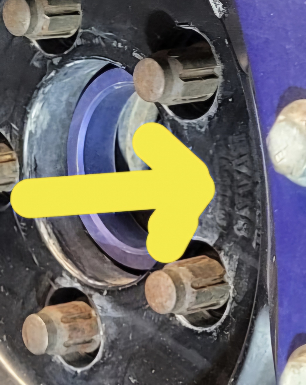

Looking even closer, there's also a Walker Evans stamp on the blue ring part, but you've got to catch it just right in the light to see it (I do anyway). Yes, I'm one of those dudes that sometimes can't find my sunglasses when they are on top of my hat! :) I'm going with the bad light theory on why I missed this (makes me feel a little better).
