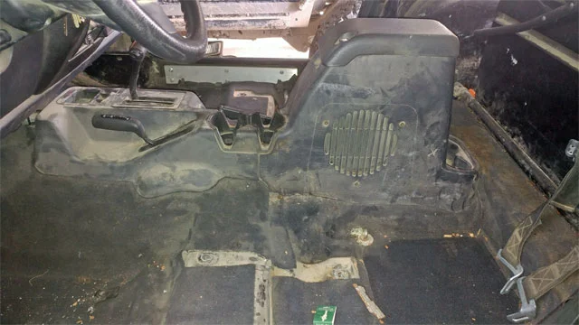

First things first. I have wider than normal PRC racing seats so they had to come out. Fortunately only four bolts hold them in. You may not need to take your factory seats out though it would make the process a little easier. My TJ was disgustingly filthy after getting the seats out which gave me reason to at least vacuum the dirt and rocks out.

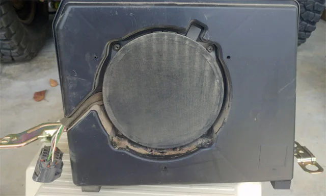

Reinstalling the subwoofer into the Tuffy console is just a bolt in, its wiring harness just plugs in. The subwoofer does take quite a bit of room inside the console which reduces how much the console opening can hold. It still provides nearly triple the space the factory console provides. The standard non-speaker Tuffy console's console storage is huge by comparison.

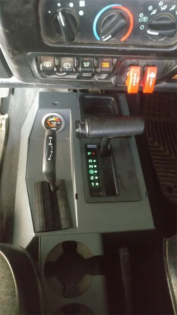

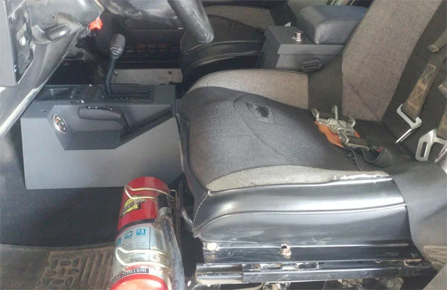

With a two more screws to bolt the front shifter console to the center console and bolt the shifter to the floor mounting bracket, the console is now in and ready for use. The shifter bezel just snaps into place and so does the forward coin holder or airbag control switch. Everything is a perfect fit.
As you can see here, I also added my B&M transmission temperature gauge to the console which only required drilling a 2 1/16” hole. There was plenty of room behind where I mounted the gauge for the wiring.

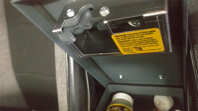

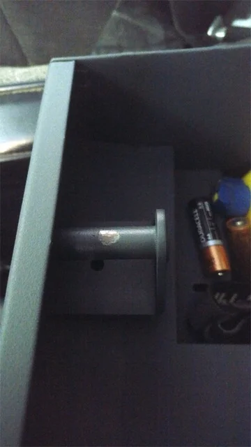

This is the top locking latch mechanism, it is very beefy. And when you close the console, it feels like a vault closing. No wiggle or flex, it closes with a solid clunk. The armrest padding is covered with a good heavy grade of marine vinyl.
Here’s the lower half of the latch.

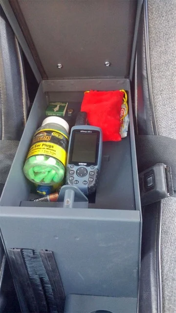

At last I can keep everything like my GPS, ear plugs, headlamp, flashlight, special tools, etc. It’s the GPS I was always worried about, it has all my trails stored in it.

FYI @Jerry and everyone else. I noticed in the picture there's AA batteries in the counsel and if those batteries touch each other it can short and start a fire. I work at Underwriters laboratories and when we don't use batteries we seal them in a small zip lock bag. You can also tape the ends of the batteries and be safe that way. When disposing batteries in the garbage at home or work, make sure the ends are taped or in a bag before tossing them in the trash.
Safety tip of the day, passing on this info will keep us safe from fires by doing this simple task.
